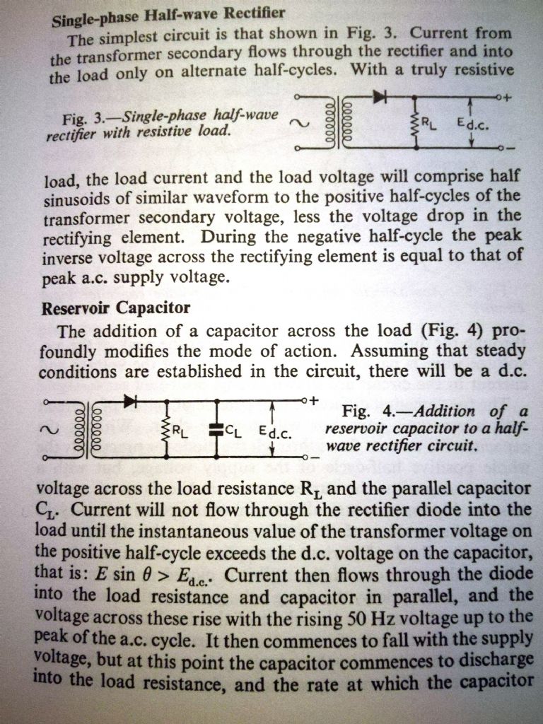

                      All the diode does is prevent the voltage dropping suddenly if the input voltage drops, by back-feeding. No rectification here. Ripple on the DC input, yes, but there ain’t two diodes – as required for a half-wave rectifier..

                          #599437
                          Nicholas Farr
                            @nicholasfarr14254
                            Posted by not done it yet on 26/05/2022 19:16:06:
                            Hi, well according to this, you only need one diode for a half wave rectifier and Gerry's diagram looks a lot like the bottom one.
                            Regards Nick.
