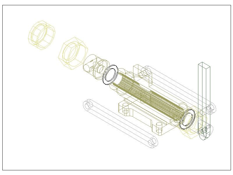

What is strange though, is that I had rendered the pump drawing, but translating it from its .tcw drawing-file to a .jpg , turned it into wireframe format, I have no idea why.
The pump is a real item, so far just the casting, but I intend it as a hand-pump for the steam-wagon. The end-fittings are standard plumbing union-nuts to hold a gland at one end and valve manifold at the other.
The bore wall shows one aspect of TurboCAD: its two, at least, internal ways to generate a "solid". Extruding a base circle creates a polygonal prism, hence the parallel lines. This is the trap. The different internal routines produce results with different reactions to the same editing tools, including shattering the entity into lots of individual, rectangular facets. Unfortunately you cannot determine this in advance; nor correct it.
