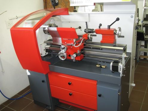

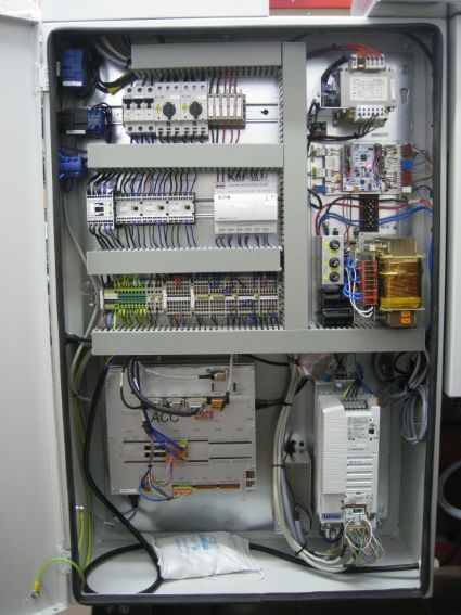

                    Some time has passed since I fitted my ELS to my EMCO V10P lathe, and so far I am very happy with how it all works, so much so that I have just finished fitting the same system to my new EMCO 14D Lathe ( well, nearly one year old now..)
                    Makes threading a real breeze! And gives a very nice autofeed with no gears…

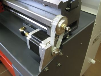

                    Spindle encoder added with drive belt:

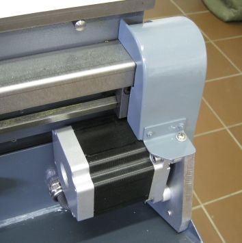

                    NEMA40 Stepper motor drive to Leadscrew
                    Stepper seen lower right
                    Stepper drive train cover
                    Lathe Control board seen from rear – Mid-Right is where I added the stepper drive PSU and the NUCLEO microprocessor module that does the ELS function
                    The white module seen upper is the Nucleo.

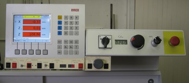

                    The ELS controls and panel are added just below the DRO and lathe stock controls.
                    Works nicely, so a happy chappy !

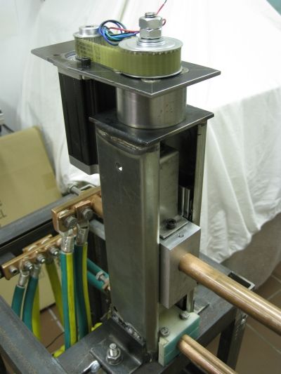

                      After doing the ELS on the 14D, I finally re-started on a project that began more than 15 years ago – A Spot Welder…
                      re-started as I finally need such a capability to make some simple galvanized sheet metal 'boxes' that are to be covers for the plastic box that house the electronics for our Wildlife Animal tracking logger, spread around in the Namib desert and scrub – the metal cover protects against the wild sandstorms and as it is spaced away from the plastic box beneath, provides some protection against the hot desert sun…Anyway…

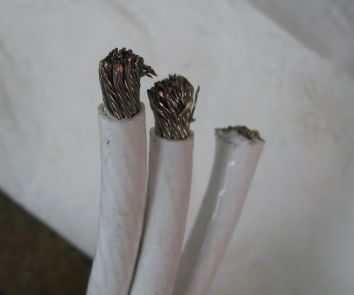

                      The first plan was to use an 800VA toroid that I had, wound with 3 x 5 turns of 8.5mm diameter copper wire – about 50mm square in total. This worked, gave 1800amps, but the secondary wire still got hot as hades after 10 x2second welds.
                      The three 8.5mm diameter cables

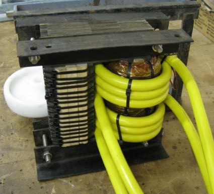

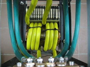

                      So scrapped that odea and found an old 150amp Buzz-Box Welder. Stripped the core down and re-assembled so that it was a plain C-Core shape, and then added my windings.
                      Primary tapped for 220V, 230V, 240V, wound with 3mm diameter Cu wire.
                      Secondary 2X4 turns of 95sq mm cable wired in parallel – 190sq mm in total…

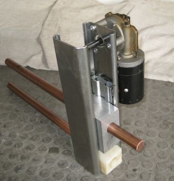

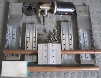

                      Then started on the vertical slide mechanism for the pincers – used a heavy duty drawer slide, cut to suit:
                      Feed arms are 22mm diameter solid Cu bar.

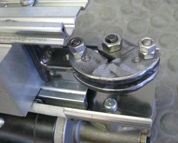

                      First concept was to use a wiper motor with an over-center toggle to drive the upper pincer up and down.
                      Over center toggle:
                      Was not happy with that idea – makes it difficult to change pincer stroke and pinch position..

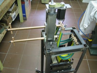

                      So moved to a Stepper drive with a M16X2mm leadscrew.
                      Here is the drive and head mounted on the welder frame.
                      View of the frame – High current sides wired up.
                      Transformer fitted and wired, with the 4 flexi-cables ( 280sq mm total) in place.
                      Next is to wire the mains input side, contactors, timer, and to make a pincer contact closure detector – will try to use a 5KHz signal fed onto the secondary – the inductance is very high, so the impedance should not drop the signal level much, but when the pincers make contact the signal should drop to zero – then I know to advance the stepper N turns to develop pinch point pressure, and start the weld…
                      More to follow..

                            " so much so that I have just finished fitting the same system to my new EMCO 14D Lathe ( well, nearly one year old now..) … After doing the ELS on the 14D, I finally re-started on a project that began more than 15 years ago – A Spot Welder…"surprisesurprisesurprisesurprise
                            Joe – apart from being totally mind-boggled by the output level of your efforts, can you please explain how you manage to get at least twice as many hours in your days as those allotted to mere mortals like me, please?? The effect of your posts is akin to that described by JS (won't refer to him as 'late', as he is still a major force in the forum!) when writing of ME visitors coming back from viewing Cherry Hill's models – a head-shaking, distant gaze of wonderment … at least that's how I react. Jason B et al have a similar effect and it produces both admiration by the bucketload … and depression, 'cos there's no way I would EVER reach a tenth of that competence!!sad Anyway, long may you experts continue to enthrall 'hackers and manglers' like me and a Merry Xmas to one and all!

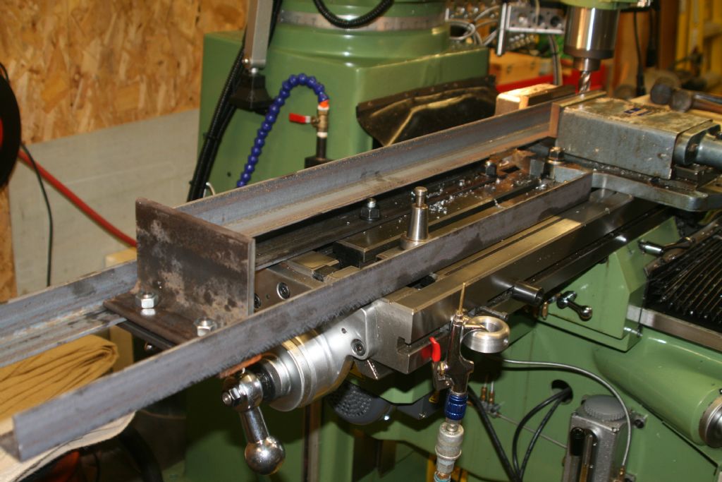

                                      Having seen many examples of stops for milling items to length, I do not recall seeing one for 'long bits', hence a little diversion to welding my new trolleys.
                                      Faced with the task of having to make 8 uprights the same size, this is what I came up with, (few others in album).

                                                Unbelievable superb work again Joe, but can I see just one photo of one of your machines "post job just finished" covered in swarf, oil, and cutting lube please…
                                                For us mere mortals…

                                                    What does the abbreviation ELS stand for?

                                                      Electronic Lead Screw. In combination with stepper motors on the leadscrew and the cross slide feed screw it allows you to cut threads and do simple turning tasks (taper turning, plain turning to a shoulder,…) automagically.
