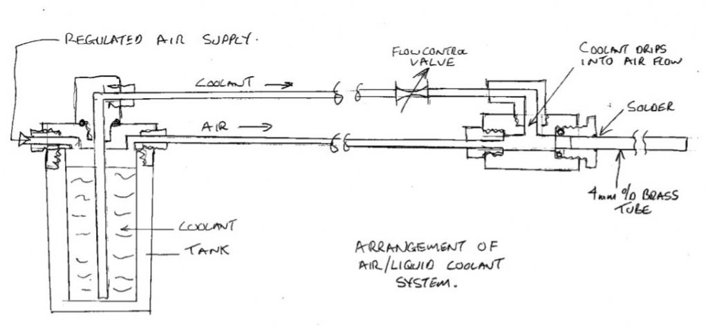

                Posted by Graeme W on 12/12/2017 17:03:19:
                Posted by tractionengine42 on 11/12/2017 12:10:13:
                Hi.
                Converted a cheap mist coolant system into a 'mist busting' pressurised system for my cnc mill.
                Nige, I've been experimenting with a similar setup, what are the dimensions of the nozzle you are using and how have you arranged the mixing of air/coolant?
                Hi Graeme W
                There is no mixing nozzle as such, the coolant simply drips into the air flow. The original block that came with the mist coolant effectively becomes a tee block, it's not necessary to start with a mist coolant.(I bought the mist coolant because it had the regulating valve at a very economical cost, but in the end that valve was ineffective).
                All the tubing is all 4 mm o/d, the outlet nozzle is 4 mm o/d brass tube.
                I have attached a rough schematic below. I considered a few much more elaborate arrangements, this very simple arrangement is working very much to my satisfaction, I wanted to have a very low coolant consumption, just enough to lubricate the cutter.
                Hope this helps and good luck with your set up.
                Nige
                Edit – The coolant exits the brass tube nozzle in droplets with no misting.
                Edited By tractionengine42 on 13/12/2017 10:55:21

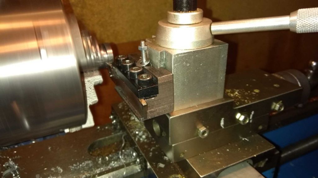

                                  #331983
                                  Iain Downs
                                    @iaindowns78295
                                    I recently made a toolholder for a QCTP on my CMD 10 (which is a VERY small mill – 150 Watts)
                                    That probably took under an hour and no particular vibration.
                                    It's worth checking that the gibs are tightened up (my Z axis was not for a while – you need to rock it hard to and fro as it's heavy) and lock the axes you are not moving.
                                    This with (I think) a 10mm Carbite end mill for the roughing out and an HSS dovetail for the dovetail.
                                    Iain
