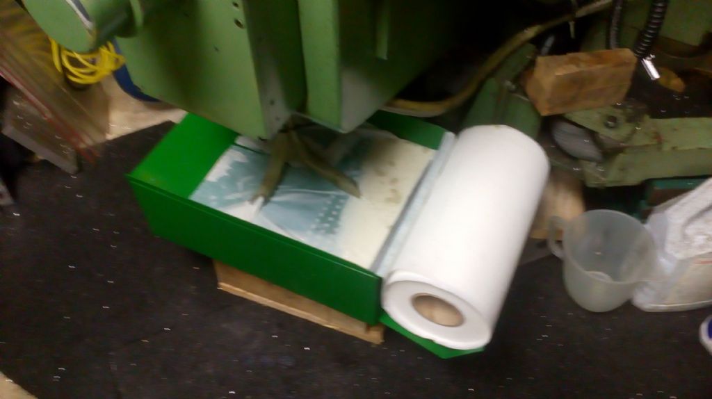

                        I do a bit of work for a company that has a few Vapour blasters, these things use a paper roll filter system to remove all the crap from the water, it quite a neat system, so it got me thinking if it would work on my mill, in part because I hate cleaning out the suds tank in the foot of my the mill, to get to the tank I have to climb over it and wriggle my way into the back of the thing, So I knocked one up from 1.6mm sheet I omitted the wears for simplification, and rely on the filter paper roll to do its job, so basically the coolant runs into the tank down a ramp full of 8mm holes and through the paper it then out into the main tank, I ran it for a about 20 mins on full flood to test it on the old coolant which looked ok to be honest, I am amazed how much crap it has removed from the coolant it appears it is removing the tramp oil as well, all I need to do now is make a couple of feet for it.
                        Pic below and a couple more in my misc album.

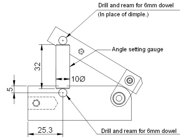

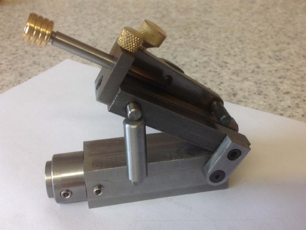

                          I finally got around to making the four-facet drill grinding jig to go on the Worden T & C grinder I completed recently. Converting the drawings to all-metric took a while, but I admit I've been slacking in the workshop a bit, too. Couldn't leave this design alone, either, so I incorporated what I hope is going to be an "improvement". The original design calls for the drill slide to be tilted to 31° to achieve the desired point angle. The suggested method is to use a protractor or angle plates. I decided to incorporate a sort of sine bar within the design, so that setting the angle would be a one-step operation. By determining the positions of the dowels using the CAD program, I made a silver steel rod of the required length to obtain the angle, exactly. A picture (or two) is/are worth a thousand words ………
                          31? setting gauge        4-facet drill grinding jig
                          I think tomorrow might be spent sharpening a few drills!

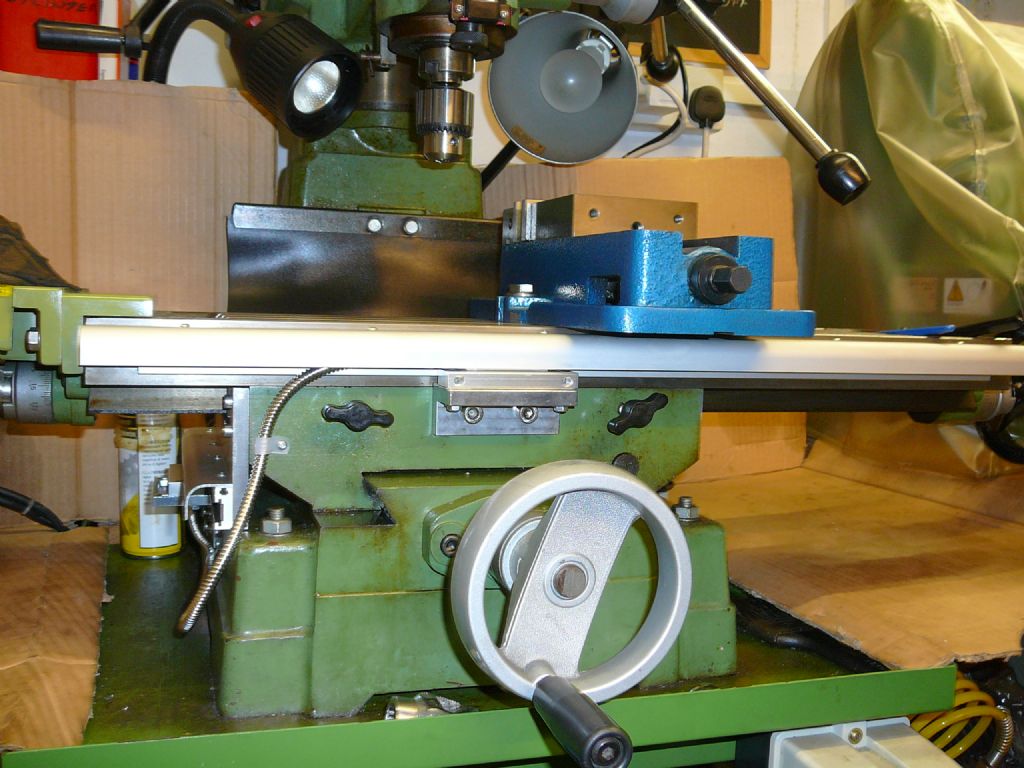

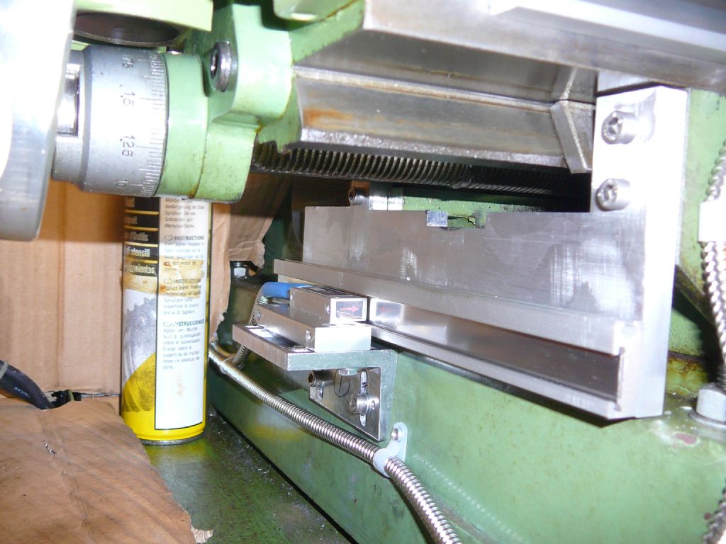

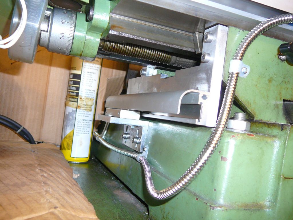

                                              Finally got around to fitting the DRO to my mill/drill after it'd been sat in the garage for ages!
                                              It's not the best bit of work compared to most but it works and I'm more than happy with it smiley
