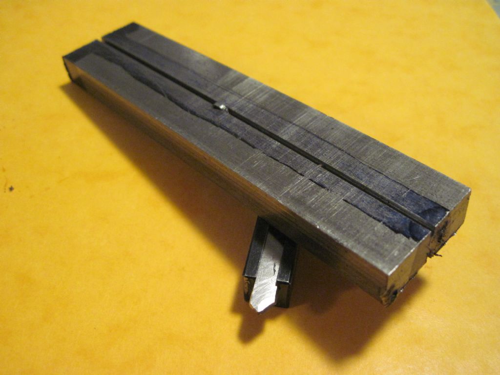

      I needed some 1/2" x 3/8" material – and only had 1" x 3/8" – no problem – "I'll slit the material in my Acorn shaper" (I thought)
      I had a small 1.5mm x 5.5mm parting blade (from the EW) and decided a slit either side of the work (about 4mm deep) would give me a good start – finishing the cut with a hacksaw (didn't fancy going right through – with the work closing in on the blade). Thinned the blade a bit to give more upper side clearance (seemed a good idea at the time) and the first side/cut went well. Turned it over and probably put a bit more cut on than intended – or maybe the blade blunted or got hot. Anyway – a sharp "ping" and the blade end is firmly stuck in the work – the Acorn never noticed, never hesitated….which is why I never put my fingers near that ram or stand in front of it…
      The blade will get re-formed/sharpened and the work will be hacksawed from both ends to get the HSS embedded in it out. So fortunately no real harm done – just a reminder to be careful around shapers…

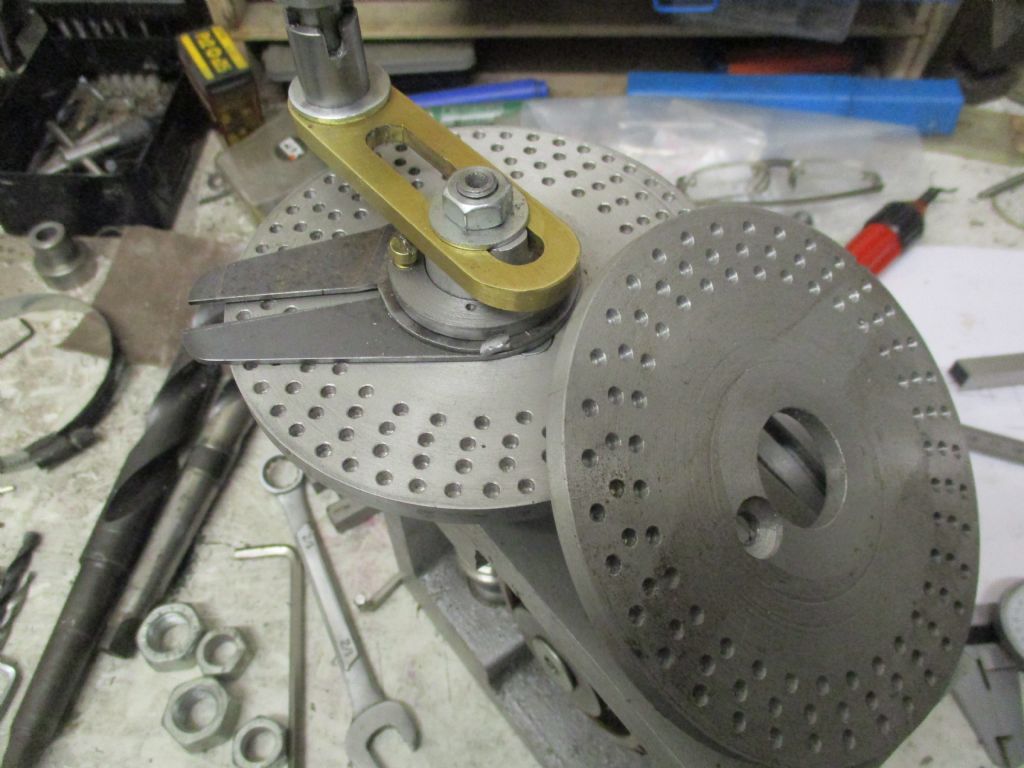

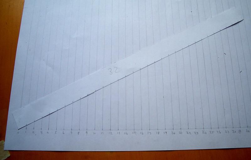

          img_0436.jpgI have read the posts on dividing plates with interest.
          I built a rotary table/dividing head (**LINK**) and found that making the dividing plates was easy. I wrapped a strip of paper around my chuck and cut it to the exact circumference. Using the skills that I learned in my technical drawing classes 55 years ago I divided the strip into the number of divisions that I required and used that to space the holes. It was a little tedious but also buttock clenching as I didn't want to have to do it twice. Here are a couple of pics to show what I did.

            Very clever, Norman. Most times, the simplest solution is the best! I shall remember that this afternoon as I am cranking handles, counting holes and reading off thousandths of a degree on the micro attachment, I'm sure!

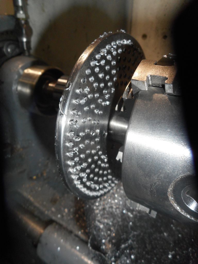

                          Got another circle of holes finished on the fabricated Versatile Dividing Head, that's the first plate done. 280-something holes. 500 or so to go.
                          And, sigh, 280 holes to deburr now, both sides.
                          Hopper Lathe etc
                          **LINK**
                          I ended up getting a very sore arm from winding the leadscrew handle to drill each hole (Chronic Fatigue Syndrome kicking in), and could not use the carriage hand wheel as the Drummond's is direct geared and so you don't get enough force on the job to push the job along. I need to fit Geoff Walker's gear reduction mod. In the meantime, I set up my Duplex-style fine feed reduction pulleys so I could push the job onto the drill bit with the power feed.
                          **LINK**
                          and then set up the Drummond's leadscrew dog clutch to automatically disengage when the carriage hits the stop on the bar, stopping the job from over running and hitting the chuck, always good!
                          **LINK**
                          Much easier now. I can sit on my stool and operate the dog clutch handle, carriage handwheel for the rewind and the dividing head all within easy comfortable reach.

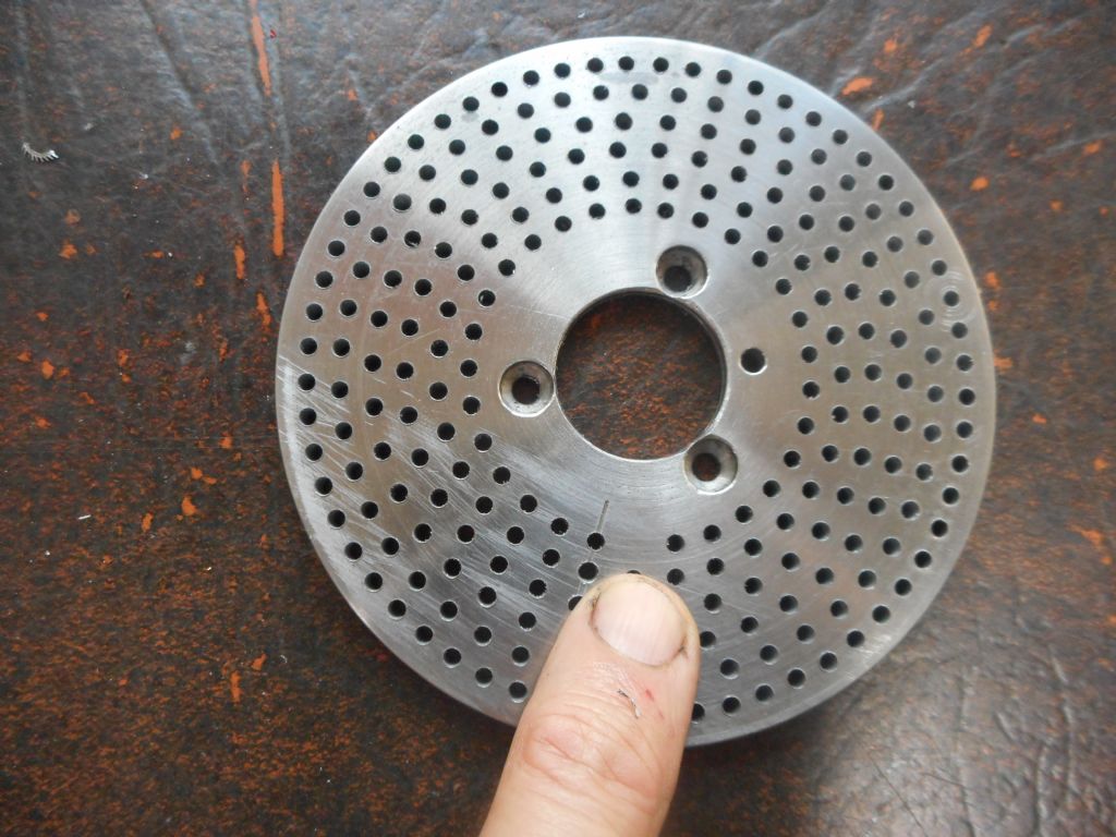

                          But what's this??
                          I skipped a hole, the last hole in the first row I did. I was so excited bout winding on the last increment so see the drill drop perfectly into the first hole, proving I had the indexing right all the way round, that I totally forgot to actualy drill the hole in the middle of it all. No worries. The lathe was still set up so put the job back in, indexed off the adjacent hole and all good! Now on to the deburring and stamping the numbers on before I forget which disk is what.
