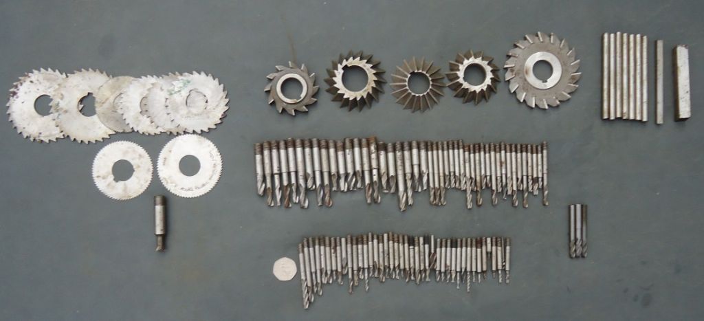

        Next buy was a job lot of milling cutters, slitting saws etc. etc. some of which were stained but eminently serviceable. Some used and some new. In amongst this lot were seven lengths of 6mm dia. M42 tool steel – new one on me but "googled" it sounds pukkah. £7 for this lot.
        milling cutters

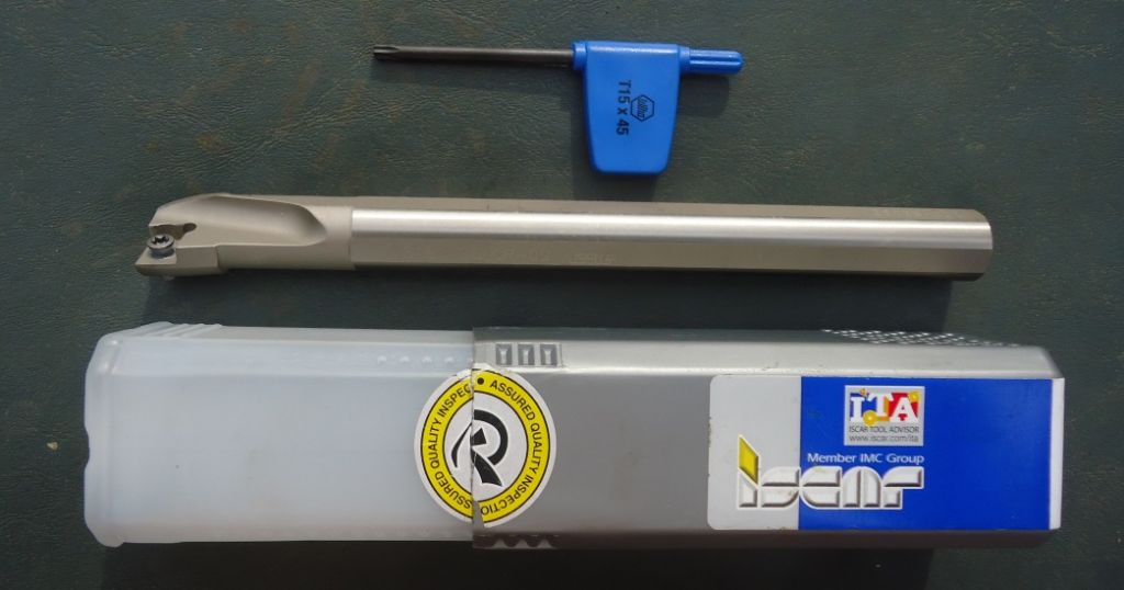

        For me though the star of the show was a very sexy brand new 16mm Iscar S16Q SCLCR-09 indexable boring bar – I was moderately ashamed at handing him the twenty pence asking price as I expect you would have been to.

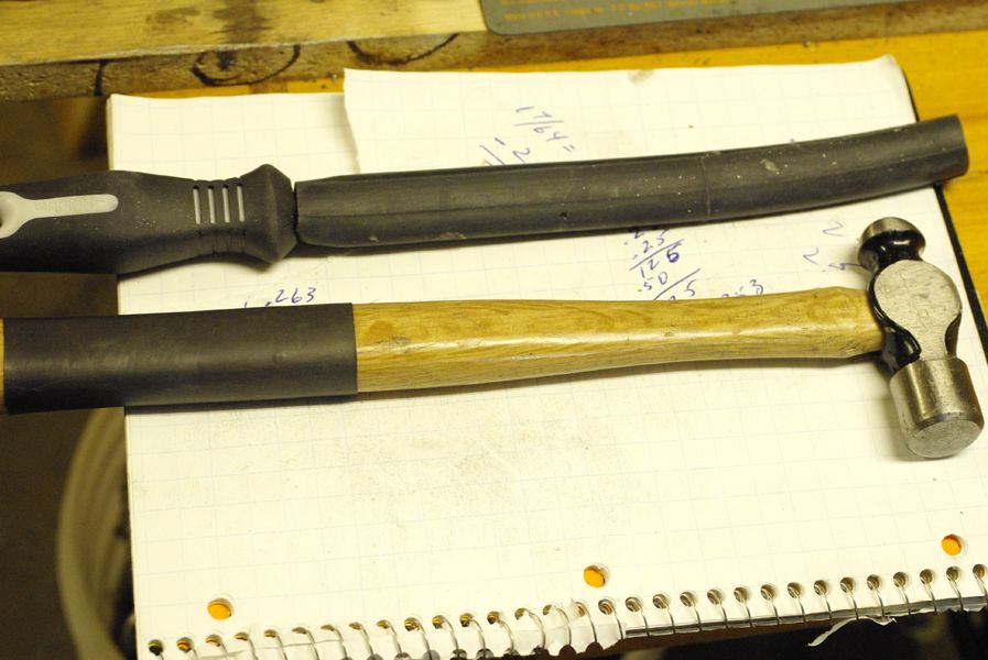

                                  1. Are my eyes deceiving me or is the column for that drill press solid rather than tubular steel? Judging by the photos, it is a rugged and well constructed piece of kit. My drill press has a tube column that has noticeable flex. I had to build a jack that sits under the outer edge of the table to eliminate the flex.
                                  2. Just a suggestion: A piece of heat shrink on the handle of the planishing hammer would make it feel even better in your hand. That's a piece of inner tube protecting the file.
                                  Bill
                                    Bill, your eyes do not deceive, it is solid. And very bloody heavy.That is just the column, everything else is just as massively built. I am fabricating a steel framework to sit under the bench to support the Drill as they weigh around 125 kilos when assembled. It is very definitely a two man lift.
                                    I will look into the innertube thing as it looks interesting. I am going to get some 45mm ID poly pipe (if they make such a thing) as I have had an idea with regard to a Hammer Storage rack.

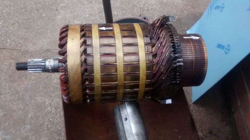

                                      But then spent 10 minutes contemplating if this would fit.
                                      The big one that is, according to my ruler should have 5mm to spare but it looks too big to me.
                                      Oh well, find out tomorrow.
                                      BTW the small armature is a lesson why you should not run motors with low batteries. This is off a fork truck, main drive motor. It's been run with low batteries which drops the volts but still leaves a high amperage and no cooling.
                                      Result is it's let go on some of the hight temp soldered joints and thrown the windings. So a full rewind job and it's on strip, not wire so these have to be formed specially. It's also down on both bearing diameters, my job.
                                      But that quick I'll just load two pallets before it goes on charge will cost them the best end of £1200 by the time the rewinders have finished with the motor.

                                                Well it looked heavy to start with.
                                                Then it looked a bit close.
                                                But in the end, loads of room although it didn't like 1,000 rpm and had to back it off to 750.
                                                Shaft now turned undersize, just got to splat some weld on in the morning and turn back to 3 1/4" diameter. This one is an old motor and still on imperial double roller bearings. £180 a pop at trade prices. No wonder metric is so common.

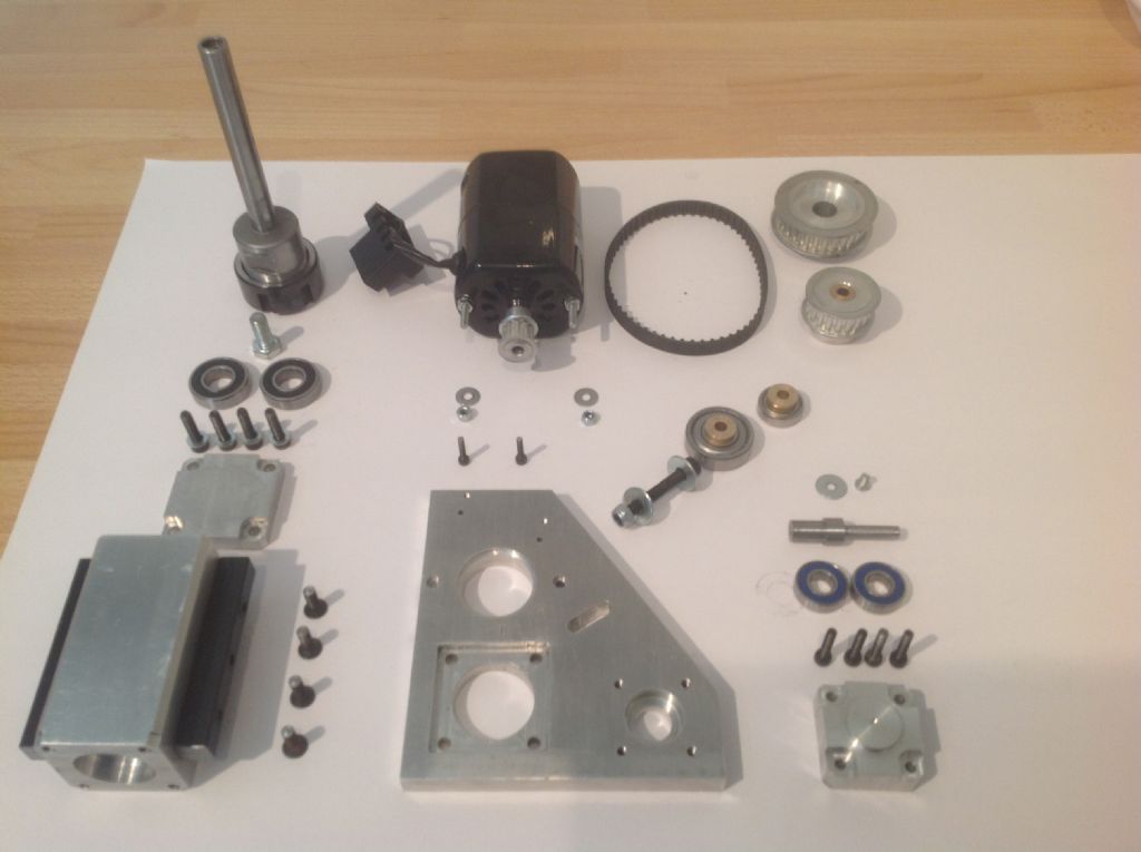

                                                      Finally, I got my toolpost-mounted spindle finished! A few hiccups and errors on the way, but nothing a good soak in the bath with my thinking cap on couldn't solve. Here's a picture of the parts all neatly laid out for checking, prior to a trial assmbly. The motor is a generic sewing machine 180W job from the far east. Came complete with leads and speed control, too. According to the label, it revs to 10,000rpm! The two smaller pulleys are interchangeable to give a range of speed and/or torque, as required for a particular application. The jockey bearing is used to tension the belt and give extra "wrap-around" to the driver and idler pulleys. I have bearings of two different sizes for this, as seen below, to accommodate a slightly smaller belt (110XL) as well as that shown (120XL)
                                                      Finished parts

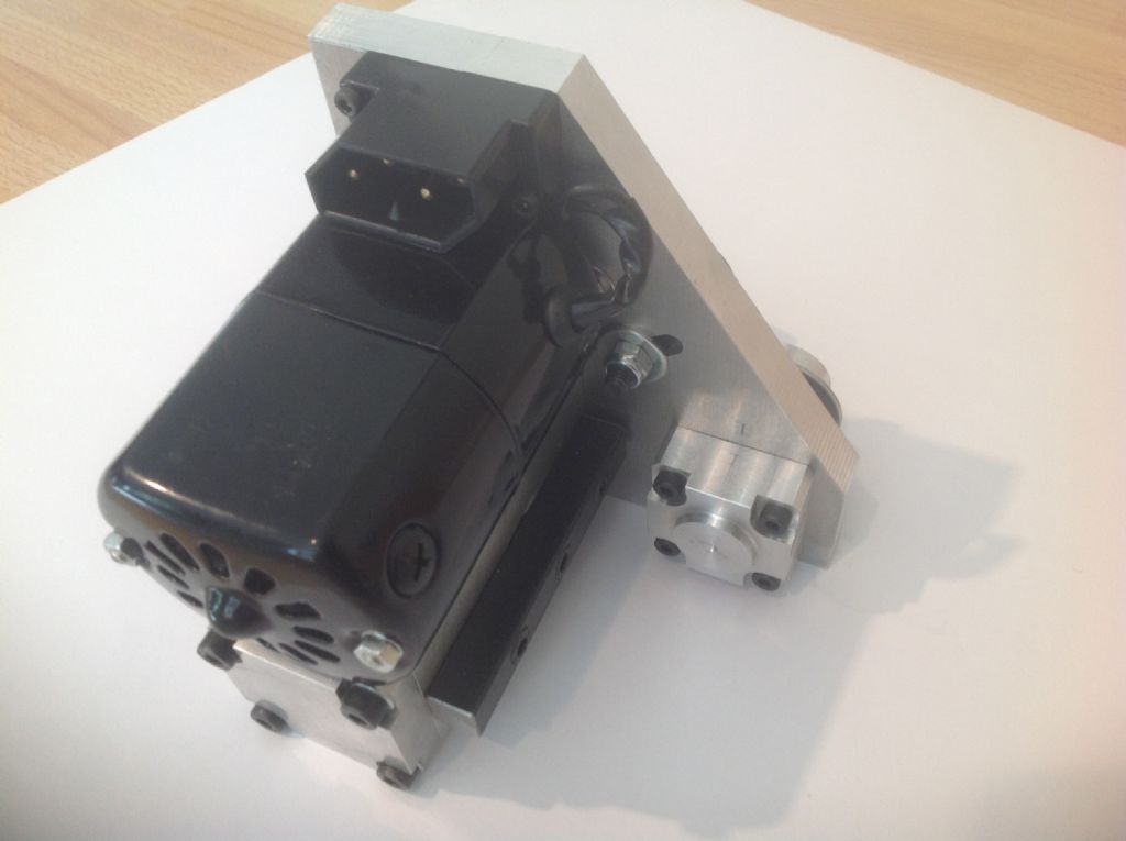

                                                      And another of the completed unit.
                                                      Assembled toolpost spindle.
                                                      From the rear ……….
                                                      Rear view
