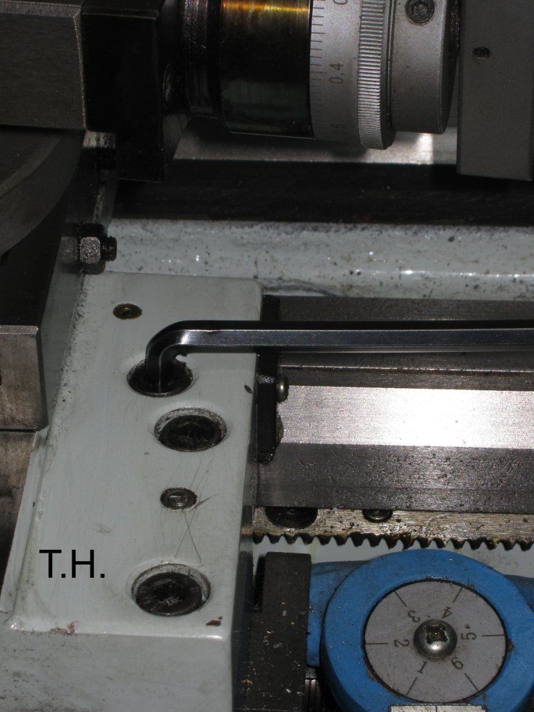

                  #268485
                  Thor 🇳🇴
                    @thor
                    Hi Bill,
                    The three screws you talk about sound familar to me. I have taken a photo of the right hand side with the carriage lock on my lathe, with the Allen key I use when clamping:
                    Have you tried that Allen screw on yours?
                    Thor

                    #268487
                      I think the Warco one has the DRO on teh side of teh carrage so in their wisdom the factory removed the lock so people would not moan that they could not get to it. The last 290 I looked at on a Warco stand did not have the locking cap head.
                      #268493
                      Thor 🇳🇴
                        @thor
                        Thanks for clearing that up Jason, my 290 is a few years old and doesn't have a DRO.
                        Thor

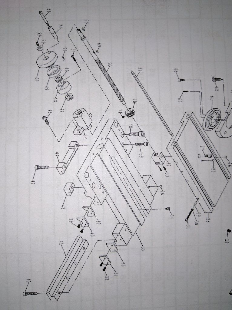

                                  #268655
                                  Dan Carter
                                    @dancarter89683
                                    Bill,
                                    Would have been more use before, but wasn't at home. This is my lathe:
                                    The brass lever has a stub of allen wrench in it, so fits in the socket screw but goes under the dro to avoid the awkward positioning. The relevant page of my manual:
                                    Shows the lock as component 43. I am sure I have seen a thread on this forum where someone removed it and took a bit off the top surface to make it work properly. Not sure whether this is possible without removing the apron which would be painful.

                                    #268764
                                    mechman48
                                      @mechman48
                                      ….Shows the lock as component 43. I am sure I have seen a thread on this forum where someone removed it and took a bit off the top surface to make it work properly. Not sure whether this is possible without removing the apron which would be painful.
                                      ​I wrote a post on this some time ago for my WM250 V-F so it may have been that you saw… see link
                                      http://www.model-engineer.co.uk/forums/postings.asp?th=98702

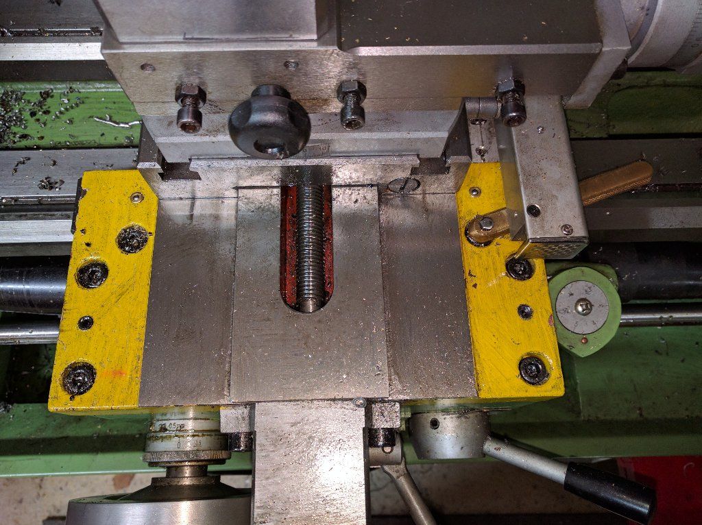

                                      #268853
                                      mechman48
                                        @mechman48
                                        My saddle lock …
                                        After some judicious filing… the gap between the saddle top & locking pad can be seen … it locks up quite solidly now…
                                        George.
                                        Edited By mechman48 on 28/11/2016 19:20:48
