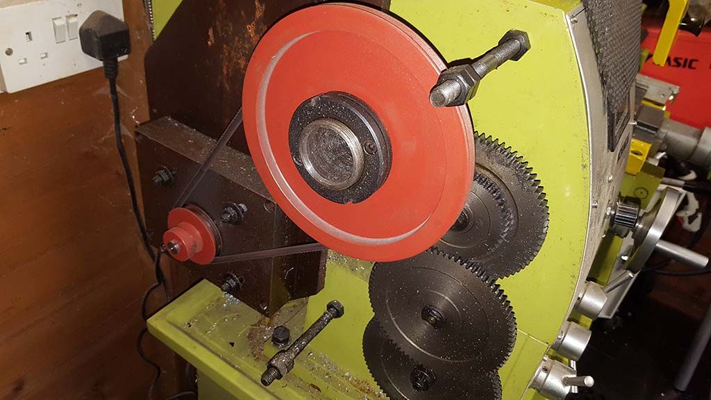

      I have noticed my lathe sometimes makes a strange noise.
      Sounds like a bearing but I don't think its the main chuck bearing
      I am also going to send this to Warco to see if they have an idea what it could be

          Can you post a photo of the left side of the head with the cover off as it would help to know the belt arrangement on the 290.
          I would suggest first swinging the banjo so that the gear is not engaged with the spindle and seeing if that makes a difference, and to eliminate the feed/screwcutting gear train.
          If that does not work try taking the belt of the motor and running just the motor if that is noisy it could be the fan or swarf catching.
          If there are two belt options or an intermediate gear try with/without that.

            Will do, if its any help the noise sounds like it coming from the rear, under the stop/start buttons.
            Will get some photos.

              Here you go Jason

                    Same layout as my 280 from your pic so do the things I suggested to eliminate the banjo gears and then the spindle
                    #376078
                    petro1head
                      @petro1head
                      Update, I have dismantled and cleaned the banjo gears, re-assembles using the paper method and applies a small amount of grease.
                      Much better.
                      I suspect the main noise was due to actually doing the vid the other way and the gear was not properly aligned with the chuck shaft

                        Horrible noise from my wm280v ( inverter drive version ) turned out to be the cooling fan rubbing .
                        Thin plastic spacers between the change gears helped a lot too Brian C

                                      You also need to watch the washers that are supplied to go between banjo and gear pairs as they are different thicknesses which is intended to space the gears so they don't rub.

                                            Gear backlash is important. Too little and there will be noise, and wear. (Probably similar to a loud whirr, or a grinding sound)
                                            Too much and the gears will rattle, especially on an interrupted cut.
                                            Using a piece of paper in each mesh to set the backlash should give 0.002- 0.003" backlash, which should keep things reasonably quiet. Heavy lubricant, such as chain lubricant or grease ought to quieten things even more.
