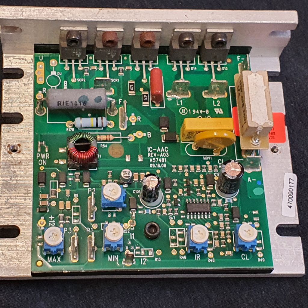

                    When my lathe (WM250) developed very similar symptoms I found that a resistor on the control board was not seated correctly. Once pressed in all back to normal.
                    Picture in album (of course may be different control board!)

                      Thanks Steve, it looks like the same board. I pushed in that resistor yesterday to make sure of that, it was another thing I found on the web. I think I need to remove the board completely and look for dry joints etc.

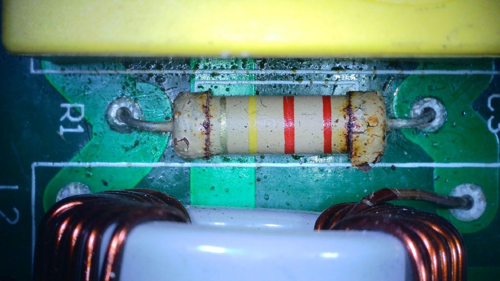

                            Had another look at this today. Found a corroded resistor on the power board, it's a 220KΩ and reads constant when tested with an ohm-meter, actually 223KΩ. I suppose it might be different when powered on and I will change it anyway. Below are some photos, of the power board and speed controller board?
                            All solder joints appear to be sound. I have yet to test the speed potentiometer and start cleaning socketed and plug-in components.

                              I don't think the 220k resistor is the cause – it appears to be part of the mains filter circuit, which would carry on working even if it was removed. I'd leave it alone.
                              It and the two rusty Allen head bolts on the heat-sink suggest condensation, but it could have happened in factory storage, as the rest of the it looks clean. Is condensation a problem in your workshop? It plays merry hell with electronics, causing all manner of weird faults. Rusty heat sink bolts might cause trouble if SCR1 and D15 where insulated from the heat-sink with a mica washer but they seem to be bolted straight to ground (normal).
                              Diagnosing fault electronics gets up my nose even though I have the gear. I'd replace the board if I couldn't quickly trace this to the pot, it's connections, or something obviously amiss on the board. Others have more patience!

                                Dave, yes condensation has been bad in my shed over the years. I now have 2 tubular heaters behind my lathe and mill. It's strange that it might have caused just two of the screws to rust? The nuts holding the power board to the casing are also corroded but not the screws, unless they are stainless of course.

                                John Doe 2
                                  @johndoe2
                                  Does C101 have a bulging end? Hard to tell. I might also very carefully mark, then gently exercise those five blue pots; "Min Max" etc. It is possible that one of them has a dodgy contact with its track – especially if they might have been damp over time.
                                  Put pairs of dots somewhere on each moving white part and the body with a permanent marker as a reference to get them exactly back to where they were. Probably not too critical.

                                        C101 is ok, I can see what you mean though it does look bulged, just the way the light is catching the markings in the cap.
                                        I will check the preset pots. I just received some electrical contact cleaner, ok for pot wipers too although the presets do seem to be very well sealed. All maintenance will be performed on a dead board.

                                          Picking up on John Doe's comment about dry joints, have a good look at the soldering and PCB tracks with a strong magnifying glass, both sides of the board.
                                          Dry joints have a characteristic grey crystalline look rather than being shiny metallic. I've never seen one on an SMD board – the tiny components – but they seem more likely on wired components that go through the board like the big resistors, capacitors, connectors, etc.
                                          Broken tracks are harder to spot – sometimes they develop a hairline crack that opens and closes randomly as the board heats up or is vibrated by the motor.
                                          Both fixed by a dab of fresh solder. The track will have to cleaned back to copper first, which is a delicate operation requiring a steady hand and a scalpel. May be easier to trace the track back to something easier to solder to and bridge the whole section with a wire. Depends on the board – modern ones are often tightly packed with tracks running within a fraction of a millimetre of each other, not meant to be repairable.
