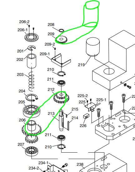

                        Thanks for the help guys,  I have to admit to going through these loops a few times. The picture I provided above in the thread shows the construction and issue of the particular version on the mill I have.
                        It shows the top of the mill head with the quill assy locked in the lowest position and shows that there is 2 to 3 mm of spindle sleeve available above the bearing. It also shows the removed top bushing (used presumably to protect the splines of the quill and also carry the slotted speed plate).
                        The bush normally  sits on top of the spindle sleeve. The bush has a 1.5-2mm counterbore in the base and is held in place by friction alone, as a light press fit on top of the spindle sleeve. It is not screwed into place or retained by screws. The fasteners seen on the top of the bush are purely to retain the speed plate. after a light tap with a wood drift, I was able to twist this top bush off by hand. For the natural operation of the mill, this lightweight fit is adequate as the bush normally carries no load.
                        The belt conversions I am aware of all attach in some way to spindle sleeve (either securely or insecurely). I had a long exchange of e-mails and photos  with the guy in Turkey. He was indeed very helpful and when I queried the diameter of the pulleys to fit the bush, he asked me to check what was under the bushing. When He saw the photos, he was quite straightforward in stating  that his design would not be suitable because there was nothing of substance on the quill sleeve to attach either the bush or a pulley to. According to him, he was aware of this issue, but most of the units he has seen either have a longer sleeve extensions or have tapped holes in the sleeve itself (ie not only  the bush).
                        Had the spindle sleeve extended 10mm above the bearing instead of 3mm (or even extended 5 or 6mm, or had some threaded holes) it would be possible to secure the bushing (or a pulley or anything else) reliably to the spindle sleeve either by fasteners using the threaded holes or by by grub screws around the bush/pulley circumference locating in divots in the spindle sleeve. I had even considered using 3mm grubs on the bush circumference to lock  the top bush in position but tapping M3 would likely break through the base of the bush.
                        In the video that does show the exposed sleeve extension, shows on that model that it has threaded in this way  and also has about 10 to 12mm sleeve available above the bearing. I am forced to conclude that all the various videos of apparently successful belt installations work because the spindle sleeves are of this type and retained with fasteners into the top of the spindle sleeve.
                        As it is, if I implemented the common belt conversions as available, the belt pulley would fit over the bush fine and dandy.  I could then push the bush back onto the top of the spindle sleeve as originally installed. But with the friction of only a couple of mm of oily metal holding the bush / pulley combo in place, I suggest the probability of success is vanishingly low (even with loctite).
                        Anything is possible of course. I could completely dismantle the mill head, remove the spindle assembly, drill, tap, weld, screw, or whatever to attach in some way or another, some piece of metal that would extend, or allow the sleeve to be extended and a pulley fitted.
                        But it just aint worth the price in blood and treasure.

                          Brian, Not even sure if the gears motor layshaft gears are helical, they might just be appallingly cut!  The picture of one of the one on the layshaft is above. The shot doesn’t show the angle very well. It is steep 75- 80 degrees and the one on the motor shaft has similar angle. They look badly made rather than badly worn!

                              I don’t know which picture you refer to. If it is the one the man did the conversion on with the gear “made of cheese” that was flashed across the view. After freezing the view, I would say it was a helical gear, but made in tufnol perhaps. You say all your gears are metallic so maybe yours is different.
                              Are there any thrust bearings in evidence to take out side thrust loadings, you make no mention.
                              Since writing earlier I have thought you might be able to correct centre to centre distance relatively easily, if the tips of the larger gear are bottoming in the smaller, by machining the tips down slightly to give some clearance. That won’t affect the gear meshing as such, unless they then fit more closely together by having the strain removed and still howl after that. Eccentric bushes come to mind but it might be a lot of work.
                              Back to you, I’m out of ideas now.
                              Brian

                                    Brian, Pic is third from last post, page 1.  I may try slotting the motor mounts to move slightly away from the layshaft gear. Other than that Nothing to be done that is simple or worthwhile, I suppose the gears could be replaced eventually, but I doubt it would make much difference. I was hoping for a simple belt conversion from motor to spindle, but that is not easily implemented on my version of the WM16 either, so we move on!

                                      It is hard to be sure if that gear is helical or not if it is the one shown next to the bush with two cap head screws aligned with the bore. The helix angle doesn’t really fall into the category of helical gearing and looking at the construction of the mill generally in the American video where plastic gears are exchanged for metal gears I think it will be like all the others and is actually straight cut. The mating gear on the motor should give a clue if drawn off and offered up to the larger gear. The bores should be in line with each other when they mesh together.
                                      Perhaps ear defenders are the answer after all!
                                      Brian

                                        Brian, it’s  a ‘Chelical’ gear ie Chinese ‘helical’! I cant detect any actual helix to the teeth and difficult to know why use such gears in any case. Probably what they had at the time.
                                        The true angle doesn’t show well in the picture. In a side on view the teeth are set maybe 10 to 12% off the vertical. They mesh well enough with the motor gear given their rather rough appearance. Anyway they manage to do a reasonable job of turning the spindle.
                                        Perhaps its a fiendish CCP plot to make all the yellow running dog lackeys of imperialism deaf!
