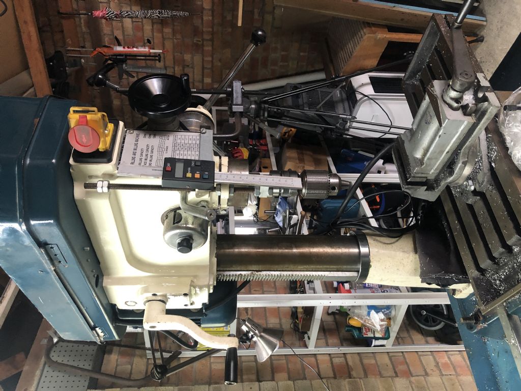

        After 20 years of use and with spindle run out getting unacceptable, I decided to inspect/ refurbish the quill and spindle on my trusty Warco Major Mill/drill…….
        I found some information on U Tube of course ….BUT…having stripped the quill control shaft , quill locking bolt and spring return and using a gear puller to remove the pulleys ( all very straightforward ) I then expected the quill to slide down for easy removal….?????
        It doesn't…???? It stops as if there is a locking / restraining 'device' which I have missed…????? I have looked everywhere on the machine and can't see anything which could be stopping the quill from coming out..???
        I have so far resisted the temptation to 'move' things with a copper hammer.
        Any HELP on this will be greatly appreciated…

                    #556905
                    Terry Turner 2
                      @terryturner2
                      mill start point.jpgYes I saw those docs and printed them off…

                                Nicholas Farr
                                  @nicholasfarr14254
                                  Hi Terry Turner 2, looking at the photo of the milling machine that have posted, I would say it looks to be similar to the Chester Eagle 25 rather than a Warco major, which may or may not have the same configuration on the quill.

                                  #556932
                                  Terry Turner 2
                                    @terryturner2
                                    With thanks to everyone who has helped me, I have to confess that I accept what Nicholas Parr says..my machine is much more like the Chester Eagle 25 than the Warco…I bought it 20 years ago and my memory had played tricks on me …not for the first time…
                                    I will now go off and try and get information about the quill assembly for the Chester machines and hope that is the answer. Apologies for almost certainly wasting your time.

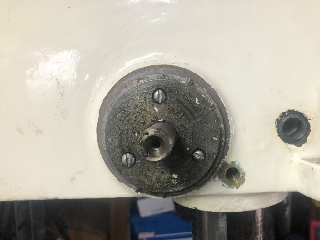

                                        Thanks Old Mart……This picture will show that everything that I can think of that would stop the quill from sliding out has been removed and I used a gear puller to remove the pulleys so no damage was done to the top of the spindle….and the locking lever and anti rotation grub screw on the other side of the head have also been removed…? .. Please see pic..
                                        I am now finding it very hard to get information about the Chester Eagle 25 which may hold the secret to the Quill design on my model…quill shaft housing.jpg

                                            Sorry that picture shows the drill stop but I removed it and everything else on the head with could impede the quill . The quill and spindle both rotate freely but will not slide out the bottom of the head like every other mill of its type I have seen stripped on U Tube…? You are right about the pulleys but I wanted to see what , if anything, was underneath them… Thanks for responding…
                                            Edited By Terry Turner 2 on 04/08/2021 21:49:21

                                              Push the quill up as far as it will go, and examine the top of the spindle to see if there is anything stopping the splines from passing through the drive that the pulleys were on.
