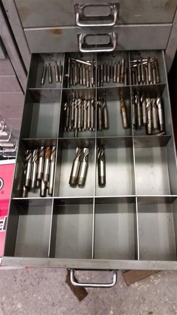

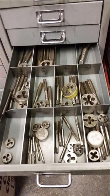

                      I also use the Bisley drawer units. For taps, dies and fasteners etc I use home made drawer dividers. I had some strips of 18 or 20g steel cut about 45mm wide, then cut them into sections some equal to the drawer inside length and some to the width. Then I just decide how many dividers I want in a particular drawer and use a mini-grinder with a 1mm disc to cut notches half way across each divider at the appropriate centres. You just slot the short ones into the long ones to make a grid in the drawer.

                            A look at a single drawer
                            Spanners 20 to 32mm go longways
                            under 20mm widthways

                              Here are the dividers I make for Bisley drawers, as described above. Simple to make and very effective:
                              Edited By Pete Rimmer on 23/12/2018 11:53:25
