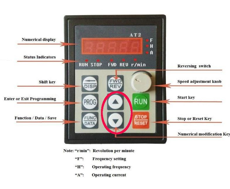

      I have a xsy-at1 inverter which I have been using for a few years without a problem. I needed to move the motor and inverter. I am now getting error code 1 and the inverter does not work. Are there any suggestions as to what I can do? I have checked the wiring and there are no loose connections.

            Posted by John Haine on 21/10/2022 15:53:19:
            What does the manual say about this error code?
            Based on the information posted about these inverters on myCNCuk (here) error code 1 corresponds (cryptically) to "Module Protection", which seems to be talking about the power module and correspond to a short circuit or current overload.

                I have checked all the wires and have disconnected them and reconnected them, but it still does not work. The manual says that you can reset by going to P77 and entering 12345, but I cannot understand how to enter 12345.

                      Posted by AJAX on 21/10/2022 19:55:59:
                      Maybe disconnect the motor and see if the error code appears?
                      +1
                      The error code indicates that the VFDs output has been shorted, which coupled with the motor and VFD being moved, suggests a wiring problem. Check all the wires:
                      • Connection to the right terminals at both ends
                      • No damaged insulation, particularly where wires run along the metal work or through grommets
                      • No whiskers
                      • Don't assume wires that weren't touched during the move are OK. It doesn't take much of a tug over a sharp edge to slice through plastic insulation, so follow the entire loom looking for trouble,
                      If disconnecting the motor at the VFD fixes the Error Code, it's highly likely there's a wiring problem. It's possible a short blew the VFD but with luck the electronic protection was fast enough to protect it.
                      No harm in trying a reset, but make a note of the current settings first. On this type of control pad, numbers are usually entered with the arrow keys (ringed):
                      With this system, you don't enter 54321 as single digits like a caculator. Instead pressing the arrow keys cause the number to count up up or down until the value is reached. Tapping the up arrow should add 1, holding down should increment slowly at first, then speed up. The down arrow does the same, except it subtracts 1.
                      It may be quicker to get down to 54321 from 0 with the down key.
                      These keypads can be a bit fiddly so experiment.
                      Good luck,
                      #618208
                      An Other
                        @another21905
                        +! for SoDs explanation – I have the same inverter, and had to reset some problem a while ago – SoDs procedure is exactly what I did. – except the reset code was 12345, not 54321.

                          I have tried reseting it and it still does not work.
