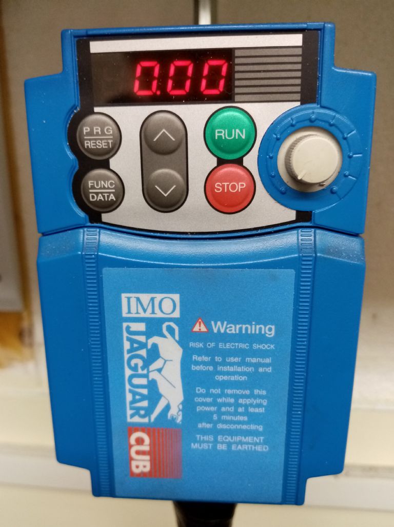

                    A quick update, last evening I went through all the F codes (fundamental functions) and found a couple of incorrect settings, rectified those and I know have control back at the panel.
                    With the motor switched off I dialled the speed control pot back and forth and the VFD readout went from 0 to 50 Hz as normal so I wonder does that show the potentiometer is ok..? However with the motor switched on and starting at zero I had drive which I could adjust from 0 up to around 80 rpm at about 20% of the pot travel but going past 20% the speed went up to 170 rpm and no more regardless of where I had the pot position. The VFD readout was frantically dancing around between 9.0 and 10.5 Hz and the motor sounded to be hunting and was noisy compared to what it normally is.
                    So do I have an incorrect setting somewhere but if I do where..? or is the pot ok with the motor off but breaking down under load with the motor on..? I would like to think it is more of a setting problem but I dont know… any suggestions appreciated guys.
                    A picture below of the VFD and the control panel I have on the lathe, Dave you asked why a control panel, well its how the lathe came and the controls sitting just above the headstock is very convenient.
