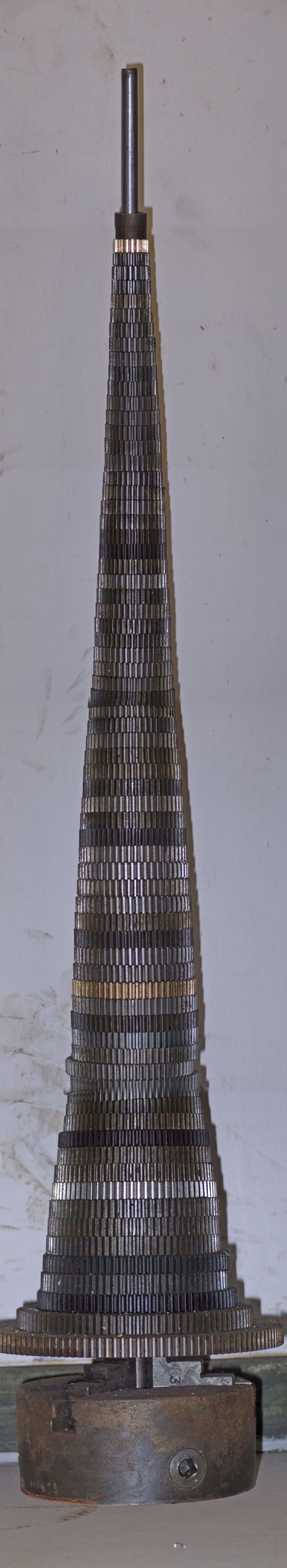

            This might interest anyone who likes studying gear cutting principles.
            It is my Alexander Master Toolmaker milling machine set up as a sort of Sunderland gear shaper.
            The indexing head has been geared to the table traverse so it rotates the gear blank as the table moves, the Sunderland cutter is going up and down on the slotting head with a clapper box similar to a shaping machine.
            A few teeth are generated at one go, then the table is returned to its start point ready for the next pass, but crucially the gear blank is manually rotated so as to overlap the previous teeth with the next new ones.
            I cannot claim this idea as mine, it was my late father who designed it, he cut a full set of Myford changewheels on it going up in one tooth increments so there is quite a large stack of them.
            Phil

              Isn't that the hat from the first Harry Potter film?

                Yeah, it looks a bit wonky though because it's about five photo's stitched together.
                Phil
                #388783
                Hopper
                  @hopper
                  Wow! To both the machine set up and what must surely the the world's most comprehensive set of Myford change gears.

                    Dad did not really need all those change wheels, his Myford S7 (now mine) has a screw cutting gearbox as well.
                    He just did it because he could, he was a very clever fella.
                    He also designed a spiral bevel gear cutting attachment for the Myford, but that's another story.
                    Phil
