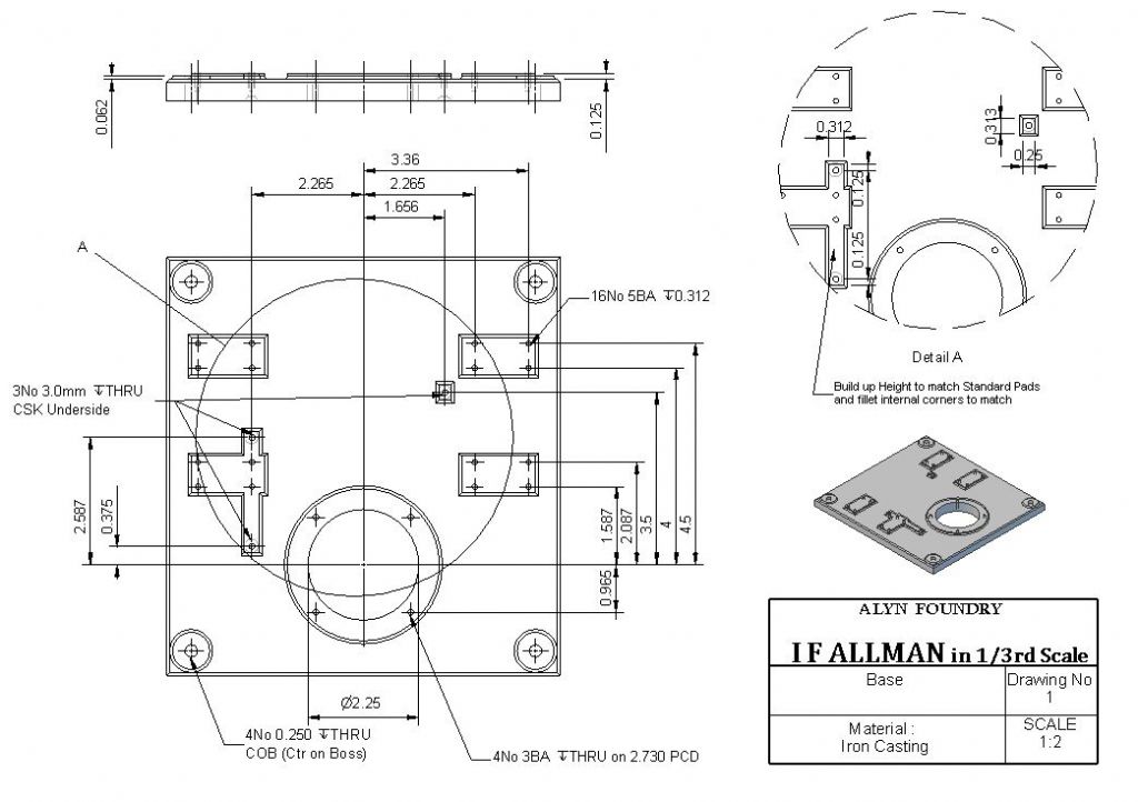

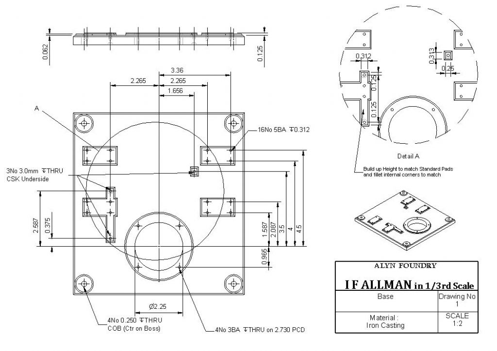

  • #391172
      As I'm working on a couple of sets of drawings that won't just be for my personal use I thought I would canvas opinion as to what people prefer in the way of colour on a drawing. I'm specifically talking about what is on the 2D print that you will be working from and even more specifically the shading of the part. I'm not thinking about the use of different colours of lines for things like dimension, ctr, hidden detail, etc which I personally don't like or the use of a multitude of colours for each part during the design stage.
      Below are 3 possible options
      1 Just plain lines. No different to how drawings have been presented for years and how I havepreviously done the last couple of drawing sets shared here.
      2. The 3D image has been coloured based on what I used during the 3D modelling which in the case of this part is a darkish grey for cast iron, steel would be a lighter grey, brass yellow etc. Uses a small amount more ink and I have kept the 3D image smaller than the scale of the actual part to reduce this.
      3. Fully coloured. This would definately use up quite a bit of ink which some people prefer not to do and I tend to feel the same preferring to spend my money on metal rather than ink refills. The other downside is that the darker grey can obscure some of the lines and dimensions and may be worse if printed on basic paper as the ink can bleed a bit. Plus side it it can look nice.
      Look forward to your thoughts and Comments

        #391175
        Anonymous
          1. My preference
          2. Maybe, although a shaded isometric view doesn't add much – an exception would be an assembly or partial assembly where different shades would delineate the parts, and it would make sense if the shades reflected the materials
          3. Definitely not, adds nowt and tends to obscure the engineering detail
          Andrew
          #391176
          Thor 🇳🇴
            @thor
            My preference would be No 2, as Andrew I think No 3 obscure detail and makes it more difficult to read for my old eyes.
            Thor
            #391178
            Martin Johnson 1
              @martinjohnson1
              I think option 2 is a reasonable compromise.

              #391181
              nigel jones 5
                @nigeljones5
                Keep it one colour for me for best clarity – they only ever get worse with age
                #391183
                Russell Eberhardt
                  @russelleberhardt48058
                  For me 1, 2, and 3 in that order. Perhaps I am a bit of a stick in the mud having first been trained in drafting over 50 years ago.
                  Russell

                        #391188
                          I like drawings that are attractive and easy to read!
                          A plain 2D drawing (Option 1) is best at showing dimensions and therefore essential in the workshop but they are poor at expressing shape. Ever confused 1st and 3rd angle projection or misinterpreted the intended form? Adding a 3D representation (Option 2) adds clarity to the shape, but even 3D can be ambiguous. It's sometimes helpful to bring out the structure by shading or with a touch of colour.
                          Taking Option 3 to the extreme, I often find photo-realistic images helpful as well. They give a clear idea of what the finished item looks like and provide important clues as to how parts relate together, and perhaps other details such as the paint job or finish. During assembly, which is an important part of Model Engineering, I find exploded parts and sectioned views are often clearer in full colour than in black-and-white. (A Haynes Manual that only gave the car mechanic Option 1 production drawings to work from would be a failure.)
                          Colour becomes counter-productive when overused, misused or confused. Despite no-one wanting garish confusion in a technical drawing, there are too many examples of just that about. Perhaps it's impossible for the average draughtsman not to get drugged by Glorious Technicolor!
                          An advantage of a 3D CAD package is that it can produce all these drawing types without a lot of extra work. But as always, the author has to target his audience carefully. If colour adds value I'm all for using it. Otherwise, don't!

                                #391195
                                Martin Connelly
                                  @martinconnelly55370
                                  I have spent a lot of time producing drawings for other people to use and have always used different line weights for edges as Martin J above preferres. The circle delineating the detail view in the example above is confusing because everything has the same line weight. I also add a 3D view when it will help and shade it only if it helps.
                                  BS308 paragraph 8.3 "Choice of views" states:
                                  "All views should be chosen to impart the maximum information clearly. Hidden detail lines should only be used where essential but should not be used for dimensioning.
                                  NOTE. An isometric or similar view of a complex part or assembly may be of considerable value in the understanding of the drawing. "
                                  Seems like a sensible methodology to me.

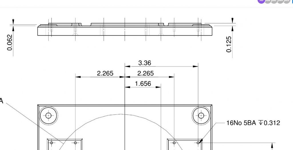

                                            #391289
                                              Thanks for the many replies, I won't respond to you individually but will make these comments:
                                              It looks like No1 is the popular choice with No2 a close second. No1 is as I said what I have used in the past so that looks like it is the way to carry on with the 2D drawings. However I think as part of the package I will do a few sheets with coloured general arrangement and some sub assemblies possibly sectioned too that can be viewed on the screen to get a feel for how things go together much like this which I have just quickly put together. May also do a fancy rendered one too which I did start on a while back. There will also be my usual 100plus build photos available.
                                              The small isometric will stay as I think that helps visualize the part particularly on my own engine designs that have been aimed at the beginner, this particular one is for a set of castings by Alyn Foundry and I don't see many beginners making that and maybe only two others makers if no more castings are forthcoming.
                                              I do have an A3 printer but have sized all the drawings to A4 and scaled the parts to suit as that is what the majority of people will be using to print out their set on.
                                              They will be in PFD format as that again does not need anything special to open, view or print and the files are a reasonable size. i'm approachable to anyone who may want a part in a different format for CNC etc, don't think there is a lot in this one that would lend itself to that but some of my Series 24 from barstock designs would.
                                              Line widths have come up in a few replies, The images posted here are just screen shots and then resized by the forum software so don't really show what the actual print looks like. main solid lines are 0.25, dimension 0.13 and hidden detail 0.13 grey scale which are standard ISO pen nib sizes so will reproduce to standard sizes if the drawing is blown up to any other A size sheet. I will change that solid "Detail A" ring to a broken line as that was bugging me too. Below is a screen shot of the PDF ( again some clarity lost) or a direct link to download for those interested here
                                              Without getting too much into the BA -metric debate. For my own designs I am using metric throughout with the odd exception for something like BSP though I could spec that as a "G" thread wink 2 This particular engine has a lot of the cast parts that are imperial and the other ones in their range were predominantly that too so I have stuck with imperial stock and BA fixings where visible but anything out of sight is metric for example the 3 CSK holes are sized to suit socket CSK screws and on other parts I have used some metric fine where the castings have come out a bit tight for BSP for example m10 x 1 rather than 1/8" BSP.
                                              Thank's again and keep any feedback coming.

                                              Mick B1
                                                @mickb1
                                                Posted by Martin Johnson 1 on 15/01/2019 16:20:43:
                                                Another personal grouse is showing edges, centrelines and dimension lines as all the same weight. BS 308 (when I learnt it 45 years ago required the edges to be a heavier weight.
                                                You wanted opinions………………
                                                Martin
                                                I've a marginal preference for 1 over 2, on the basis that the drawing should carry all required manufacturing information in preference to any cosmetic enhancement, and there appear to me to be missing dimensions.
                                                I was a tool designer in the late 70s/early 80s and recognise your grouse. I can remember one very experienced designer who used to draw his tools using the same thickness for all lines, entirely in 3H pencil, and might throw big, complex bundles of dimension lines long distances across a sheet of A0 draughting film. The toolmakers all hated him, and would accidentally-on-purpose manufacture his designs exactly as drawn, with hostile disregard for any errors.
                                                #391302
                                                  Mick, could you let me know what dims you think are missing please.
                                                  #391304
                                                  Mick B1
                                                    @mickb1
                                                    Posted by JasonB on 16/01/2019 09:43:51:
                                                    Well, I'm not seeing overall thickness of the casting anywhere. I've looked several times – have I missed it somewhere?
                                                    Come to that, the corner pads and hole positions, don't seem to be dimensioned either, nor overall length/width.
                                                    And I'd have to make assumptions about the x-position of the left-hand holes on the left-side rectangular pads, whereas that of the left-hand holes is specified.
                                                    Edited By Mick B1 on 16/01/2019 09:53:23
                                                    Edited By Mick B1 on 16/01/2019 09:55:07
