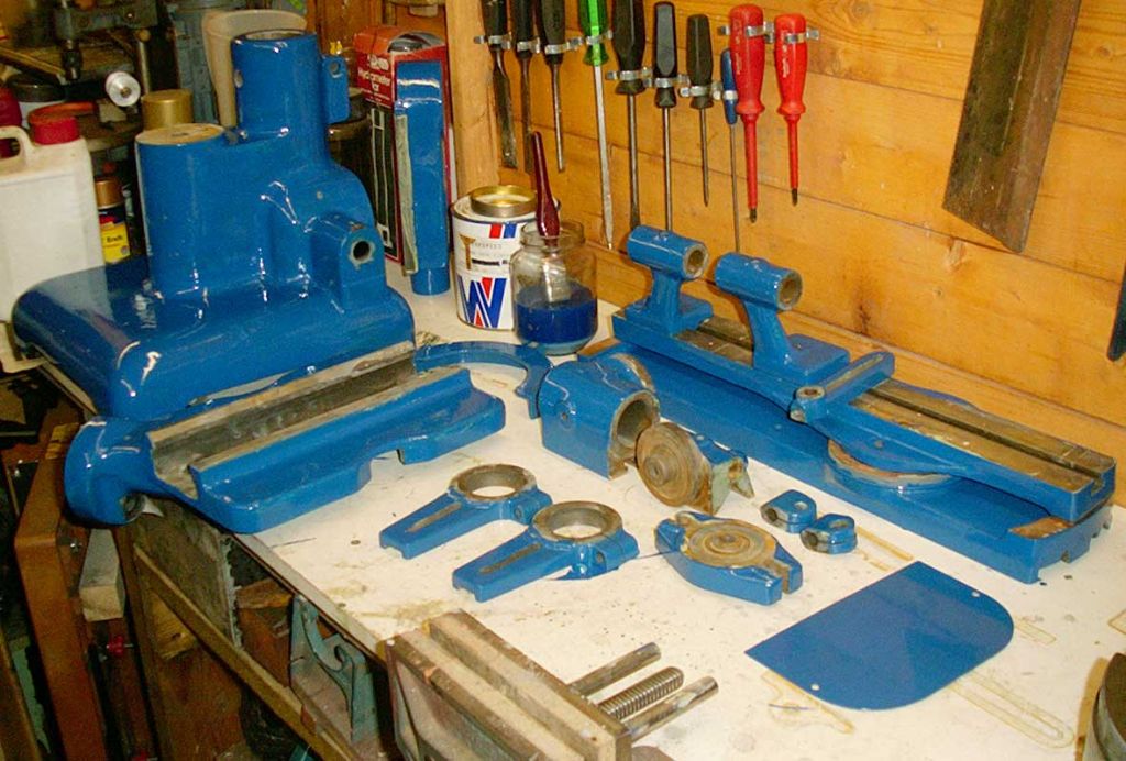

            Phil P
              @philp
              Here is what they look like in bits.
              I have quite a bit of info on these if you need anything.
              Edited By Phil P on 05/07/2022 22:18:03

                Pete.
                  @pete-2
                  Thanks Phil,
                  Your machine is top of the results anytime you search one of these on Google, it looks really good, I will be fully rebuilding it in due course to make sure everything is as should be, so may well benefit from your knowledge thank you.
                  You've also made an independent spindle system rather than the grinding wheel directly attached to the motor?

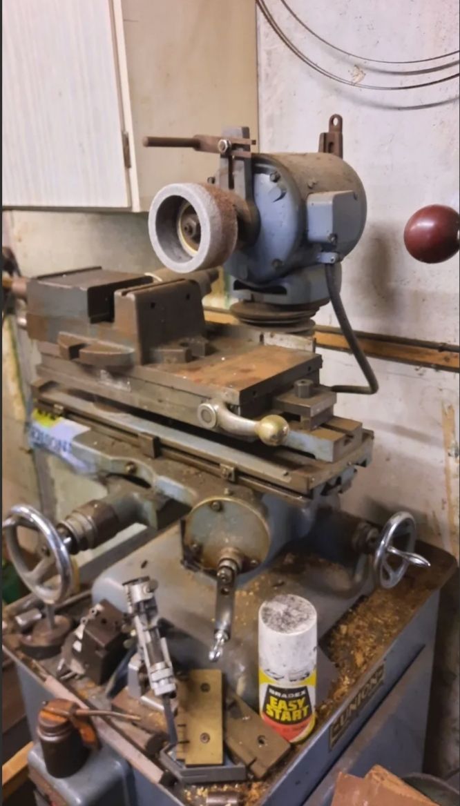

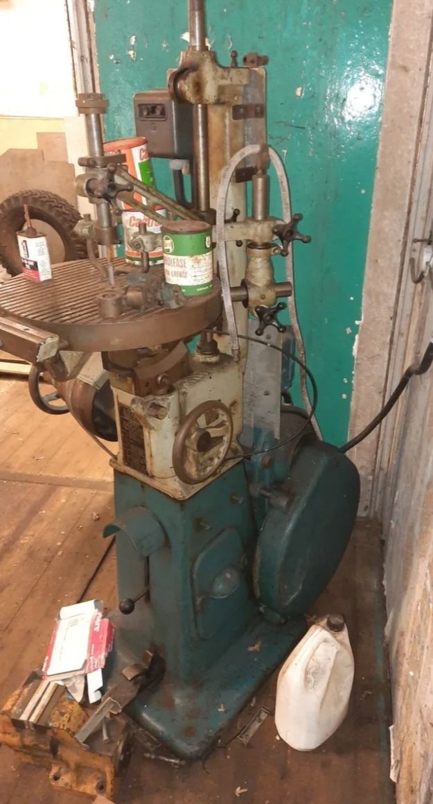

                      #604638
                      Pete.
                        @pete-2
                        Hi John I received your email with the manual, thank you very much greatly appreciated.
                        180 mile round trip, but worth it I think as these don't come up for sale very often, also came with an eclipse magnet and a vice, which are both a bit too big so I'll sell those.
                        The seller is clearing out a deceased gentlemans estate, he also has this very nice die filing machine if below if anyones interested, wish I had the space for it.
