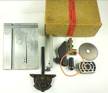

      Bit of a long shot but does anyone have a unimat sl circular saw / slitting saw arbour that they could take some measurements off please? I've scoured the web for hours without success!
      The part I need dimensions for is in the picture below. I just need overall length, length without cap/washer fitted and diameter. Any help is greatly appreciated!

              the dimensions are overall is length 55 mm diameter19 mm and there is collar the first measurment 45 &half mm & the second is 50 mm and collar dimensions 25 mm & size of peg on the front 16mm &the length 5mm the front is threaded the same as the spindle and at the front is tapped 8mm &there is a recessed washer I hope this helps regards NR

                Brilliant that is absolutely perfect! 👍 Everything I needed to know and more! Thank you very much for taking the time to measure the part for me. I appreciate your help very much indeed. I am now one happy bunny. Cheers! 😀
