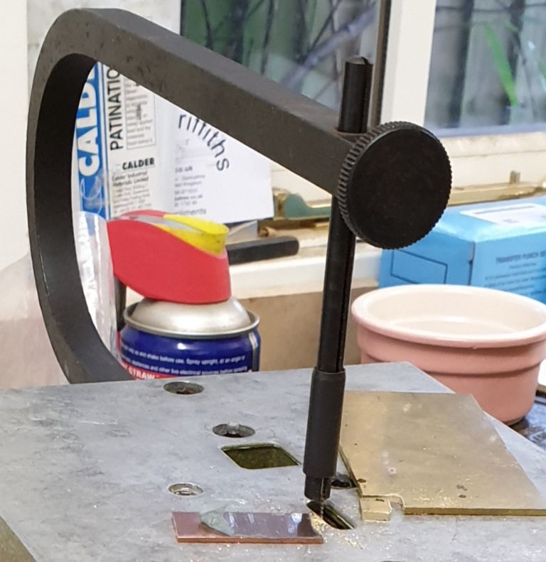

      Unimat Fretsaw No1080 arrived today, looks to be in good condition though needs a good oiling.
      If anyone is familiar with these, I'm not clear how the upper blade guide locks the blade?
      The part is a piece of rod with a slot cut down its length, then a VERY tight piece of tube at one end, also with a vertical slot. Currently both rod & tube are a very tight fit, I'm assuming they are meant to be movable against each other and should somehow clamp the fret blade in place?
      Any assistance as always gratefully received!

            Hi Bill, thank you, I have a general assembly diagram of how the saw components fit together, but it dosen't show how this part works, or is meant to. Maybe you have some more specific info, if that the case then yes please do send it over.

              If you attachment looks like this, the rod is just a guide for the blade. The blade is not actually fastened to anything at the top but just slides in the slot in the rod which acts as a guide. The tube on the rod is fixed and serves to retain the blade in the slot. In use the rod is moved down to just clear the work and is clamped to the frame at the top with the large knurled thumb screw. It is also orientated with the slot to the front so the cutting pressure pushes the back of the blade against the slot.

                John Purdy has described operation perfectly, be sure to feel the cutting action in use and don't try to force the cutting speed.

                  Thank you so much John and Emgee, yes mines like that so problem solved. I need to get some metal cutting blades now, what sort of TPI would be good for 1mm brass & copper?

                                          Ok well I set the fretsaw up this morning and was pleasantly surprised with how it works.
                                          Cut 1mm copper and 1.5mm brass without much problem.
                                          Unimat Fretsaw
                                          Only issue I can see is if as suggested the top guide is lowered down to just clear of the work being cut, to act as both a hold down and blade support you cannot see where you are cutting. So that's something to think about..and any ideas are welcome.

                                            When I use mine I set the blade guide 1/16 – 1/8" above the work. This provides good support to the blade but allows you to see what's going on. It's not actually used as a work hold down (that's the job of your fingers!).
