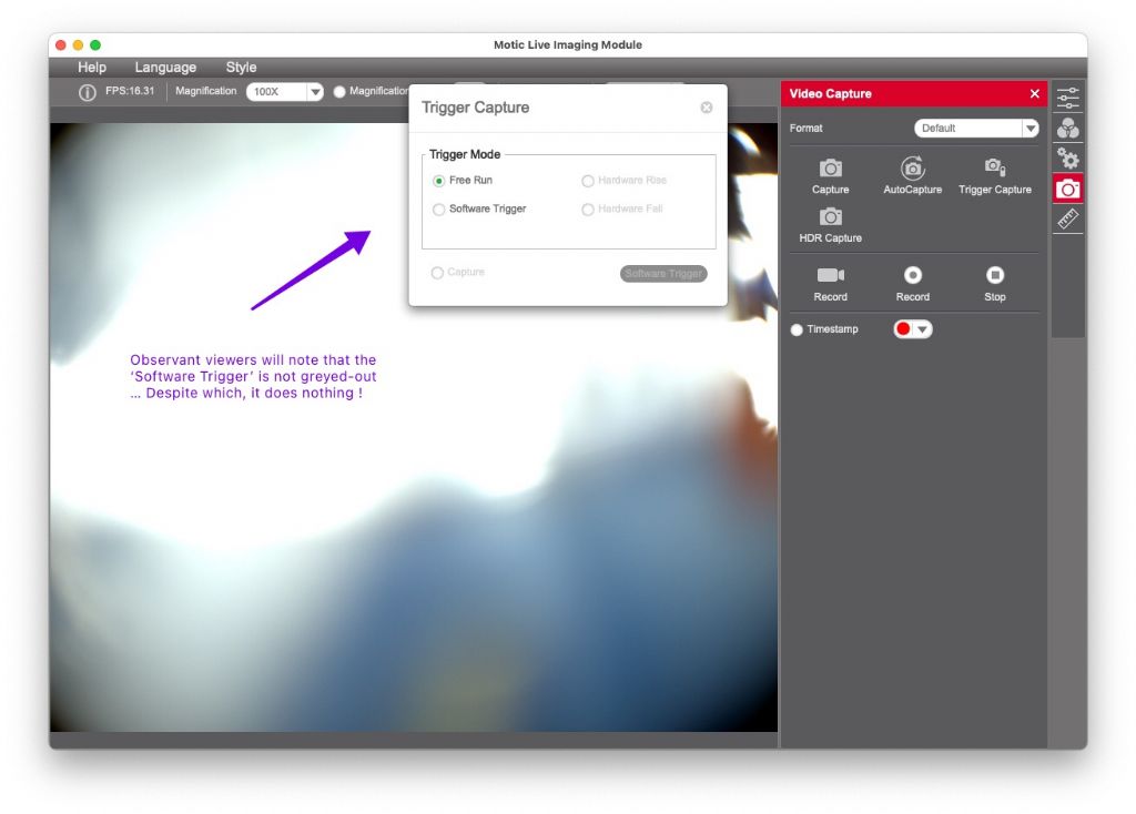

        I have a Motic microscope camera, which I want to ‘control’
        The standard Motic software does not include the functionality that I need, but my dealer contacted Motic on my behalf, and they indicated that the TWAIN driver might do what I want.
        **LINK**
        https://www.motic.com/As_Support_Download/d94.html
        Trouble is … I know nothing about TWAIN
        We seem to have folks here with knowledge of most things … So can someone please point me to a decent introductory tutorial ?
        Thanks

                        Thanks for the comments, Robert
                        … This is a resurrection of the project that we were discussing previously [relating to that high-speed LED strobe]
                        The standard Motic software is very capable, but [contrary to first appearances] does not implement ‘Software Triggering’
                        I asked my Supplier [Pepler Optics] to investigate … Andrew had never needed to use that, so he contacted Motic on my behalf …
                        [quote]
                        Hello Michael
                        We have now received a reply from Motic.
                        The trigger function is only available with some software that allows this performance. Our Motic Image 3.0 and 3.1 do not have this option. You can find this parameter on the camera’s parameter, but it isn’t activated. Remember that our cameras are compatible with other software that you can install using the TWAIN function.
                        [/quote]
                        Frankly I find this disappointing !
                        Add to that the fact that Motic’s TWAIN driver is dated 2015 and I am rapidly losing hope.
                        Edited By Michael Gilligan on 19/05/2023 09:28:24

                          [ UPDATE ]
                          Mission Aborted … please forget I ever asked.
                          I have two Mac mini computers: one with the Intel processor, one with the M1
                          Identical errors on both:
                          < bad CPU type in executable: >

                                Please see my previous posts this morning sad
                                The Motic TWAIN driver will not install on either of my Mac minis
                                I have submitted a support request:
                                [quote]
                                I have a Moticam ProS5 Lite [SN ########] and wish to use TWAIN for "Software Triggering"
                                Your TWAIN download is date-stamped 2015, and it does not install on either of my Mac mini computers … Intel running Monterey, M1 running Ventura.
                                Will you be releasing an updated TWAIN driver ?
                                Thanks in anticipation of your kind advice.
                                [/quote]
                                Unless and until I get a satisfactory response, the camera cannot be “Software Triggered”
                                … project abandonned.

                                        Thanks for the thoughts, Bill
                                        Although it is possible to spend much more elsewhere, this Moticam was a significant purchase for me.
                                        It’s a Moticam ProS5 Lite [regret I could not justify the extra cost of the ProS5 Pro, which is faster]
                                        Natively it has a 2/3” 5Mp sensor, with 3.45 x 3.45 micron pixels, but can also run at higher maximum speed with pixels binned.
                                        Motic seems rather coy about revealing the identity of the sensor, but I believe it’s a second generation Sony Pregius: **LINK**
                                        https://www.framos.com/en/sony-pregius-cmos-global-shutter
                                        I have never yet found any non-Motic software which will run it [without resorting to TWAIN of course]
                                        … a widespread problem with “scientific grade” [sic] cameras in general.
                                        Having purchased the [blisteringly fast] M1 Mac mini to accompany it, I am not too keen on the idea of using another operating system.
                                        Hopefully, Motic will come-up with a new TWAIN driver sometime.

                                            #645862
                                              [ UPDATE ]
                                              Laura, from Motic Barcelona is on the case yes
                                              [quote]
                                              Dear Michael,
                                              Thank you for contacting with Digital Support department.
                                              We acknowledge your message and we have requested a new TWINS for MAC update version to our software engineer department.
                                              We will come back to you as soon as we have this file available.
                                              Sorry for the inconvenience and have a nice afternoon.
                                              [/quote]
                                              Can’t ask for a better response than that ^^^
                                              [ even if the spell-checker does think it knows best ]

                                                #645867
                                                Keith Petley
                                                  @keithpetley53472
                                                  Michael, looking at the driver from the link in your first posting I get the following – which explains the CPU type mismatch, but doesn't help solve the problem.
                                                  Keith
                                                  Keiths-MacBook-Pro-289:MacOS keith$ file MoticTWAIN
                                                  MoticTWAIN: Mach-O universal binary with 2 architectures: [i386:Mach-O bundle i386] [ppc_7400]
                                                  MoticTWAIN (for architecture i386): Mach-O bundle i386
                                                  MoticTWAIN (for architecture ppc7400): Mach-O bundle ppc_7400
                                                  #645885
                                                    Posted by Keith Petley on 19/05/2023 15:34:28:
                                                    Keith
                                                    Many thanks for that, Keith … It nicely explains the installation failures I suffered, and also the reason why there are two versions in the package.
                                                    Much appreciated yes
                                                    Just hoping that Motic can come-up with the necessary.
