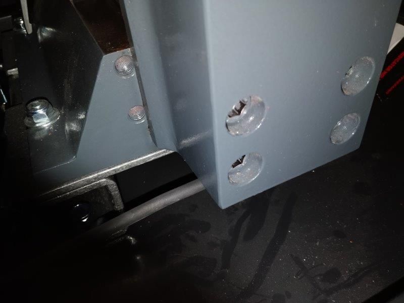

        Anyone know how it might be possible to correct the column alignment of my BF-20 mill (in the X direction)?
        A bit different to a SIEG which has the bolts at the base where this has the four bolts horizontally. Any ideas?
        Y is easy by shimming, but is okay on mine anyway after checking with a machinists square. X needs work hence the question.
        #326157
        Clive Foster
          @clivefoster55965
          Simplest way is to enlarge three of the holes so the column can be appropriately shifted by pivoting about the unmodified hole. If necessary add a spacer to take up any clearance around the pivot bolt so the column can only rotate about it. Becomes a nightmare job if the rotation fulcrum isn't stable. Once correctly set drill through the column and into the base for a locating pin. Officially such a pin should be a taper type but a tight fitting parallel pin will do fine. Put a tapped hole in it or leave proud with an external thread so you can get the pin out if need be.
          Its more work and requires longer bots but adjustment is much easier if you also make the counterbores significantly oversize to take top hat form spacers with hexagon ends. Drill three suitably eccentric to accommodate the movement and one concentric for the pivot. Fit the concentric, pivot, spacer to one bolt and one eccentric one diagonally opposite. Nip up so the column is stiff to move and use the eccentric spacer as a cam to get the position right. Fit the other two eccentric spacers and do their bolts up tight before finally tightening the adjuster and pivot bolts. Obviously the spacers need to be a close running fit in the counterbores. No need for a pin as the top hat spacers hold things in place.
          Before starting work its prudent to draw things you to see how much movement in which direction you need to make provision for.

              If the alignment is done with just 4 bolts it would move around all over the place , maybe some alignment dowels in there somewhere ? If there are no dowels you should be able to loosen the bolts a little then tap the top of the column across to align it , this is what i had to do with the head of my x2 mill as the head casting is 2 piece and the column tilts – ideally after the alignment is done fit some taper dowels .
              Just out of curiosity how did you ascertain that the column is tilted ?

                        I use a pretty simple method to align the column ,
                        Set up a dial indicator on a mag base and clamp it to the side of the head ( not in the spindle ) then set up an angle plate on the table and square it up so the vertical face is at 90 deg to the x axis ( use an engineers square for this ) you can then use the indicator to sweep the vertical face of the angle plate .
                        Lock the X and Y axis up then take a reading by moving the head up and down the column , compare the reading at the top with the one at the bottom of the angle plate , don't wory about what it shows when you are raising or lowering the head as it will wander all over the place so just use the reading at the top and bottom of the angle plate and lock the gibbs up at each reading to remove any play between the column and head .
                        Once you are happy that the column is square to the table you tram the spindle in the normal manner .
                        You can use the same method to check if the column is tilted forward or backward just set up the angle plate parallel to the X axis .

                          Yeah that's basically the same method I use to align the column but use a machinists square instead of an angle plate. And I use a (knock off) "indicol" to attach the DTI. Readings do indeed vary a bit on the way up or down as you've mentioned.
                          That test doesn't matter if the head is out, and what I'm not understanding about Neil's note about being hard to align the column without aligning the head first.
