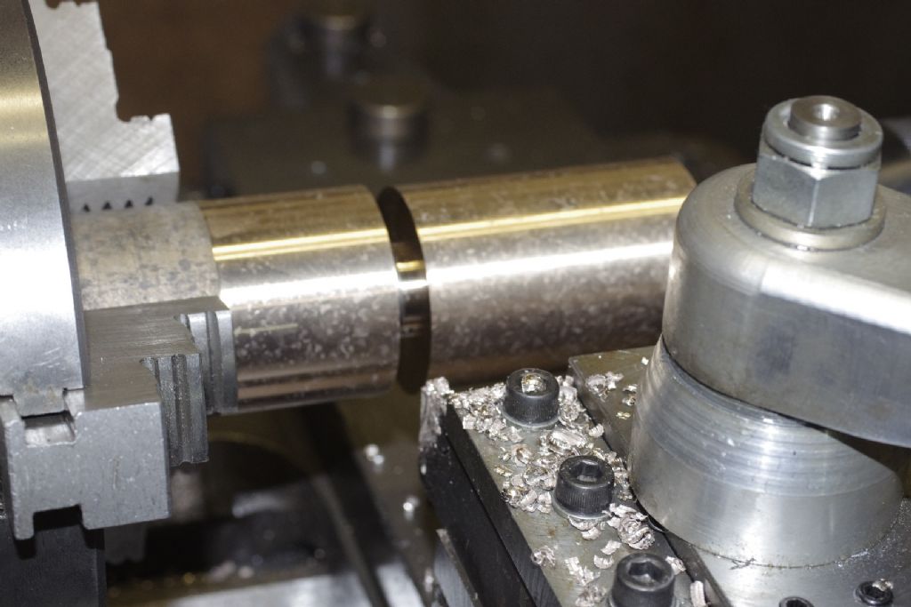

                    _igp2684.jpgI have started on the new nut for the knee Z axis. The length of leaded gunmetal, sae 660 has the bore opened up to 0.8" as the starting size for 1" X 5 ACME. I have to make a tool to hold the IR22 5 ACME insert. The tool is being made of an unidentified bar of something that looks like a high tensile stainless steel. The angle of dip for the insert is 14 degrees and I have left the helix angle at zero as the tool may be used for right handed threads as well as the left hand thread I will be cutting. The actual helix angle for 1" X 5 ACME is 3.65 degrees, I might have to give the insert a little added relief before cutting the thread. This is a time that a rotating base for the vise comes in handy. The bored gunmetal was parted off with a little added support from the tailstock and I used a 26mm 2mm wide Kennametal blade with an A2 insert. Gunmetal is one of the easiest alloys to part off. The threading tool will need some slight mods to fit the bore and I have to wait until the internal threading insert arrives from APT. Being a left hand thread,I can use a righthanded tool and thread away from the chuck which is much easier._igp2680.jpg
                    Edited By old mart on 04/11/2020 19:33:25

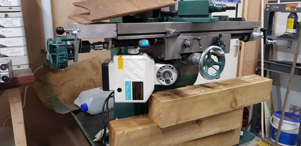

                      That will be interesting to see how the job develops old mart. I fear mine has the dreaded wear as on occassion the table drops. usually when it is low down. Tight gib sindrome.
                      Today the new drive motor arrived. It is for a Bridgeport X axis , which i am going to use for the Z axis. Everything is wrong dimension wise so new bushes & mounting plate to make. The Brass crown wheel needs boring to the Tome senior size. Lots to do & looking forward to doing it.
                      If all goes well it may add a few extra years to my weary shoulder.
                      Steve.
                      Edited By Steviegtr on 04/11/2020 22:48:05

                        I cannot see exactly how one of those drives can be shoehorned into position for the Z axis. There is very little clearance between the chip tray and the knee at the lowest position. Also, one of the reasons I didn't make the long handle for the knee a permanent fixture was because it got in the way of the operator. I would love one on the Xaxis for the museum's TS._igp2672.jpg
                        #505536
                        Steviegtr
                          @steviegtr
                          old mart you are spot on with your comment. I was hoping the drive was a bit shorter than it is. I tried to get dimensions before i bought it but could only scale it in my head from watching youtubers fitting them. Size of hands etc.
                          I am going to loose around 75mm of lower travel. On the plus side i will still have 330mm of useable room, bed to quill. I have not so far needed the bed to be that low down. Now i have said it Sods law will prevail.
                          In fact until i fully lowered the knee tonight, i did not realise how far it went.
                          I am still going ahead with the job. I guess in the unfortunate circumstance i ever need the extra room i could always remove temporarely. Made a sleeve bush tonight for the central needle roller bearing & will be going forward tomorrow with other bits. I am filming as i go.
                          Steve.

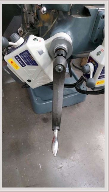

                            You do not have to fit the feed unit hanging vertically, it can be fitted rotated clockwise, to regain the lost travel.
                            It's quite common to see them fitted off vertical, to clear the Y axis feed unit fitted on some machines.
                            Nick.
                            Edit:- Worth noting, that the dedicated Z feed units come with a different feed direction lever, to that fitted on the X axis units.
                            Edited By Nick Hughes on 06/11/2020 10:55:59

                              Yes Nick ,the operating lever, luckily being where it is will miss the hand wheel once put back on. At right angles it may have been a knuckle basher. I tried holding it asqew & it looked a pigs ear. Also on its side it will cop for all the swarfe in the controls.

                                If the unit would be ok at right angles in your case, you would not loose that vital Z travel. I am still worried about the low torque from most of these units, there is a slightly more expensive that has almost three times the torque. I think you will burn out the motor very quickly.
                                The reason I added that cranked lever was because of the high ammount of effort needed when the loading was high and the knee was low down.

                                        I do hope it works ok, I would like one on the X axis of the museums mill, but the cost at the moment is putting me off.
                                        The 5 ACME internal insert came from APT today, and I found my mistake when making the toolholder. It will have to be modified after lockdown as the insert hangs off the end by 3mm. I will have to move the housing 10mm to fully clean up, but the bar is plenty long enough. The bronze is 2 1/2" long, and there will still be 85mm to fit in the tooplpost.

                                            I cannot remember the length of the original TS nut, but I have enough gunmetal to make two 2 1/2" long nuts. The flange with the bolts in it and the lower part diameter will be finalised when the knee is removed. The flange might be screwed on and locked in place, it's too early to decide. Only one of the bronze bits has had the 0.800" bore done, the other remains 17mm, I might look at the Y axis nut, who knows?
