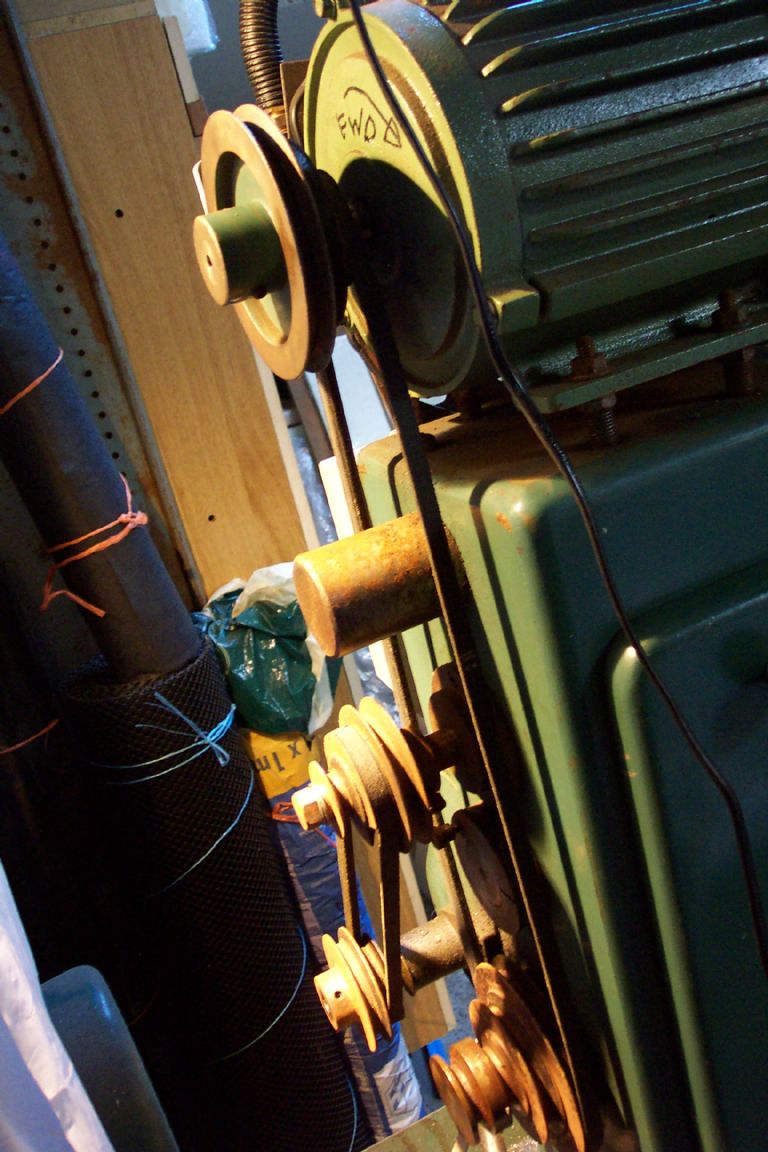

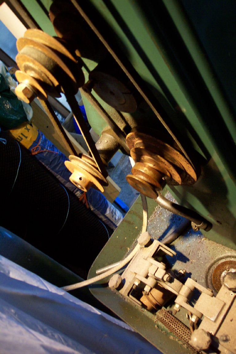

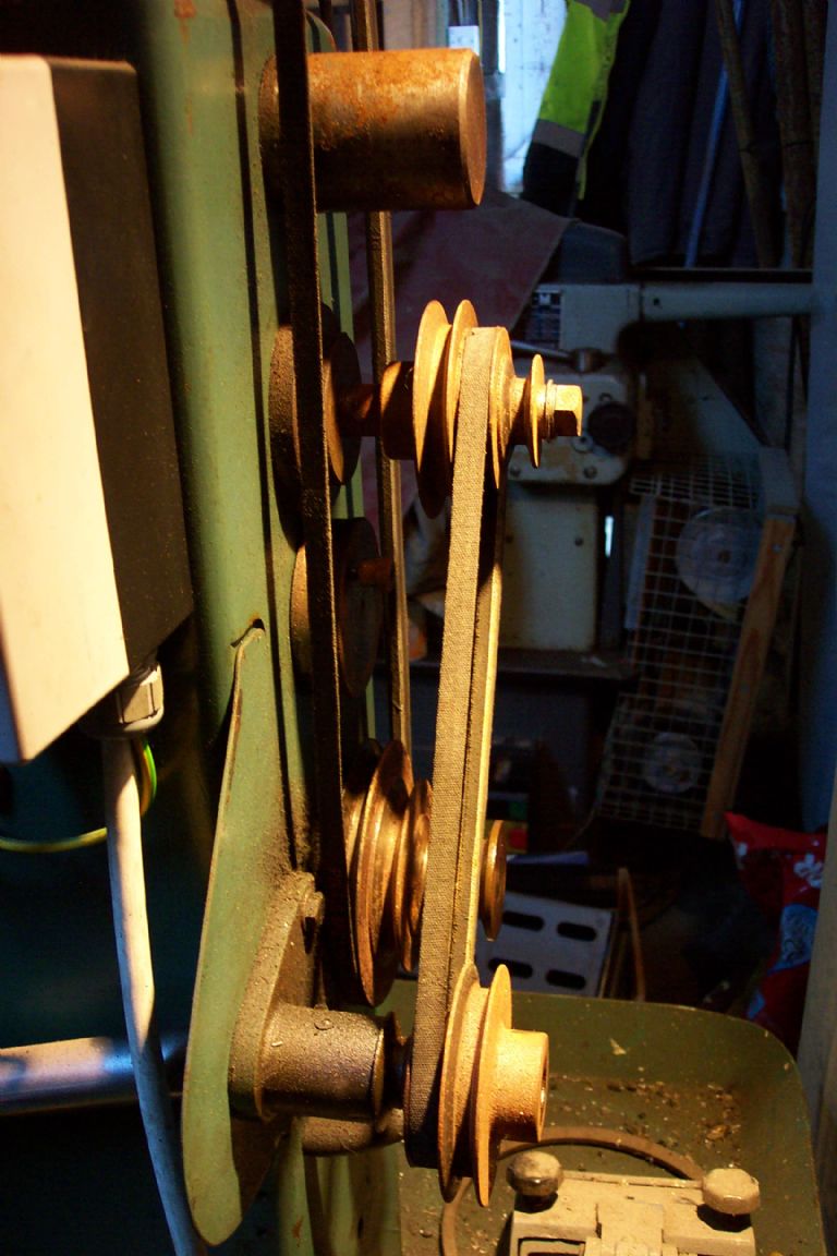

              table drive seen from the other side.jpggeneral view of belt drives.jpgHello Graham,
              I can't help you with your question on the knucklehead, I don't have one and haven't seen one set up
              I have attached 3 photos of the belting on my machine. There seems to be no adjustment for tensioning to the table feed drive. The suds pump is driven off the vee on the outer end of the bottom pulley. The main drive belt from the motor runs around the outside of all the pulleys, tensioned initially by jacking the motor on it's mounting bolts. Then finally by swinging the eccentric mounting for the drive input into full tension and held by the pin.This last action also tensions the belt inside the body of the mill.
              I usually leave that setting un-tensioned so as to avoid stretch and permanent 'sets' in the belt when I am not using thye mill
              I hope that helps you

                Thanks Brian. It confirms I don't have a tensioner missing on the table drive

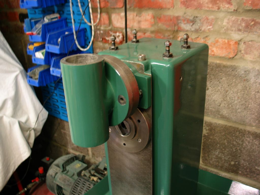

                Here's a picture of the knucklehead (well, a stripped one) offered up to the column.
                Graham

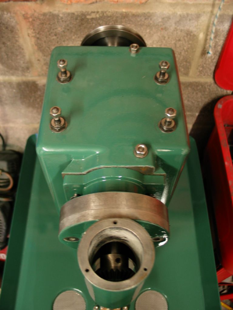

                  An alternative view, hopefully showing how it is driven via the drive shaft that goes through the column to the rear with its own pulley.
                  I guess it must be driven via a belt directly from the motor and be limited to 3 speeds. The only other way would be to drive it via a belt from the countershaft but you would restrict some of the speeds as there would be two belts on the bottom pulley at the same time.
                  Graham
