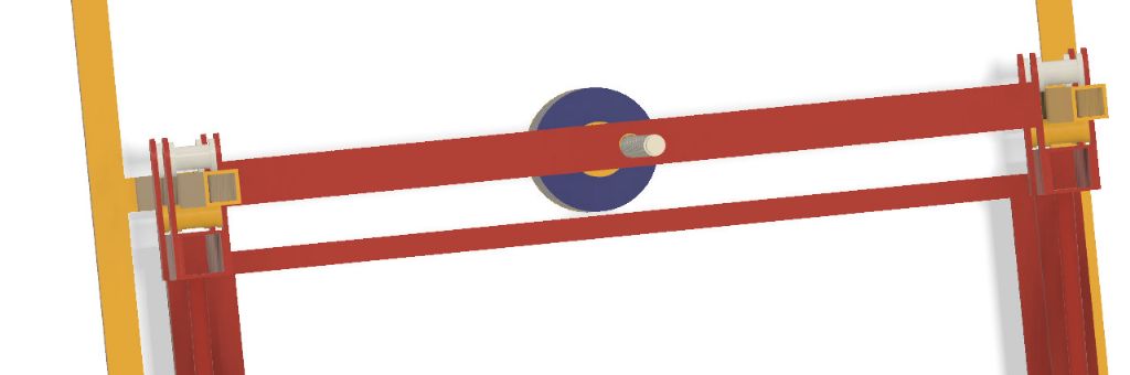

      Hi Michael, I'm not interested in being right, I just want to make a device that works, so I'm open to all suggestions .
      In order to reduce the overhang as much as possible I designed the roller assemblies to be symmetrical; all 13mm basic diameters with cheeks or flanges as guides. The "jockey" rollers don't actually do anything except help guide the seat. The axles were originally 8mm diameter. By "proper" bearings I assume you mean ball bearings. I thought of that but was advised that ball races with an OD of 13mm wouldn't withstand the expected forces – that's why I thought of needle rollers.
      Unfortunately, increasing the diameter of the rollers increases the overhang of the seat relative to the upright guidance rails.

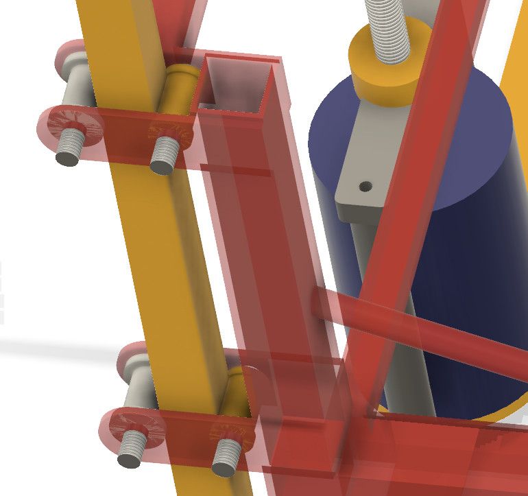

        Ian, I'm not convinced that two screwed rods would make the seat any more stable than the pairs of rollers that surround the uprights, as shown in the picture. Am I wrong?
        I've removed the parts that obscured the view.

          For that application look at the track rollers I linked to in my earlier post
          https://www.bearingboys.co.uk/SupportYoke-Track-Roller–1724-c
          I also think you need two back braces either wire, rod or tube, one on each side to stop the frame twisting.

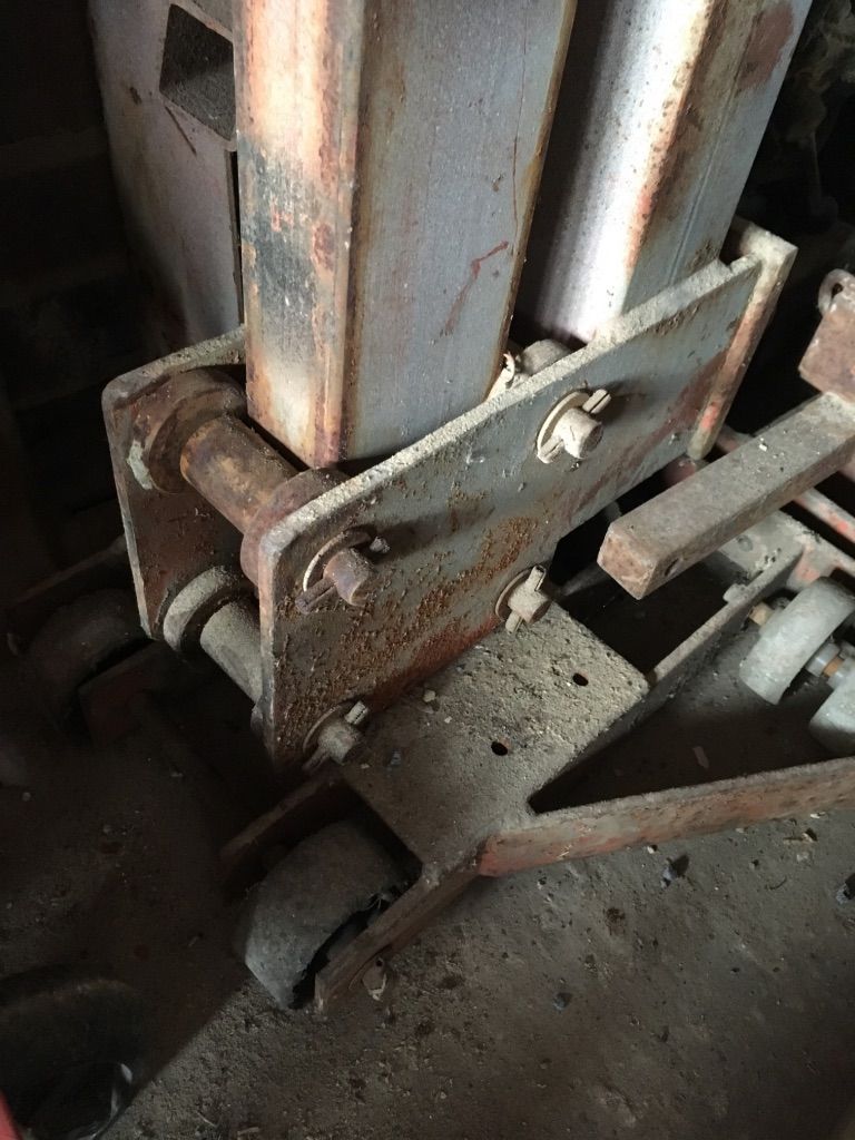

                Your drive system appears to show the motor at the bottom with the screw working in compression. Wrong way round as it will try to buckle giving a bending / whipping effect that will send nut friction through the roof. The screw must be hung from a bearing at the top so its in tension. Bearing needs to be fairly free and the nut in a pivot so it all takes up its natural position. Look at the old style car "plug in the sills" side-jack. Engineering standards are applied crudity really but they lift half a ton with no great trouble.
                The original EasyRizer used a simple Allthread screw of similar dimensions to what you are using and was frequently demonstrated with a Honda Gold Wing perched on it running up and down under drive from a fairly ordinary, albeit good make, battery screwdriver. If yours has so much friction that it won't lift a person you have some serious fundamental design issues.
                I'd scrap the "door frame" and go for a single column with two triangulated braces back to the rear foot extensions. Picture shows the guide roller end of a hydraulic lifter rated for something over half a ton on a platform similar to, but rather larger than a person seat. Perhaps approaching double the effective overhang.  Weight limits set by the hydraulic pressure and base details not column & guides.
                Main tube is 2" by 3", axle pins are about 3/4" diameter on approximately 5 1/4" by 4" centre. Rollers are about 1 1/4" diameter with a 2" (ish) flange on one end. The other flange is free running. No significant side to side wobble when loaded although flanges just barely don't touch the main tube.  I imagine there is reason for one flange on the roller and one loose.  All steel. Made to rusty industrial "keeps on going" standards. The actual lift is between the lift guide tube and the platform. A top hung screw would work just fine. That one has a simple vertical hydraulic cylinder in a tube which connects the top of the hydraulic rod to the guides and platform. Tube also protects the rod when extended. For a screw version simple overlapping covers would seem more than adequate to keep things out of the works
                Always remember being told many years ago when struggling to make one of my genius ( aka stoopid) ideas work "When your are in hole stop digging and copy something." Advice I was young and hung ho enough to ignore at the cost of a weeks worth of spare time to end up with less than stellar, albeit more or less functional, results.

                  I might be misreading the drawing, but there looks to be 4 rollers. I'd have expected there to be a roller on the seat side at the bottom, if not then the seat is skidding on the pin, you need rollers on the seat side at the bottom and the back at the top

                      There are eight rollers – 4 on each side. I've made the seat semi-transparent to make them easier to see.
                      What are cam follower bearings and what sizes are available.
                      Incidentally, I intended to use two needle bearings to replace each of the four Delrin bearings that actually take the load – the Delrin ones are 20mm wide and the needle ones are 10mm.

                          Thanks for confirming that, Gary _______ As pictured there ^^^
                          … upper-left and lower-right are doing the work
                          … upper-right and lower-left are only acting as check-straps
                          It should be a simple matter to use appropriate items in each position.
