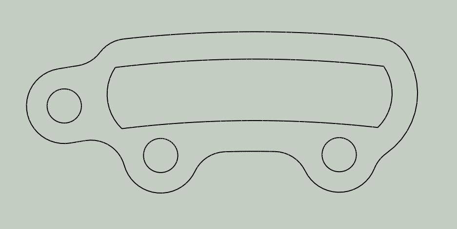

                          Ultimately, you can make things with CNC that would be almost impossible to do with typical home workshop machines, so if awkward shapes are your thing then CNC could be considered a must. Conversely, simple but boringly repetetive stuff can be left to the machine (say a division plate), while you get on with something else.
                          Would you relish the thought of making a few of the parts in the above picture by hand methods?
                          I’ve got manual and CNC equipment and enjoy both disciplines, but for me, the appeal of CNC is because it’s a different way of working.
                          I like drawing the part that I want to make in CAD and then working out the machining strategy in CAM. It’s far more challenging (in an interesting way) than some would have you believe.
                          It is not just a case of loading a drawing into the machine and letting it get on with it – I would find that very dull compared to machining by hand.
                          Although it may seem that I’m trying to push you towards CNC to the exclusion of manual kit, I’m not. A lot of the time it’s quicker to mount the stock, skim the face and drill a few holes by hand than it would be to just draw it up.
                          I think I’m saying you might find a use for both!
                          Martin.

                                              Chris.
                                              Those are good examples of pieces that can be nicely hand machined, given by Andrew and Terry.
                                              There is a difference though when compared to my example and that is the number of straight edges in each one.
                                              Andrew’s looks to have five and Terry’s has six.
                                              They would both be good jobs to do on a rotary table and fettle with a file.
                                              The part I’ve shown has only one straight edge, the rest being blended curves and that makes it much harder to make by manual methods. It can obviously be done, but I thought was a fair example of using CNC to relieve you of some of the drudgery.
                                              Martin.
