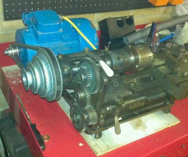

              heres a photo of the lathe when i bought it.
              you can just see all the gears and the two clutches.

                Just trying to ensure i got the calculations correct for if i know what TPI i want to cut. can someone confirm this? i guess its easier as i dont have many gears to chose from? we it makes sense to me! lol
                TPI that will be cut = 8 x Driven1 x Driven2 / 24 x Driver2
                simplified to TPI to cut = (driven1 x driven2) ÷ (3 x driver2)
                So 20(TPI) = Driven ÷ driver (so driven ÷ driver = 20)
                rearanged to be
                If no compound 20 x driver (3) = driven (60)
                Compound 52/32 20 x (3 x 32) = 1920 or 1920 ÷ 52 = 36.9
                so I could use spindle (24) driving 52/37 (or 36) driving 47 to give a 20.04 TPI with a 37, or 19.5 with a 36
                for a 1mm metric
                Compound 52/32 25.4 x (3 x 32) = 2438.4 or 2438.4 ÷ 52 = 46.89
                so I could use spindle (24) driving 52/32 driving 47 to give a 25.46 TPI
                I know these may not be useful threads, but im more after getting the calculations correct.

                  Lloyd, I haven't worked through all your reasoning, but you last calculation for a 1mm (actually 25.46 TPI) pitch is certainly correct. So is the earlier one where (without a compound gear) you arrive at 20 TPI.
                  It is a very longwinded business to work out what gears you need to use to get a particular thread pitch. Programs like Nthreadp are only really helpful when you have a pile of gearwheels and want to know if they can be set up to cut a particular pitch. They don't help much at all when you only have a few odd-sized gears and want to know which extra ones might usefully be bought to cut standard pitches, or close approximations to standard pitches. As you said earlier, 3 is the magic number where inch threads measured in TPI are concerned. The 3 derives from the 24 teeth on the first driver divided by by the 8 TPI of your leadscrew, and means that for inch threads you need a set of gears where the tooth count increases by three, like the one I suggested. As an aside,if you had a 40T gear on your spindle, you would need a set in increments of five (40 ÷ 8 = 5).
                  However, help may be at hand. If you load the seven gears I suggested (24 to 42T in increments of three), plus another 24T to represent the one on your spindle, and also a 63T, and then try to find combinations for the standard metric pitches of 0.8, 1, 1.25, 1.5, 1.75, 2, 2.5 and 3mm (those being the metric coarse pitches for M5 up to M27) you will find various combinations offered with 24T as one of the drivers, and all within 1% error.
                  So, I suggest eight gears: 24T to 42T in increments of three, plus a 63T. If you want to get at the finer TPI pitches, you will also need a compound pair with one having twice as many teeth as the other.
                  Two last points:
                  It doesn't matter in which order the gears are assembled, as long as the ones specified as drivers are drivers and those specified as drivens are drivens. From your point of view, this means that where a compounded pair is needed (driven by your 24T spindle gear, and driving another gear on your leadscrew), it doesn't matter which of the drivens forms part of the compounded pair and which goes on the leadscrew. Swapping them can help when it comes to the practicalities of assembling the geartrain on your banjo (aka gear quadrant).
                  Gaps can be filled in with idlers, but bear in mind the reversing effect of each additional idler you add. Of course, this is of no consequence if your lathe has a tumbler reverse, which you can set so the leadscrew rotates in the direction you want.
                  My brain cell has got tired with all these sums, so I'm going for a pint.

                      with your help ive compiled what i can cut with upto 2 compound gears. but there doesn't seem many useful pitches, a couple of metrics, so i defiantly need to look for more gears as you mentioned above andy!
                      Can someone tell me what they normally accept as within tolerance?

                          Lloyd, I reckon that for simple "hold things together / nut and bolt purposes" it's OK if you are within about 1%. For example, over 6 turns, the cumulative error on your 12.1266 TPI thread will only be be about 0.005".
                          It looks as though you could get pretty close to 1.0, 1.5, 2.0, 3.0 and 4.0mm pitches, though the last one is coarser than the leadscrew so the gearing would be against you (but you could always turn the tables by handcranking the leadscrew so that it drives the spindle via the gears). You have nothing near enough to 1.25mm (as on M8 coarse) or 1.75mm (M12 coarse). Among the inch threads, only 12 and 20 TPI seem to have tolerably close versions in your table.
