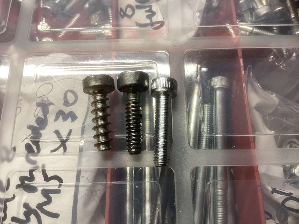

      The picture below shows three types of screw thread commonly used on Stihl equipment.
      The screw on the right is just a standard M5x0.8. The one on the left is a screw for plastic of the Plas-Tech variety.
      The one in the middle is the one that is a mystery to me. It is the most common type of thread used on Stihl machinery, and typically it is used whenever a screw enters an aluminium casting. I would like to know what it is because I would like to be able to reproduce that thread. Most of this type that I have come across have a major diameter of approx 5mm, and they are designated by Stihl with a D, (as opposed to P for the plastic ones).
      They are relatively expensive to buy.
      IMG_0977

          I’m not so sure that’s the reason, Bernard, in this case, though Stihl certainly do like to discourage servicing and repair outside of dealerships.
          The closest approximation of the pitch I’ve found is M5x1.25 (and it is close), but the helix angle appears to be different from a metric pitch thread.
          I think it’s actually a good choice of thread for aluminium castings as it’s harder to cross-thread a fastener, and maybe it better resists stripping generally in aluminium than an M5 coarse would.

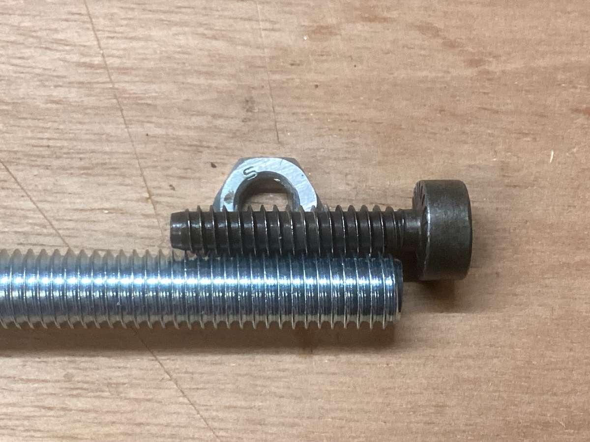

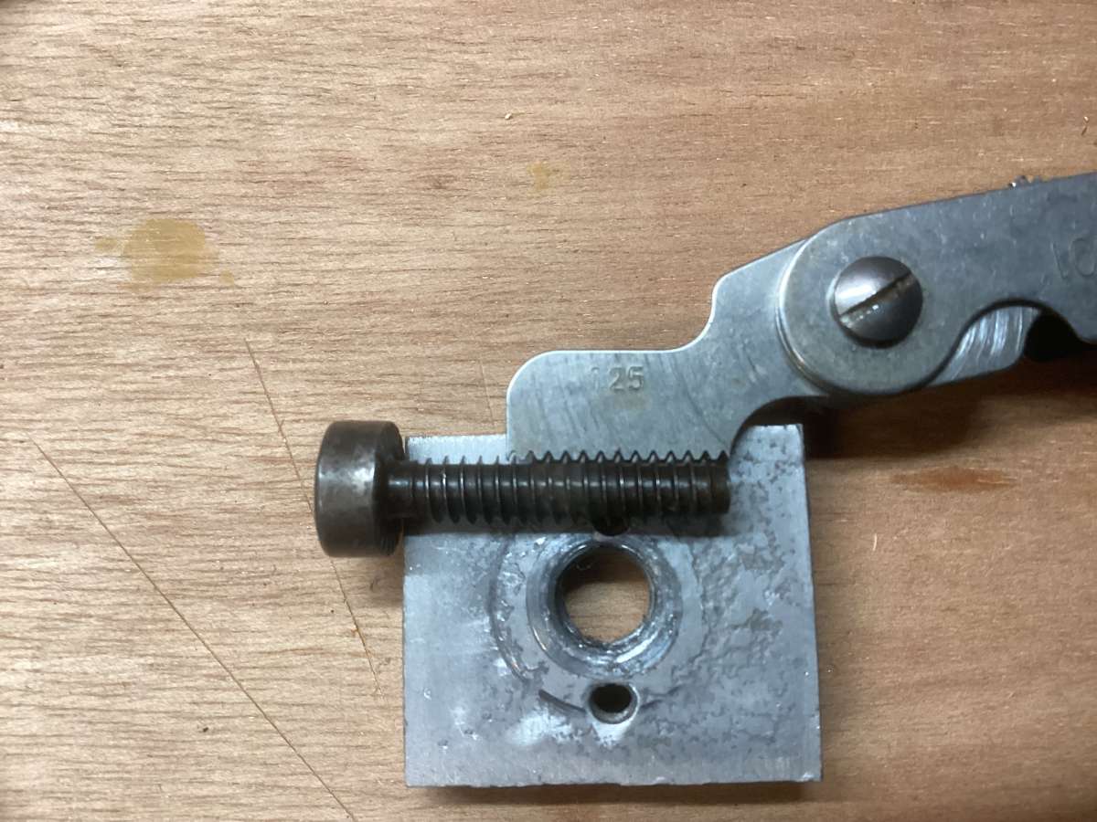

                                            I’ve attached pics showing a 1.25 thread gauge on the screw and an M8 screw beside it.
                                            There’s unlikely to be any tamper-proofing intentions here by the manufacturer. They’re regular Torx heads (T27), not Tamper Torx, and the self-tapping thread type is no doubt designed for speedy assembly on the production line combined with strong holding power.
                                            I don’t know what to make of the claim that standard metric screws might be usable in the hole after one of these screws has been in it. I’ll have to try it; I’ve got an old cylinder block in the shed I could experiment on. However, the problem is, even if this works, you may then be forced to use (and remember to use) a different screw from normal ever after in that hole.
                                            It would be good to have a stock of these screws so that I’ve got replacements or can easily do pressure/vac tests on engine/cylinder blocks and fit the necessary blanking plates and/or adapters without the need to resort to stand-offs or cutting screws down.
                                            It looks, though, like I may have to just shell out after all on a dozen or so screws of various lengths at £1+ a pop.
                                            IMG_0981IMG_0982

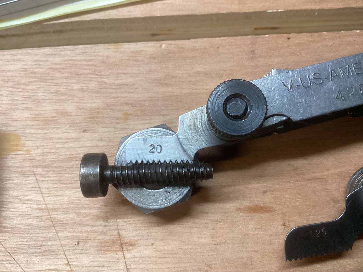

                                              Neil, the pic below shows a UN 20TPI gauge on the screw.
                                              The 1.25mm is definitely closer.
                                              IMG_0983

                                                Thanks for the pictures with the thread gauges. Definitely 1.25mm pitch and not 20 tpi at all.
