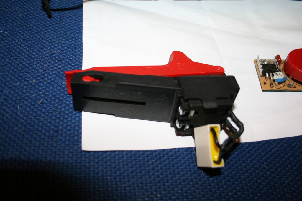

            Well chopping the wires to the variable speed and joining them up, resulted in a still non functioning grinder !! Cable has continuity..fuse is good .. Got to go out now , i'll test the switch and windings later !

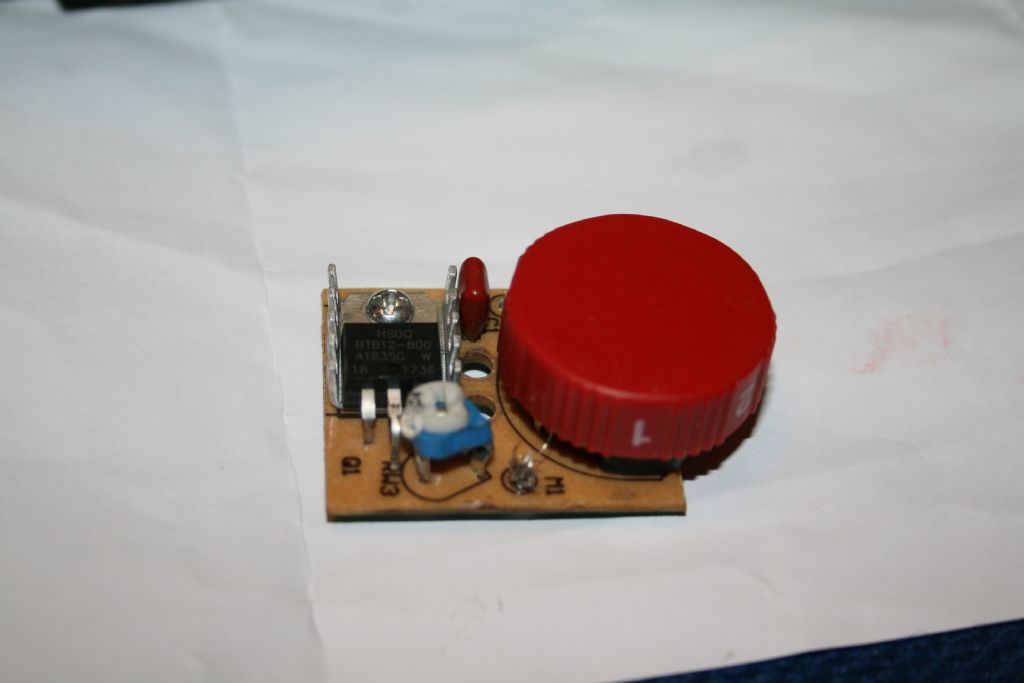

                  The Lidl angle grinder failure .. Having bypassed the revver upper bit ..(assuming it was dead) Still it wouldn't work .. I was expecting it to run at full speed..lidls grndr 001.jpg
                  I checked the cable and fuse , they were ok . Spinning the motor by hand generated up to 35 volts on my cheap digi meter , so i assumed the motor was ok too .Which left the on /off switch.

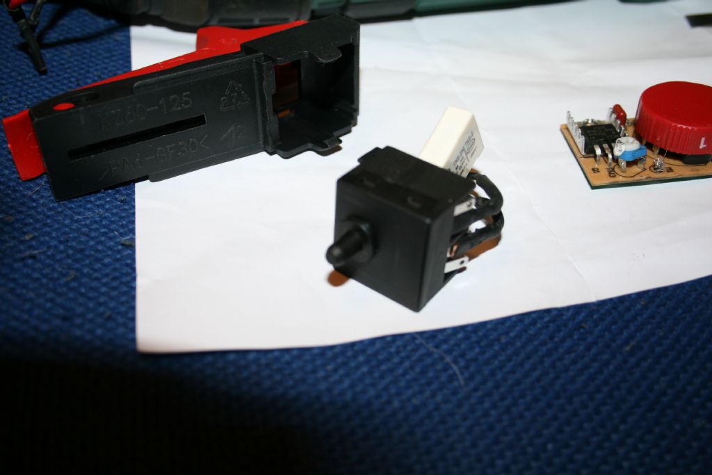

                  I wasn't going to test it with mains electric , so i flicked the tester to ohms and hooked it up to input and output.. The neutral side didn't register anything upon pulling the trigger…but the live did.. So a switch fault ?? I removed it from the housinglidls grndr 003.jpg

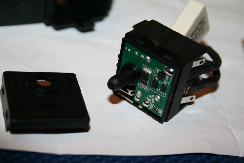

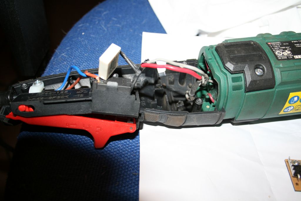

                  I took it apart , to fix it … it'll be a simple 2 pole ….And I'm afraid it's beyond me , as that's full of electronics stuff…!!! Soft start and quick stop circuit I suppose ? lidls grndr 005.jpg
                  Would i buy another ?  Absolutely !  I have three others and they're great .. but i won't be running them on a genny. I know i could take it back and they'd refund me, there's 2 years warranty on them but I'll keep this one for spares for the others should  I burn one out..
