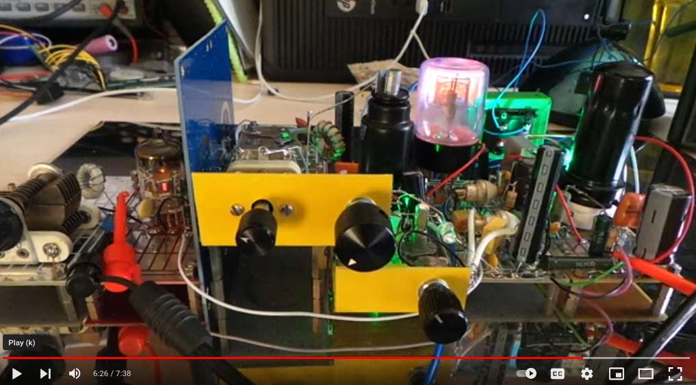

I’m fascinated by your 14MHz valve receiver.
I guess the circuit extreme left is a pre-amp, and that on the far right is the audio amp. The glowing bottle in the middle is a voltage regulator. Much less confident of the rest, or even the operating principle. Is it a superhet with a product detector or what? The audio sounds nice and crisp.
I’ve given up radio operating because my home was chosen to be near good schools for the kids and for a reasonable commute to work for self and wife. Disastrous radio location: it’s in a village with overhead power lines, and the shape of the garden makes it impossible to put up a decent antenna. People hear me, but they’re swamped by noise. Very sad!
Yes, it is a superhet but with a regenerative detector. I like simplicity. Actually the RF part has only two tubes. The mixer and the detector. Here is the story how I designed it (google translated)
Well, it depends how you look at it. It can be just another challenge. My most successful radio activity was when I lived in Munich where the antenna was just a 15m wire hanged from the balcony to a tree. RF ground was the building metal rebar structure. I talked with people from Scotland to Crete on 3.6MHz. That is where the random wire (together with the apartment building) happened to have the best impedance matching 🙂 For reception is not unusual to use a separate antenna for better noise performance. Could be an array to decrease noise because of directivity, or a magnetic loop, or an RF noise canceling adapter.

… Is it a superhet with a product detector or what? The audio sounds nice and crisp.
Well, it depends how you look at it. It can be just another challenge. …
Every 5 years or I have a burst of enthusiasm and have another go! It’s a receive problem. Last time I installed a LZ1AQ loop in the loft. It’s a double loop that can be configured remotely in 3 combinations, one of which is far less noisy than the others, but still not good enough. I get out OK with less than 10W to the transmit antenna and a few milliwatts of WSPR is reported too. Unfortunately any replies are well down in the noise and difficult to make out. On CW I report 299 QRM rather than 599! And that’s a genuine strength 9, not the usual ham fiction.
A big part of my problem is living on a street corner surrounded by pole strung power and telephone cables. Doesn’t help that the village is in a kind of bowl, which appears to block HF rather well. My receivers pick up more good signals on a wire thrown out the window at my mum’s house than they do on a better engineered antenna here.
The main issue though is radiated noise on the power lines. I’ve explored the village with a portable receiver hoping to find an obvious single source with no luck. It appears that everyone has a house full of cheap switch-mode power supplies and other noisy gadgets that couple efficiently into the power system. Filtering the mains inside my home makes no difference – the noise is on the antenna. Data modes are possible except I don’t enjoy them!
Thanks for explaining your receiver. I read the article with considerable interest. Despite claiming simplicity, that’s a novel design with several tricky challenges, and you made it work! I should have twigged it was a regen from the way you twiddled the knobs in the video! Love it. Apart from communications radio generally, I have a soft spot for valves, aka tubes, and now ‘lamps’. We are not alone – quite a few forum members are also radio amateurs or do radio control.
