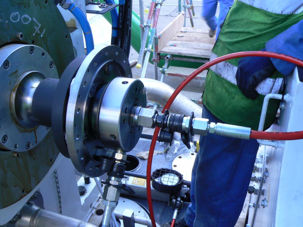

        I have designed tooling for fitting items as described by Nick. The drive shaft hub in the tooling is about 250mm diameter for an idea of scale.
        The light blue is the shaft, the dark blue is the hub and there is a hollow pancake jack (the brown item with a nominal coupling sticking out the side) to push the hub on to the shaft. Pressure was applied to the jack to bed the taper then oil was pumped down the centre of the shaft to oilways on the taper while the pancake jack kept pressure on the hub. We had to measure how far up the shaft the hub moved after bedding in to be sure it was on far enough. We used CEJN couplings to handle the pressures that went up to 28000psi.
        When the hub was removed there had to be a restraint system in place as the hub would otherwise shoot off at very high speed.
        The bottom right inset has an alignment hub (purple) shown that was fitted to align the machine then removed for the coupling hub to be fitted later. It was made by a company called Bibbys.
        The shaft taper was 1:20
        Martin C

          Found a photo of a hub similar to the one above being fitted or removed.
          Martin C

              Hi Martin C, thanks for showing your graphics and the method of fitting the hub. Never actually seen it done, but in my old job we had a machine that needed new bearings behind a pair of helical gears that were fitted in this way, we didn't have the gear to do it and it was cheaper to have it farm out to a specialist company than buy such for a one of and hey it was down to them not to mess up to boot, as it was a pricey bit of kit.. wink 2
              Regards Nick.
              P.S. couldn't remember the oil inject pressure, but 28000psi may have been a little on the shy side for the gears involved

                The couplings went up to 28000psi, the pressure to fit the hub was about 20000psi. There had to be a bit left above fitting pressure in order to remove them when necessary.

                  Hi Martin C, thanks for putting me straight on that. As I say I can't remember the exact injection pressure but 30 something thousand seems to ring a bell and the gears were solid, large and heavy, probably 40 to 50 Kg. each.
