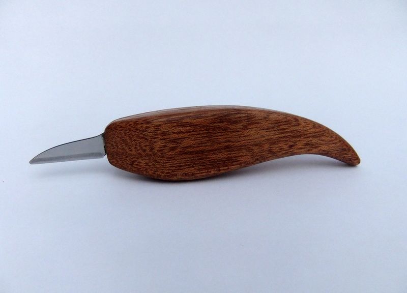

      I am in the process of hardening and tempering some hacksaw blades after I have worked them. I have heard that tempering can be done in an oven is this correct and if so what is the best way to go about it.
      The parts are smallish so if this is possible may be easier that heating with a flame to straw colour

          Light straw color indicates about 200C/400F so if you set your oven to that temp, let it get up to temp then bung the parts in the oven for long enough for them to reach ambient temp in there, it would be the same as heating them with a torch to that temperature.
          Just make sure your hacksaw blades are the carbon steel type with HSS teeth. I don't think you will have much luck heat treating the solid HSS type without precision temperature control. But I have never tried it myself.

            Thank you Hopper. Unfortunately the blade is unknown type as it is a cheap one from a saw I got second hand.
            I did make one some time ago but did not treat it in any way as i ground it so the cutting edge was from right next to the teeth. I say ground as it was a very slow process as I did not want to change the structure of the already treated tooth area so far it seems to hold a very fine sharp edge as it is for wood carvingdscf4408.jpg
