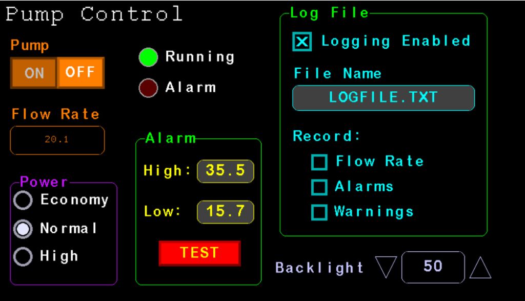

                              The most recent Picomite version supports a simple filing system and callable program 'slots' – all using the on-board 2Mb of Pico 'flash' memory (and accessible from MMB). So you can data-log very simply just using a Picomite. If you need removable or more data storage, then an external SD card can provide it, again fully supported by MMB.
                              I have just acquired a 2.8" Waveshare LCD touch screen (with SD card holder) that a Pico(mite) simply plugs into. The display graphics, touch controls, SD card are all directly accessible from MMB. No external "Libraries" are required – the device support is already there. The Waveshare LCD touch display cost me less than £18 and (when combined with a Picomite) can deliver a very complete compute solution (see sample test graphic below). Of course, a simpler Picomite 'data-logger' would work just as well for your requirement

                                          "All BASICs have shortcomings!" – I've been told that all LANGUAGES have some shortcomings Dave…
                                          "If BASIC were suitable for all purposes it would be widely used, and it isn't! " – Quite right but we don't need it for all purposes, just a few specific (embedded) ones and MM Basic does these very well indeed.
                                          "It's because BASIC languages have too many shortcomings for serious programming in a professional setting" – I'm sure that's right but my "settings" aren't professional and I don't have enough spare time to be "serious".
                                          "But apart from them knowing it already, I can't think of a good reason for recommending BASIC to a newcomer" – Well perhaps because someone has done such a great job of matching the software to the hardware and then documenting it so clearly. Or because MMB has a small but very enthusistic user group (many it would seem being software "professionals" ) that use and work hard to improve it.
                                          It's also a little misleading to link a Picomite to 80's 'tech' (such as the ZX80 etc) because it is very much 21st Century tech – both the Pico (hardware) and MMB. But if you crave "retro" there is a version of the Picomite(VGA) that generates VGA Graphics and supports a PS2 keyboard. It uses the second ARM CPU and one of the PIOs to seamlessly generate the video, whilst the other ARM CPU delivers the 'compute' bit – delivering pretty much the same performance as the (non-VGA) Picomite. Even in 1980, £3.60 didn't buy you very much – today it gets you a great deal…
                                          So, yes – the Picomite is a very specific tool but one that I find extremely useful. There's no point in telling me it's not suitable for this or that – I already know it's very good for the uses I put it to. I think others would find this too.
                                          Regards,
                                          IanT
                                          PS – Bob, as Robert has already suggested – a Picomite, SD card and 2 AA batteries (already got a breadboard?) would give you a simple way to check your DS18B20's and cabling. Use Geoff's code – just a few lines. Cost you about £6 to do. What's your time worth?
