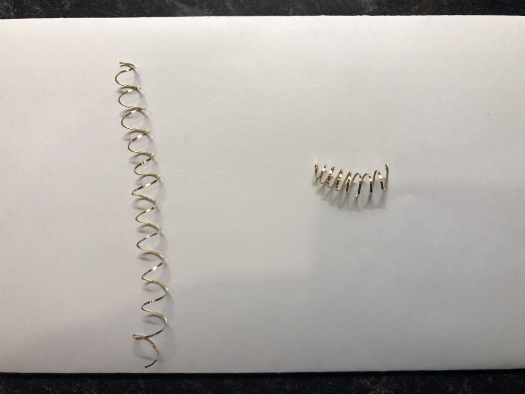

    Andy_C
      @andy_c
      I have just resharpened my tangential tool and achieved a good finish on brass but with spiral swarf. Is my sharpening not quite right?

        Howard Lewis
          @howardlewis46836
          A continuous spiral of swarf is indicative of a steady feed rate.
          If the surface finish is good on whatever material you are cutting the tool form is good.
          That is the deciding factor, not the shape of the swarf..
          A sharp Tangential tool should be capable of taking cuts of 0.0005" (0.012 mm) , or maybe even less, and then if it is within the lathe's capability, and rigidity, take a cut of 0.100" (0.25 mm).
          Just use the jig to grind the toolbit, when it needs it, until the cutting face cleans up.
          Howard

          Andy_C
            @andy_c
            Many thanks. The swarf just looked very different to what is was used to with brass with other tools and before I sharpened the tool. Many thanks for response.

            the artfull-codger
              @theartfull-codger
              I've had a tangential tool for years & use it for all of my plain turning,& facing but be careful of taking "bonus cuts" in brass unless you grind it with no top rake as it grabs.all my brass tools have no top rake.

              ega
                @ega
                Spiral swarf:
                In one of his videos Gary (Eccentric Engineering) mentions that he had ground a chip breaker into his tangential cutter; this would presumably yield separate chips rather than a continuous spiral.
                Increasing the DOC is also likely to break the chip.

                  Howard Lewis
                    @howardlewis46836
                    Have never had a problem using a Tangential Tool on brass!
                    If anything, a better finish than on steel, with a 0.0025"/rev feed.
                    0.025" DOC on Stainess produced nice long spirals.
                    Without regrinding the toolbit, this morning, took spring cuts on 1.250" lengths of Stainless, now 0.198" dia to remove the last thou (0.0005" a side ) The swarf looked like dust, but brought bit down to size!
                    Howard

                    Andy_C
                      @andy_c
                      Gary talks of grinding a flat on the top I think when machining brass. I will try and find John Haine’s earlier post ref zero rake and will also re look at eccentric site. Many thanks for responses.

                      Howard Lewis
                        @howardlewis46836
                        Try using the tool "as is" on brass, before doing anything drastic.
                        If it works O K, "It ain't broke, so don't fix it"!.
                        If it is set correctly, there is unlikely to be a problem.
                        The surface finish is as likely to be affected by your feed rate as by the tool.
                        Learn how to feed at a steady slow rate, to get a fine finish (One of the first things that we were taught as Apprentices )
                        With a Tangential Turning Tool, a Centre Height Gauge becomes a necessity, and very useful for all other tools.

                              IanT
                                @iant
                                I don't use my Diamond tangential on brass – just too easy to get a dig-in – which I most definately have had when I tried to do so. They were 'nasty' dig-ins too – spoiled the part, quite apart from frightening the bejezzers out of me.
                                Maybe my old S7 is not a 'typical' lathe in terms of age and wear – maybe a nice new shiney lathe would be just fine. But I certainly don't use my tangential on brass – and as it's pretty easy to grind a HSS tool for brass (with no back rake – just front/side clearance) it's really not a problem…
                                Regards,
                                IanT

                                Howard Lewis
                                  @howardlewis46836
                                  IanT
                                  I have used home made and Eccentric Tangential tools ( from 1/8 upto 5/16" )on my BL12-24 (manufactured may 2003, used since September 2003 ) on Steel, Aluminium and brass without any dig ins.
                                  I always ensure that the tool is set at centre height.
                                  A feed rate of just over 0.002" / rev usually produces a very good finish, cutting dry. Applying neat cutting oil to steel, produces an improvement, especially on stainless.
                                  It replaced a ML7. The BL12-24 is a larger, much heavier and more rigid machine than the ML7
                                  I hate to say it but has your machine slack gibs and a lot of backlash?
                                  Dig ins suggest that something is not as rigid as it should be.
                                  Initially with the Eccentric tool I had problems with chatter; solved by shortening the shank of the holder to reduce overhang to the absolute minimum.
                                  Howard.

                                  Andy_G
                                    @andy_g
                                    Posted by Andy_C on 18/01/2022 18:29:56:
                                    What grade of brass is it?
                                    I acquired a sheet of what I thought was brass (it looked like it), but I believe it’s actually aluminium bronze. It produced similar curly chips.

                                    bernard towers
                                      @bernardtowers37738
                                      I’d have to go with Andy G don’t think it’s likely to be CZ121. You can get curls with some tools on CZ120.

                                      Andy_C
                                        @andy_c
                                        It was supplied as as brass in a Bengs kit. Swarf produced on a facing cut.

                                        Andy_G
                                          @andy_g
                                          Actually, the stuff I have could well be engraving brass – if so, it machines very differently to "normal" brass.
