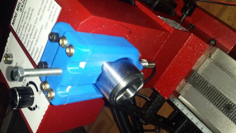

      Was not sure where to post this?
      Having recently bought the SX2p Mill from ARC one thing i didn't like was having to get the little tool to lock the spindle. Seen some ideas on the net, but mostly they are for the gear driven ones where they have a plunger on the top.

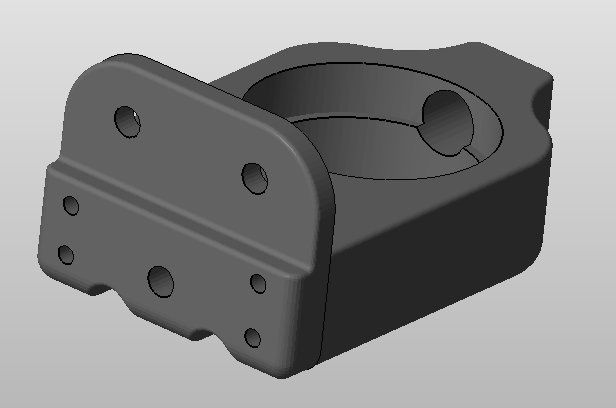

      Whillst doing the design in Freecad i thought why not include a rev counter also.
      The first thing i did to the mill was remove the plastic shield, ideally i wanted to use those. I came up with this..
      What do you think?

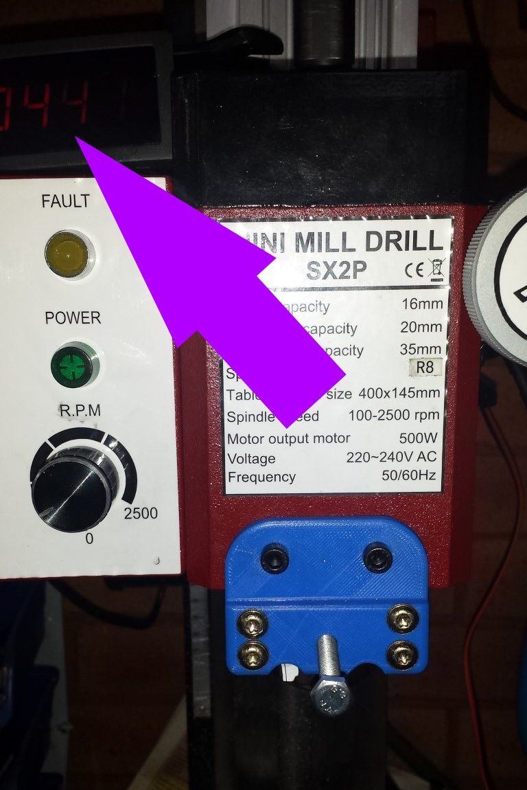

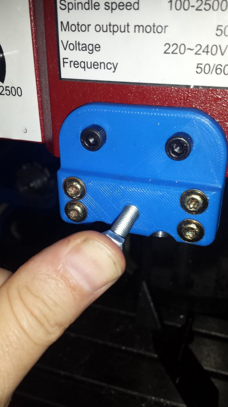

          And in practice, this is what came out of the 3D printer…. Sorry for the poor pictures, you can almost see the LCD RPM readout on the top. I have not made a case for that as yet. Its just perched there.
          Very little visibly wiring when its done, i may power it off an internal battery?
          Bolt on the front pushes in to lock the spindle, one thumb required, spring internally ensures the bolt cannot stay engaged. Just a temporary setup a proper hardened rod will be used.
          Rev counter probe fitted into the rear. Magnet glued to spindle, well in theory.. My glue didnt hold it?
          Mounted using the 2 guard fixing bolts. Not other holes required.
          Anything wrong with my setup? Have i missed something
          Thanks

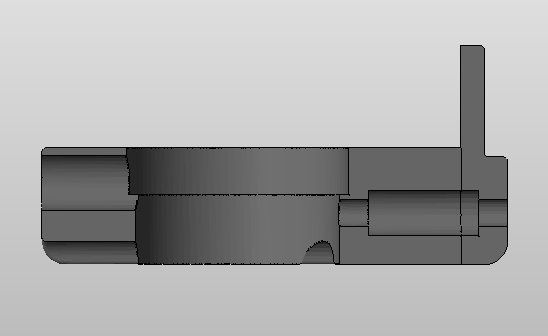

            Internally, The larger chamber on the right is where the spring sits.

                      My spindle lock tool sits on top of the control box, just where your purple arrow is pointing ( the drill chuck key sits there also). A small Manet will keep them there if you tend to misplace them.
                      Nice idea if one has a 3D printer……

                          Curious as to how well this performs for tightening/loosening the drawbar.
                          My main concern would be that the plastic might split by the two mounting mounting screws on the front, however my concerns may be unfounded.
                          If made available for download, the STL files would be good for the MT3 versions of this mill.
                          The R8 version, as sold in the US, has the spindle lock hole sllightly lower down.
                          I know this because I swapped my spindle from MT3 to R8 – here are the two spindles side by side for comparison:
                          The larger hole in the R8 spindle is for a pin to locate in the R8 slot – not supplied with the spindle, and more hassle than it is worth if fitted anyway.

                            Uploaded the STL to thingiverse. http://www.thingiverse.com/thing:2243811

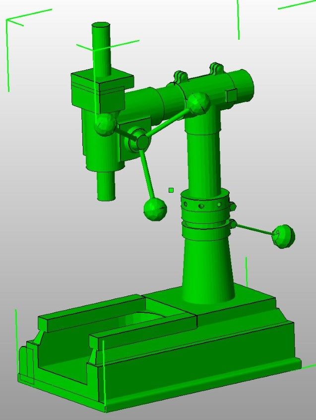

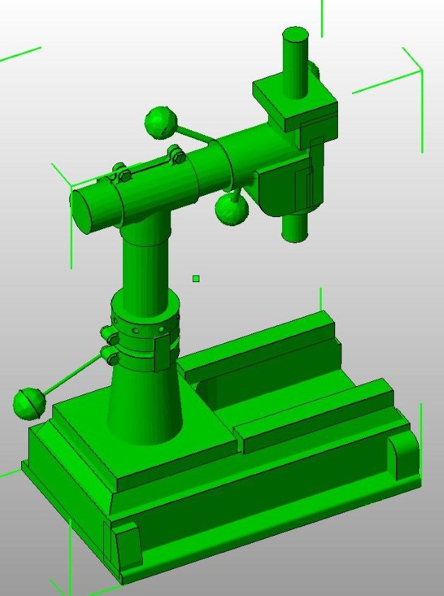

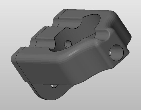

                                Having a play with freecad and just using the part editor with basic shapes got this.. Only working from images on a google search which is tricky because there appears to be many different versions.
