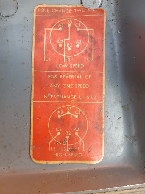

      Harvest has intervened, and my electrician has been hard pressed. So motor not wired, but it is installed.
      Please can I ask another question concerning the 2 speed motor wiring?
      Here is a diagram from the motor. Does the connection instruction for the High Speed, the lower of the two diagrams, imply that when L1, L2 and L3 are connected to A2, B2 and C2,, A3, B3 and C3 are connected together?
      I dont really understand how they are not connected together (for obvious reasons) in Low Speed, but are in High Speed. Does this have to be done in the switch? Thanks for guidance.
      #495723
      Emgee
        @emgee
        Yes Tom, that is the purpose of the speed change switch to link the 3's for high speed and remove the links when switched to Low speed.

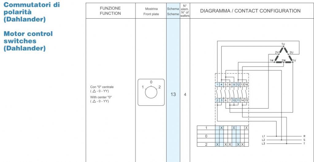

          I have the Broook Motors book on Induction Motors (my father worked for them his entire career).
          Pg 199 show precisely the wiring which Tom posted above. It is possible to wire up a star-delta switch to perform the two speed switching. Everything else can be left alone: the switch is interposed between the output of the existing contactor and the new two-speed motor. I can post a schematic if you're interested.
          There's a supplier in Italy selling a star-delta rotary switch at a reasonable price
          https://www.stockelettrico.com/products/14929-lovato-gx2012u-rotary-cam-switche-3p/

                    Having re-examined the Lovato switch data which I mentioned above, it appears that many of the change-over contacts are internally linked, so can't be used as such.
                    However, on the Lovato website there is a comprehensive list of their motor switches, and there is a three-postion pole-changing switch which does the job: it's schematic 13 and the switch reference is
                    GX1613U
                    There's one on ebay at the moment. You could tackle this with a cheaper / simpler switch but you'd then need additional contactors and both the cost & size would escalate.
                    I've scannned 40 pages of the Brook Motors book which include multiple motor configurations and the schematics of the old Brook control gear. There's a lot more data on their range of motors from the 1960's back, if anyone needs such info.
                    https://www.dropbox.com/s/z2g2r5ar6ojpkhr/Brook%20Motors%20data_1.pdf?dl=0

                          Just looking at Johns scan of the Brooks book.
                          Is my motor 2 speed (pole change) or 2 speed (dual wound).?
                          I presume from the red wiring diagram I posted, attached to my motor, that it is Pole Change, because of the linking together of A3, B3, and C3.
                          #496069
                          Tom Walker 1
                            @tomwalker1
                            Sorry, I posted too quickly, I can see that it is Pole Change.

                                                    I think Tom has this sorted . We've established that it's a pole-change two-speed motor, which required a slightly specialised switch to be interposed between the DOL starter & the motor.
