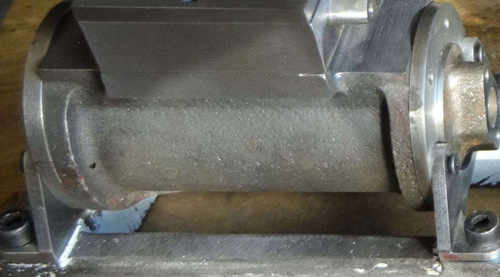

                Set both beds up aligned to the mill base:
                Checked for height of the pads:
                Then bolted the feet on:
                And placed the cylinders on the feet, with the valve faces clamped nominally flat with a parallel:
                Idea is to use the mill as a primitive CMM, to check the positions of the cylinder centres and valve faces (edges and top faces) before bonding & bolting to the feet.
                A quick visual check with a pointer indicated everything was OK. I’ll do some more accurate checks tomorrow on the valve faces, then get the JB Weld out again. I think with the enlarged foot holes and final machining of everything to the finished bores, I’ll have more than enough wiggle room to get everything perfect when it’s eventually assembled (which seems a very long way in the future at the moment).

                  Looking ood Doc but can I offer a suggestion before it's too late.
                  I have found that it's much better to build the engine up on a solid base board – and preferably the one you intend to display it on from the outset
                  The reason for that is that as you build the engine up any slight misalignments are catered for as you go. When you strip it down for painting there is little to affect it as you rebuild it whereas if it's been built 'off its base' it more than likely will not seat on it's new base with the same freedom. This especially so in your case with two separate engines that need to be in perfect alignment for the best result and particularly where the crankshaft is concerned.
                  Thats based on personal experience with the Waller engine – I built the engine on what I thought was a solid temporary base. When I assembled it after painting on it's proper base I had issues with the crankshaft alignment. Since then I have done as suggested to eliminate that possibility. It certainly paid off with the Corliss engine.
                  Just a thought but one worth considering before you get too far down the road

                    Ramon, yes it says something about that in the article, but I assume it’ll apply more to when the crankshaft and flywheel get fitted? I think most of the cylinder/valve gear/sliders etc could be assembled onto the beds before worrying about alignment, or did I miss something? It did mention alignment of the main bearings almost certainly needing shims.

                              Can anyone see anything wrong with this, before I remove the centre plugs? I’m a bit concerned about it moving under load. I’ve put some paper under the top plate, but can’t do much with the other interfaces without adjusting the centre height. I suppose I should de-grease all the interfaces? I don’t want to use excessive clamp force in case I distort the bores.
                              Cheers.
                              #555676
                                Only thing I can see is that you look to have lined things up based on the pop marks in the wooden plugs. Are these true to your feed which have been fitted to the base and 5/8" up from the feet?
                                I also assume you are going to go with Ramon's suggestion of machining the cylinder ends on a mandrel, if not move the packing so you can flycut one end at the same setting as boring and that the piston rod end if facing the headstock.
                                Clamping should be fine.

                                  Thanks Jason. Yes, as I mentioned after the last image, I’m going to machine the ends afterwards, on a mandrel – as per Ramon’s advice.
                                  The feet were JB Welded to the cylinders with everything set up on the beds, on the mill. I was able to confirm the centres on the mill after clamping, so I’m confident the feet are very close to height and flat already. This seems to be confirmed by checking the lathe centres align with the plug centres, as per the first two images.
                                  Did you mean true to “feed” or “feet”? You mentioned both.
                                  If anything is out, it can’t be much more than 0.5mm from the marks in the plugs – I can’t detect any centering error visually.
                                  Is there a way of double-checking overall longitudinal alignment? I’ll check the 5/8” height.
                                  Cheers.

                                            Hi Doc, can't quite understand why you've drilled and tapped for the 10 ba screws after the feet were JB'd in place?
                                            Set up for boring looks fine but I share your concern of it moving under load. I would if possible re think that clamping as it's never a good idea to rely on a single clamp.The action of tightening those bolts as you have it will tend to bend the clamp plate across the cylinder
                                            You could consider making that top clamp a single one from one side and put two others on the feet on the other side. A thin slip of paper under those feet both sides will improve matters considerably. You have a lot of sliding surface potential so you need to be as sure as you can be before cutting commences as your first cut needs to get under the skin and as such will need to be a decent one.

                                              Thanks Ramon, I’ll see if I can fit more clamps, or re-arrange, but there’s not much room there.
                                              I assume the bolts are there as a mechanical backup if the Araldite (JB Weld) cracks? Therefore the order they are fitted isn’t that important. It says in the original instructions to clamp the feet to the cylinder, then drill, unclamp, then apply Araldite and final assemble. All I’ve done is added the JB Weld at the clamp stage. I figured that there would also be no gaps at the interface that could have made drilling a bit tricky, and that JB Weld would be way stronger than Araldite.

                                                It's always best if a clamp can apply a single downwards pressure on a solid spot beneath rather than as you have it. One – it will be much firmer as it applies pressure to something solid and two – it wont tend to distort the casting – not so much an issue with a sturdy cast iron casting but especially important if it's gunmetal or aluminum. Several small clamps are always much more secure than one large one. Sometimes theres no choice but to use an unsupported surface as you have but there should always be reinforcements if possible.
                                                My very first lesson on a one clamp set up, a Stuart Turner hand pump casting left the faceplate/angle plate set up as soon as the tool touched on. And when I say left – it went over my shoulder like a rocket narrowly missing my ear and the corner of the base actually embedding its self in the door surround. Yep – really!
                                                If the JB 'cracks' or parts something would be seriously wrong with it! The bolts could have been there in the first instance to help locate the feet while the JB cured but will have little structural effect if fitted after curing takes place. Still they are there now and won't do any harm.
                                                I try to use the JB as a structural 'part' of the finished item as opposed to using it purely as an 'adhesive' – a heavy chamfer around both curved edges of the cut outs would have allowed the JB to form an internal fillet as well as an external one with a much stronger end result for little extra effort.
