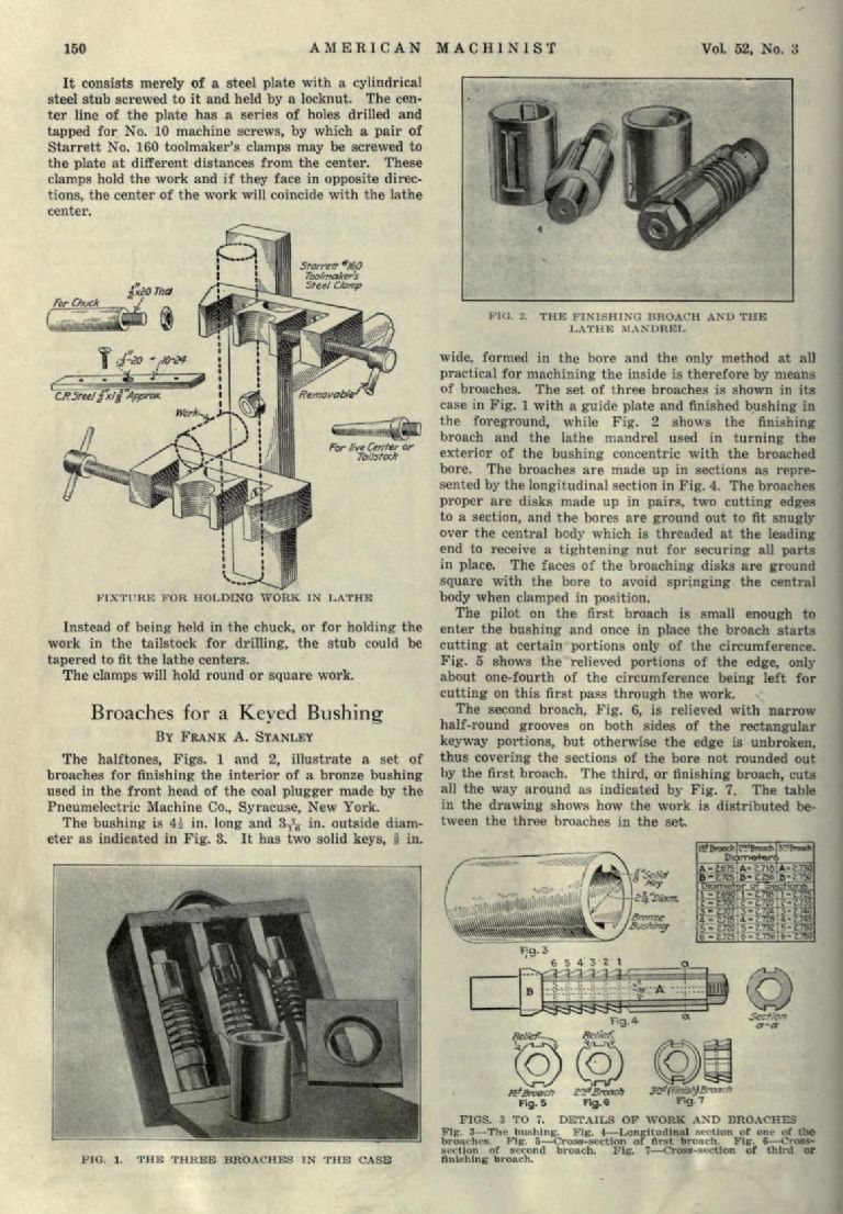

        Hi whilst browsing through an old Starrett catalogue I came across these Tool Makers Clamps
        They are something I've not come across before and as they looked as if they could be a useful bit of kit I did a bit more research, and found out that Starrett still market a version of Chinese manufacture at about $60 each.
        Starrett did sell them as a matched pair which would make them even more useful I've since found out that Brown and Sharp sold something similar but they had a V along the bottom so they could be used as a small V block
        Has any one come across these before and have they got any experience of using them ?.
        I don't think it would be to difficult to make a matching set.

            Usually one or more on E-Bay at something approaching respectable price. But the small clamp plate is almost invariably missing.
            Never encountered a genuine Starrett but have seen a similar device or two of clearly less quality. Possibly shop made. Despite looking OK were quite unpleasant to use as both work and vice spacer wanted to escape until locked hard down.
            On reflection probably deceptively difficult to make as the screw needs to run really true to the base and the end stop be exactly perpendicular to it. Similarly the faces and screw end receptacle in the clamp spacer need to be correctly aligned. Wants a good finish on the working surfaces too. I'd be unsurprised to discover that the screw is a bit above centre on the clamping parts to produce a bit of push down force.
            Looks to be one of those "get it right third of fourth time jobs". Might well be easier to amen the ends to bolt down onto a plain bar. Weaker but you can concentrate on getting each end-block really true with a nice finish. And if the screw hole wanders a touch when tapped its easier to correct or, at worst, a lot less to scrap.
            Maybe a nice shaper project.

                  I have a pair, and find them quite useful. Not shown in the drawing above is the countersunk hole through the bed that will fit a #10 (and presumably 2BA and 5mm) flat head screw for attachment to another object. I have used them in the milling vise and drill press vise for machining small bits, and in the bench vise as an instrument vise.

                    I was a little puzzled why they are described as clamps then I realised that they didn't' have the tong, groove and keep to stop the jaw tilting, so I guess that's why they call them clamps, and not vices, because of this I think you must have to use them differently to keep the work square. I'm still thinking about the best way to configure the screw:- on centre, above, or below, what I do think though is that it must have quite a sloppy fit to allow it freedom to tilt and push the work up against the square fixed jaw and keep the work square.
                    I had a good look at the ones on ebay and the odd ones show signs of being modified.
                    Jason I did buy a pair from Uncle Ketan but was disappointed to find that they were far from being a matched set but to be fair to Ketan I didn't stipulate that I wanted a matched pair.
                    I've come to the conclusion that they would be most use as a matched set, so I've drawn them up as a pair tied together with some spacers plus I've put a groove down the side for clamping and I've left the end square I'll also add a V on the inside of the jaw for round bar and I'll put a V goove along the bottom of one so that it could be used as a V block not quite worked out a clamp for this yet.
                    Her's whot I've roughed out. Don't know when I'll get round to making them as I'm busy making the motion bracket for the loco I'm building.

                            Idle hand and all that, when the cold spell drove me out of the shed I did a little on line search on the archive.org site and came across some old 1900 ish publication called American Machinist https://archive.org/search.php?query=american%20machinist
                            And low and behold I came across these ideas for using the clamps.
                            Be warned that the link comes with a warning you can easily lose a couple of days of your life browsing it.

                                          One of the Starretts, using the shallower movable jaw, makes a cracking good carriage stop for a Myford Series 7 lathe. Turn the clamp over, lay the inside bottom on the front way and tighten against the outside shear. Solid!
