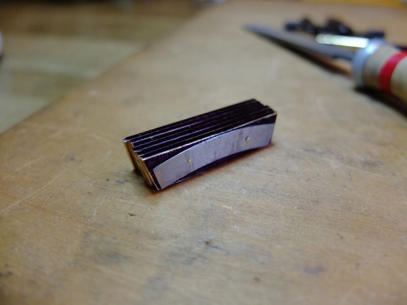

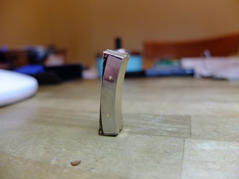

      On occasion, I've used old Stanley knife blades to make filing guides and gauges. After annealing on the gas cooker, they can be filed and drilled with ease.
      I've enclosed some pictures of 2 pieces temp riveted either side of 6 x 2mm brass flat for filing.stanley01.jpg
      My question is, does anyone know if they are a simple high-carbon steel or something more exotic? Can I harden and temper them?
      Also, does any one know of any other frugal sources for flat high carbon steel? Preferably something a bit bigger and thicker than Stanley?

          That's a good idea.
          How about 'disposable' hand saws as now standard on building sites.
          #298866
            If you can anneal them like that, you should also be able to harden them.
            I like the Wickes bi-metal ones, cheap and they keep an edge longer, even on carpet.
