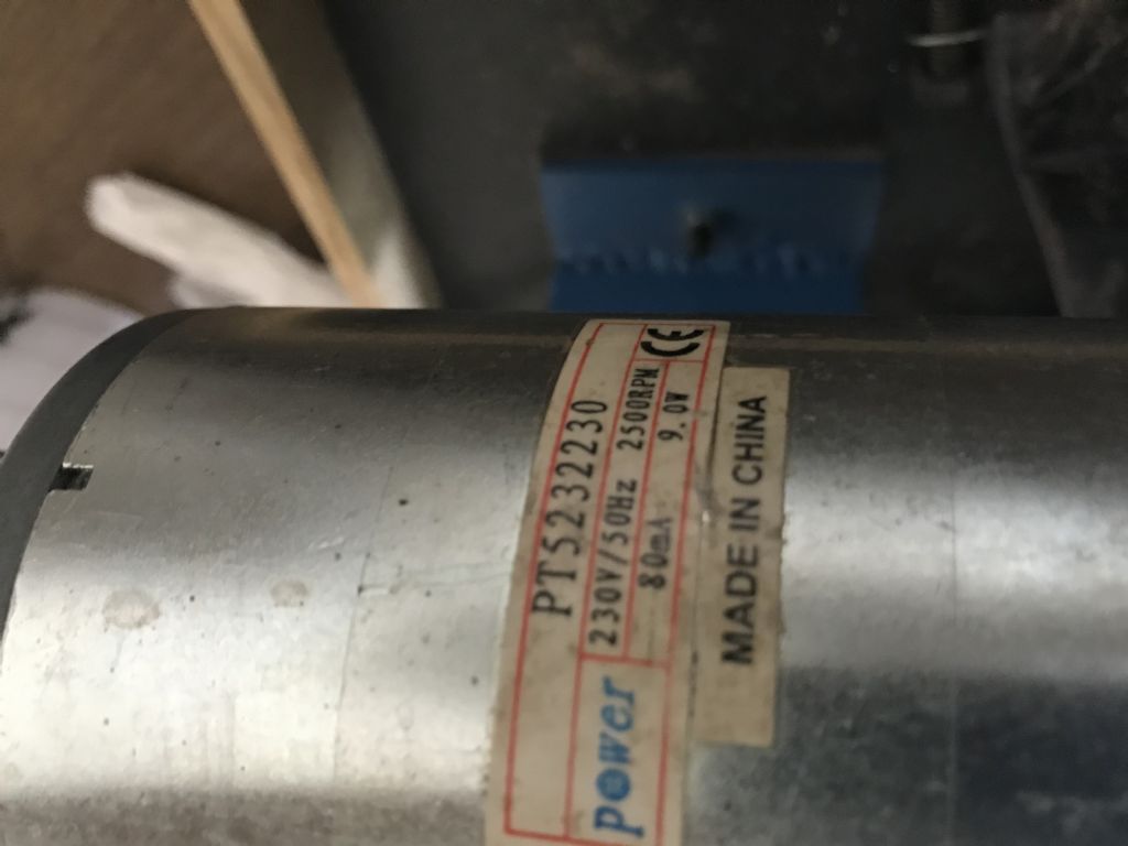

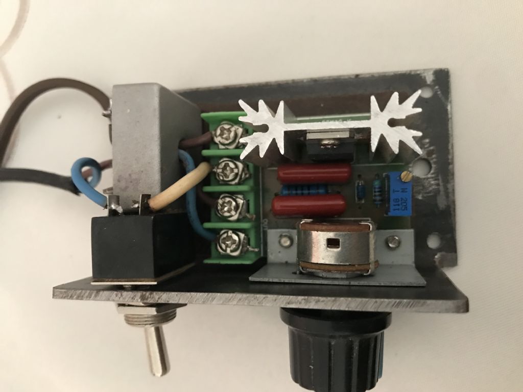

      img_3365.jpgimg_3368.jpgHello friends, I have a tiny homemade lathe. There is the following motor on it and I use this motor with dc voltage with pwm driver and bridge diode. But I want a cleaner dc voltage. Ready-made drivers are very expensive. Is there a circuit I can make? By the way, I do tube radio repair as a hobby.

          I am assuming that is a universal brushed motor, as it's marked for mains AC power, but you say you are running it on DC.
          Why not as a first (cheap) step simply smooth the DC output of your existing power supply. If you repair tube radio's you probably have a suitable choke and some reasonably big electrolytic capacitors with an appropriate voltage rating in your bits box.
          All the commercial circuits will be the same basic design as the one you have – the cost just reflects the level of smoothing applied to the output. Making one yourself will almost certainly cost more for the components than you can buy a ready made one for.

                Duncan, it would if you used a simple capacitor, but a smoothing circuit consists of a series choke (inductor) or resistor followed by the capacitor. The inrush to the capacitor caused by voltage spikes (or on start-up) is "dropped" across the inductor/resistor and if appropriately sized should give no problems.
                Dave – I would agree that it should be unnecessary, but he was asking how to "clean" the DC.
                Looking at the controller he has I suspect it is one of the cheap brush motor speed controllers available for <£10. They are not true PWM controllers (which usually run at high frequencies) but simply half wave rectify the incoming mains then chop each cycle short to give output voltage control. I have one I use to speed control an old Black & Decker drill . It works fine but has "ringing" spikes in the output on each half wave that cause a significant hum. I assume that is what he is trying to clean up.

                        Looking at that circuit board, I'm with Peter Cook – it isn't a "real" PWM controller, but a variable phase angle thyristor circuit: basically a dimmer switch. It will operate at 2 x the AC supply frequency, rather than the tens of kHz that a true PWM would use.
                        To make a true PWM, it would be necessary to rectify and smooth the incoming AC, then design / copy a control circuit running at PWM frequency (with its associated power supply) to drive some power switching semiconductors that are capable of handling ~400V (xx3055 isn't it!) Ideally, there would be an isolating transformer in there somewhere too. Not impossible, but not a trivial task, either.(And there's the business of making sure it doesn't radiate interference to everyrhing around it).

                          Try running the motor directly on 230v AC without the controller in the way. It will run at full speed, if it still runs noisily, you have a motor problem. If on the other hand it runs at full speed fairly quietly, then the noise you are getting is an artefact of the waveform generated by the PSU.
                          If its the latter I would at least try a simple low pass filter. Put a series resistor ( 5w 50ohms which will limit current inrush to about 5A) in the positive line and then a 500v 100µF capacitor across the +/- lines. That should supress frequencies above about 40Hz and give you a smoother DC supply.

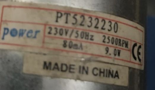

                            #611755
                              Quick question :
                              Does the ‘mains’ information on that rating label actually make sense ?
                              … or is it really a 9volt DC motor ?
                              #611758
                              Steambuff
                                @steambuff
                                Think that might be 80ma – 9.0W @ 230V/50Hz

                                  If the controller is as others suggest a triac, then it outputs AC in a chopped form. Might be a bit iffy putting electrolytic capacitors across it, and I'm not sure what it would achieve. Might it be possible to full wave rectify the mains input to the controller, or the output, then a low pass filter with a choke

                                    Posted by Steambuff on 30/08/2022 13:06:29:
                                    Mmm … a better photo would clarify that
                                    #611768
                                    duncan webster 1
                                      @duncanwebster1
                                      250V at 80 mA is 20W input, so 9W output sounds about right for a little motor. Here's a link to someone selling the motor. If you google translate it it says 'working with bridge diode' so my earlier worries about electrolytics are probably unfounded

                                                  Friends, I gave 220volt ac to the motor, but the motor did not run. When I give dc voltage with pwm and bridge diode, it makes a sound like DINNN. someone install a 24 VDC scooter motor to emco lathe.for you is this better.if I use a 24VDC scooter motor, can I control easy VDC with 3055.

                                                  #611938
                                                    Posted by ŞABAN �ZYAZGAN on 01/09/2022 06:54:31:
                                                    Friends, I gave 220volt ac to the motor, but the motor did not run. When I give dc voltage with pwm and bridge diode …
                                                    That suggests that the motor itself is DC only, and that the bridge rectifier sometimes supplied with it **makes it useable [and presumably reversible] on AC
                                                    Further investigation [and maybe dissection] required, methinks !
                                                    **  see the photo in the post by Andy_G
                                                    Edited By Michael Gilligan on 01/09/2022 08:21:54
                                                    #611949
                                                      Posted by Michael Gilligan on 01/09/2022 08:14:48:
                                                      The motor may have been an unlucky choice for Şaban. Although labelled as an AC motor, it appears to be DC, a suspicion confirmed by it sometimes being supplied with a bridge rectifier. 9W output is small for a high-voltage motor, so my guess is the motor is normally used to drive the turntable of a microwave oven where rectified mains AC is an easy option. However, the need for high-voltage DC makes a variable power supply for speed control difficult. A Triac type is likely to vibrate the motor badly, and a PWM might be audible too.
                                                      I'd change the motor for one that matched a low voltage DC controller but much depends on what Şaban has available. Quite cheap if the parts are in one's junk-box, pricey if they have to be bought new.
