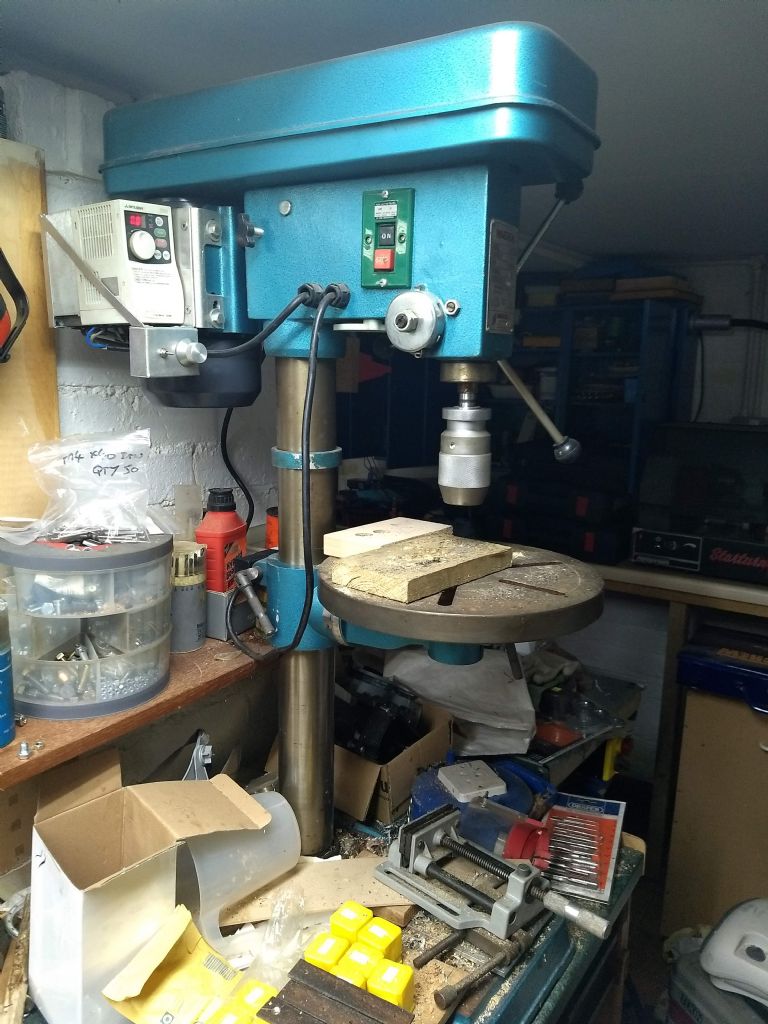

                              Gary Wooding
                                @garywooding25363
                                1850w is a very big motor – about 2.5hp, so it must be a pretty hefty drill-press. My Naerok drill-press is only .55Kw, which is more than powerful enough for me. However, I too wanted slower speeds than the belt drive allowed so I replaced the 1ph motor with a 3ph equivalent and fitted a VFD. I've now got variable speeds and instant reverse with the twist of a knob and touch of a switch.
