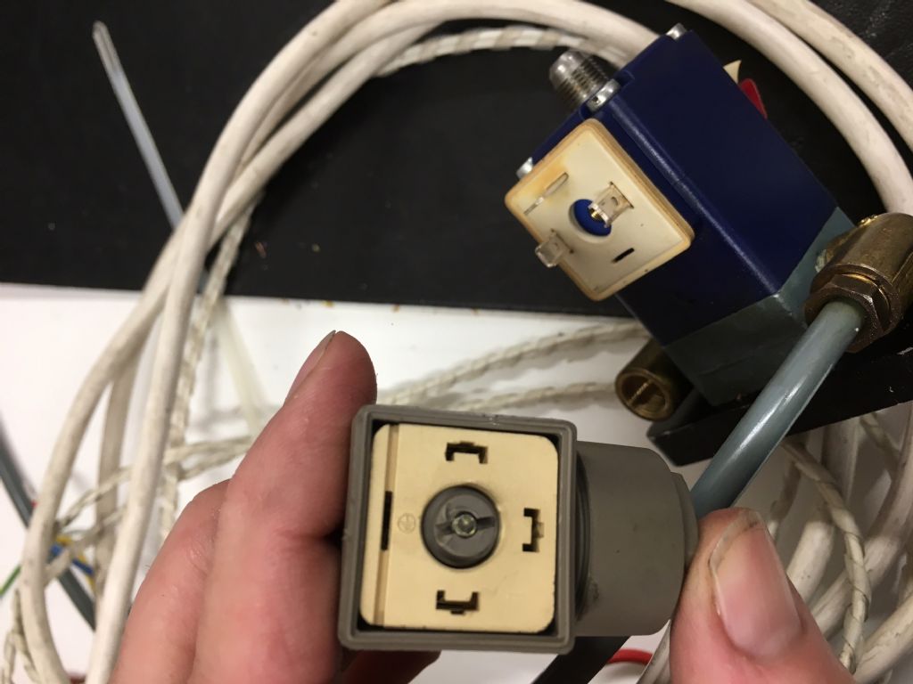

      I need to reconfigure the pneumatic solenoids in my CNC machine. These control the rotary pneumatic actuator for the spindle gear selection and the power drawbar engagement piston.
      The fittings are 1/4" tube with a 7/12" thread from what I can see (this is a 1980s machine). It has plastic tube which I assume is Nylon or similar. The olives(?) can't be reused so I need to obtain some new ones and I may need some new tubing. The solenoids themselves (labelled "Schrader Bellows&quot appear to be fine so I should be able to reuse them. I've seen stuff like this before, so I assume it's an industry standard to some extent.
      Pneumatic solenoid
      I'm no expert on these systems and the first step seemed to be to identify likely components, so I looked on the RS site. Yeh yeh, I know that isn't the ideal place to source stuff like this on many fronts but even so, I wasted about 1/4 hour trying to find the simplest part. It seems that what I believed to be an "olive" is actually a "sleeve". WTF?? Silly me.
      So – firstly is it me or are they really called sleeves? And more importantly, could anyone recommend somewhere for me to obtain fittings? I don't need vast quantities but I'd like a decent selection to choose from, half reasonable prices and good, fast service. Probably not RS then.
      Murray

          Murray, I still call them olives, and I have a tin full, however there are a few variations in shape depending on whose fittings they are to fit. I have loads of Enots olives. One of the popular makers were and still are I suppose, Enots, and I have a tin full of fittings as well. if for example you wanted some 1/8" BSP elbows with nuts and olives for 1/4" tube I can help you. Nowadays one would be using push in fittings, with 6mm tube instead of 1/4". If you wanted to update to that I can help you too, provided we are only talking a few. I may have some tube as well. PM me with a more detailed list of what you need and I will have a look.

              The fittings look like they are "Enots" quite common before the modern push in variety. Each individulal part was sold seperately
              Google throws up some suppliers still listing imperial sizes.

                              Yes, they really are called sleeves **LINK**
                              https://www.imi-precision.com/uk/en/search/q/sleeve
                              It's logical enough: 'Olives' are olive-shaped, and these are not.

                                      You will find a useful Norgren catalogue here: **LINK**
                                      http://www.thoritedirect.co.uk/download/493d-9a89-8f20-41cb-78a5-553e-0898-9087/
                                      The 'Universal Tubing Sleeve' is illustrated near the end of the document.
                                      P.S. … it appears that the RS price is about standard:
                                      http://www.thoritedirect.co.uk/products/fittings/imi_norgren_fittings/enots_brass_compression_fittings/34_imperial_series/sleeves/imi_norgren_enots_imperial_compression_fitting_tubing_sleeve_metalnylon_tube/

                                          John, I think Muzzer meant to type 7/16", the 1/4" tubing nuts are a ball hair under 7/16" O/D.
