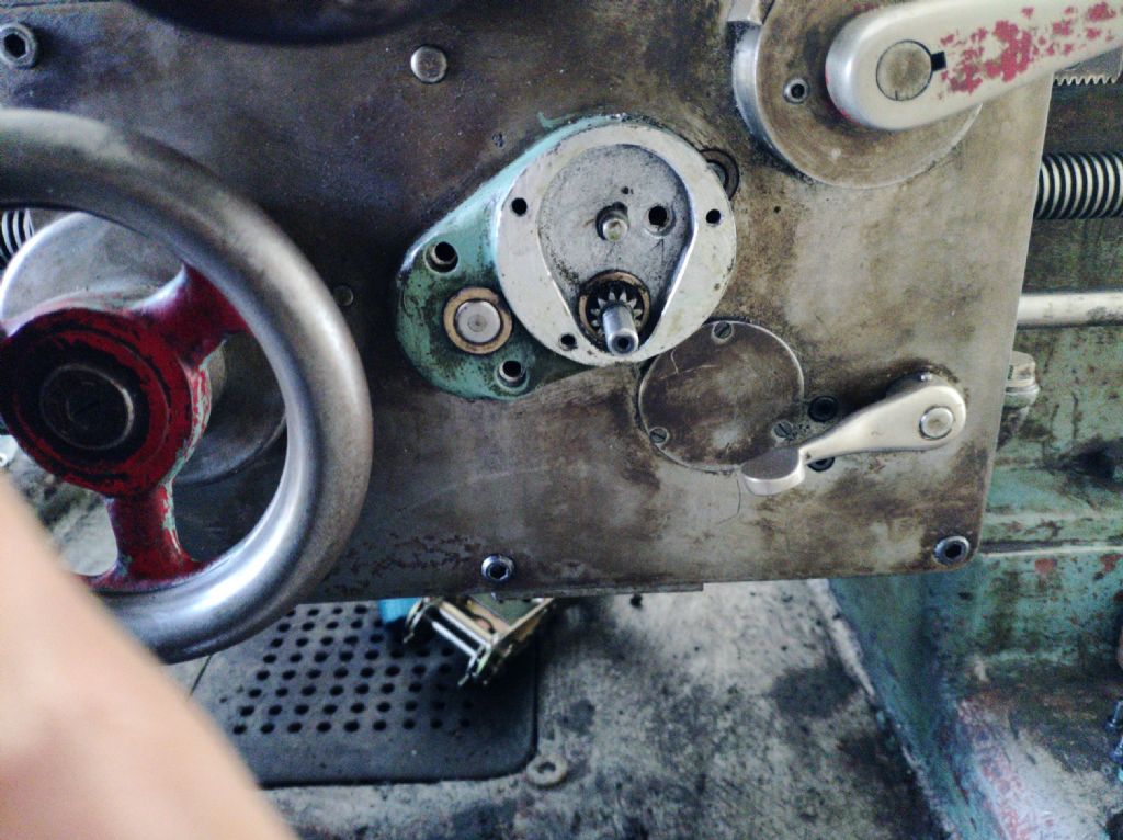

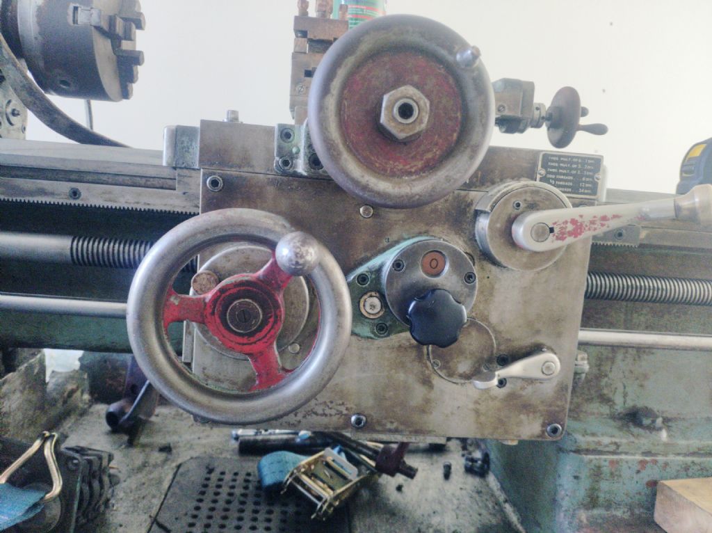

      I have very recently acquired a Smart and Brown Model A. Having only previously used a Drummond pre-B this is quite a significant machine to me. I've been wiping the crud off and exploring the functions, however I've come across a problem and am not sure if there is something amiss in the apron or if it user error. I cannot get the fine feed / cross slide feed to engage:
      The fine feed bar feels like it rotates freely (when not selected at the headstock), regardless of the position of the lower right lever. I also cannot get the black surface facing knob to move, there's a tiny amount of play but it won't rotate, I'm stuck with the 'O' showing in the window.
      My guess is that a gear or keyway has broken and the feedscrew won't engage with the rest of the apron, although I'd still expect to be able to wiggle the black knob around, possibly while feeding the crosslide, so I'm not sure…
      Does anyone have any suggestions?

          First off make sure the half nuts are disengaged as there is an interlock to prevent the power feed and screw feed fighting each other. Then the black knob should rotate to either the left or right to engage sliding feed or cross slide feed. It may need some movement of the carriage or cross slide to get it to engage. There is a detent to overcome to turn the knob as well. Once rotated then the other lever (not the half nuts lever) needs to be moved to the working position to make things move.

            Hi Martin, thanks, I did give that all a try already, gently wiggling all the slides and also the leadscrew and fine feed 'screw' while attempting to turn the knob and also while engaging and disengaging the fine feed lever. I also tried turning the knob as hard as I could by hand but it wouldn't budge.

                        I tried slackening the bolts through the top of the saddle and wiggled things about with no change. I removed the black handle, the play I felt was only in the handle, the shaft doesn't seem to turn at all. I assume that the casting behind it comes off but it didn't want to budge from a gentle tap.

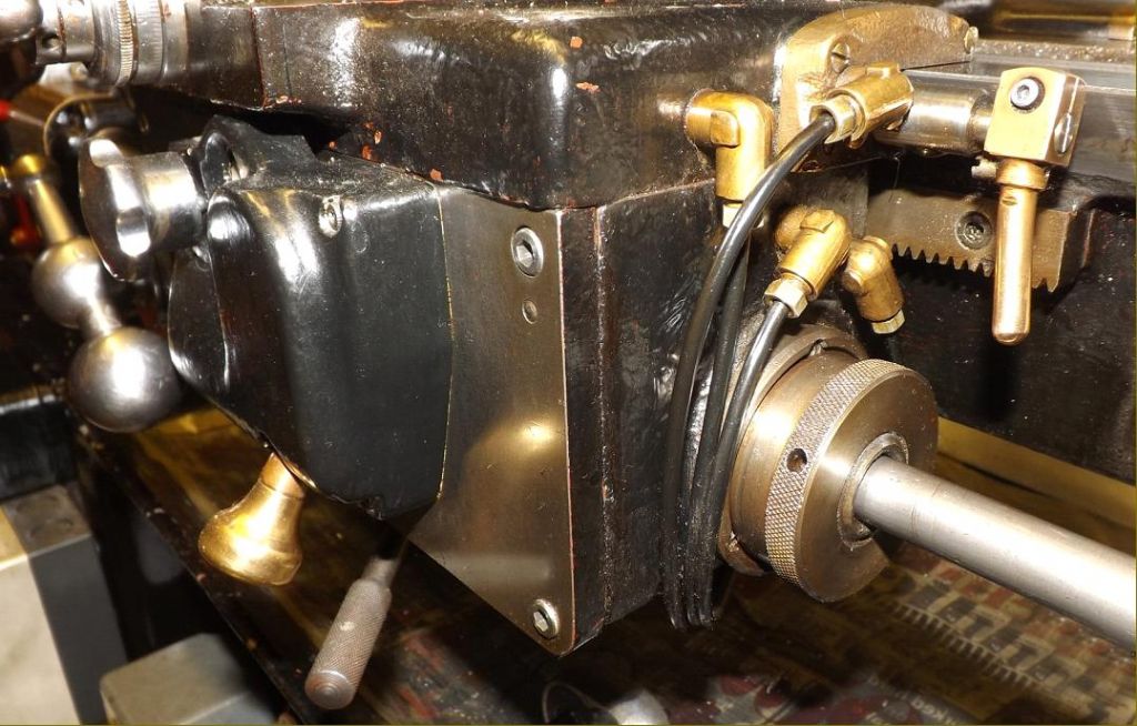

                          Remove the leadscrew lever, one grubscrew, woodruff key and slacken off the threading dial friction adjuster (that grubscrew shown in the picture, then remove the dial). Remove the fine feed lever (taper pin small end at bottom). Remove the main wheel and woodruff key which moves the saddle. There are 5 SHCS holding the fromt on and when they are removed, carefully use a thin blade to work it off the dowel pins. The 2 dowels are top right and bottom left. If you do need to remove the plate at the bottom, make sure that the front lefthand screw is the short one, as it intersects with the screw holding the front on.
                          Post a picture of the mechanism.

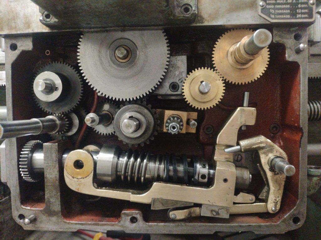

                                Hi, sorry it's been a while; I've still not taken the apron apart but will soon I think. I've got a stack of original manuals and parts drawings and a brochure for the Model A, I'm happy to scan them to a pdf and upload if that's allowed and there's a demand for them.
                                I've also found the sheer pin on the first change gear had snapped when I looked under the cover, so need to make/source one.

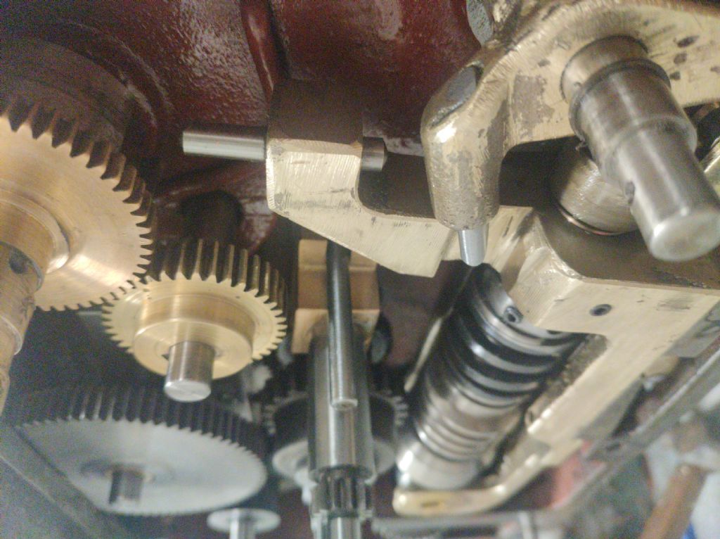

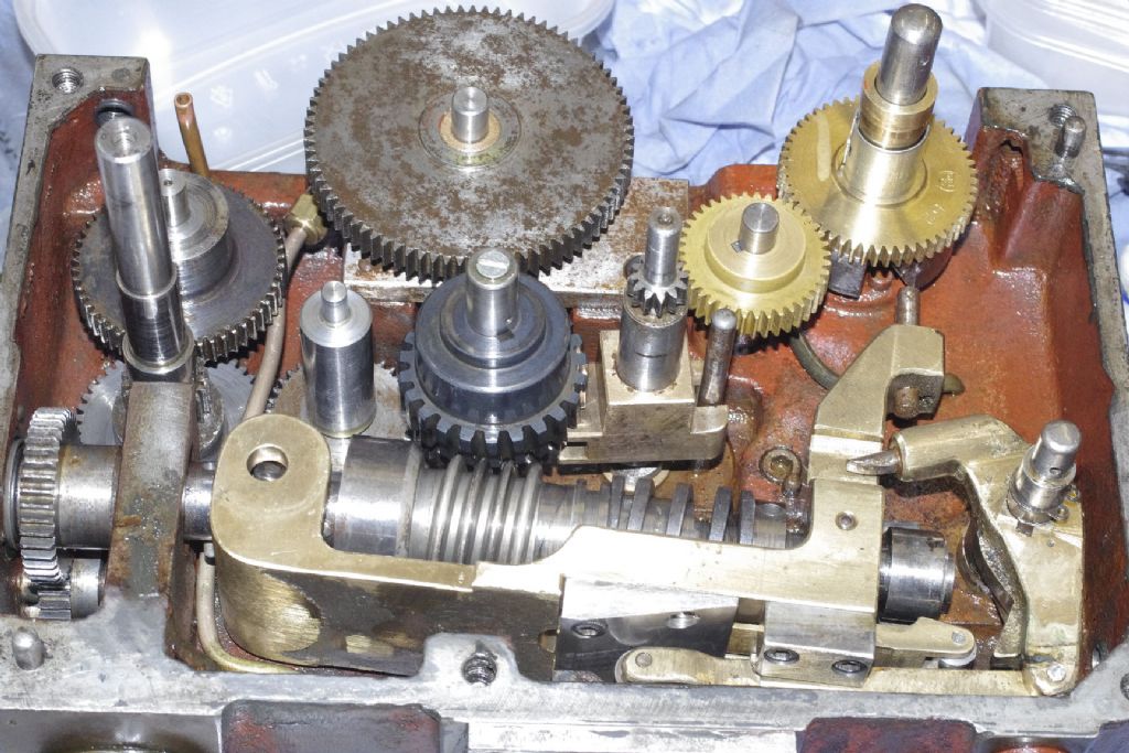

                                    I finally returned to this after quite some time as I was doing some cleaning on other parts of the lathe and stripping my mill spindle (thanks Old Mart for your help in that thread!). The inside was filthy, without about 1cm of gunked up oil with shards of bronze and steel mixed through it. I think the pump on mine is working as I get a smear of filthy black oil over the ways when moving the apron back and forth. The brass dog on the gear selector was stuck solid, presumably glued by the dried out oil. I removed it, soaked in WD40 overnight and then took it to a vice with grips and freed it.
                                    I've cleaned everything a lot and it's now looking pretty good, ready to go back together! I haven't run the lathe under power yet so not sure if the clutch works, I didn't get a micrometer stop with the lathe anyway. I've got a bunch of other problems to solve which I'm working through as I do this 'functional restoration' of the thing, not sure if I should start a new thread or keep asking away in this one.

                                      The ends of the shafts look unworn, I had to make some new ones as well as rebush everything. The trip mechanism to the lower right is a nightmare to get working properly, our lathe at the museum actually works after 15 years. The adjustment is very old school, all knowhow and no easy adjustment. You ought to remove and clean the pump while the lot is dismantled, it is lower left, with a cover plate underneath.
