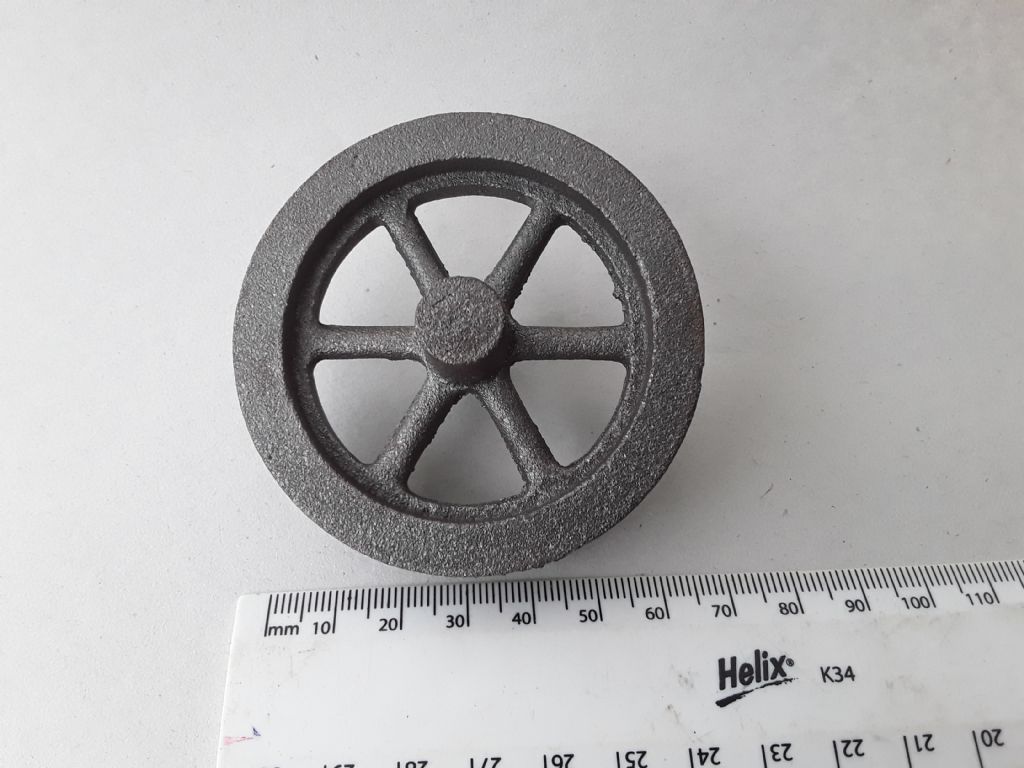

      Hi All,
      I'm looking for a small cast iron flywheel but having tried all the usual sources am unable to find what I want.
      Ideally cast iron, five or six straight spokes, between 50 and 60 mm diameter with a face width of 8 to 10 mm. 75 mm diameter is too big.
      Best I can find is the stuart progress flywheel at 2 1/2 " but that seems to be unavailable from them at the present time.
      Reeves have a gunmetal one for the nicholas engine. This has curved spokes and would be ok but I would prefer cast iron.
      Can anyone help, many thanks in advance

                  PM Research in the USofA make a range of flywheel castings. Might be worth a look.
                  #356063
                    Atelier do a 50mm but due to the problems of casting thin spokes at that size in iron means they look a bit heavy.
                    Can always use a bit of steel tube if you want the bare rim to look like cast and just solder in some spokes and a hub which is less sawing and milling than cutting from iron bar.
                    Or take a Mamod one and turn down most of the rim then stick it into a "rim" or steel or iron with JBWeld
                    These one are soldered up, 50mm dia

                        Bronze do you? https://www.pmmodelengines.com/shop/gas/gas-accessories/flywheel-castings/ good price at six quid too – probably more for the shipping from US though. They also have slightly larger at 2-3/8" and aluminium option.

                              @geoffwalker1
                              Hi All
                              Well I now have the flywheel I was looking for, bought from Stuart models last week.
                              It is the one used on the progress model and should machine down ok to my upper limit of 60mm.
                              It's not listed on the Stuart website on the flywheel page but is available to buy separately.

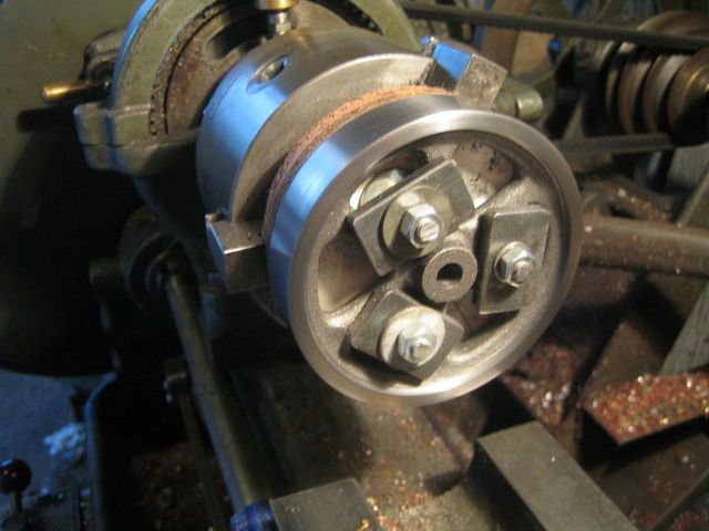

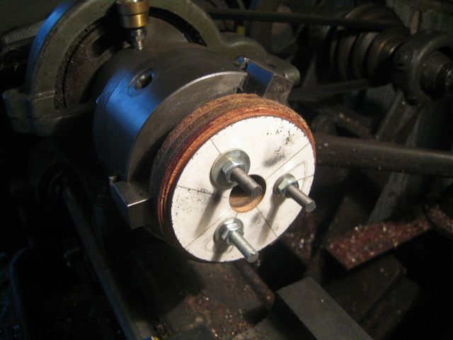

                                #386245
                                geoff walker 1
                                  @geoffwalker1
                                  Hi All,
                                  With reference to the last post, I bought a Stuart flywheel.
                                  A little smaller at 3 1/2" but should do the job.
                                  Not sure how to hold it for machining as there was not an extended boss in the centre.
                                  Used the method shown below. Perhaps a bit long winded but worked well.
                                  The plywood disc has a square shoulder turned and the diameter is a snug fit on the inner rim of the casting, tapped it on with a copper mallet up to the shoulder.
