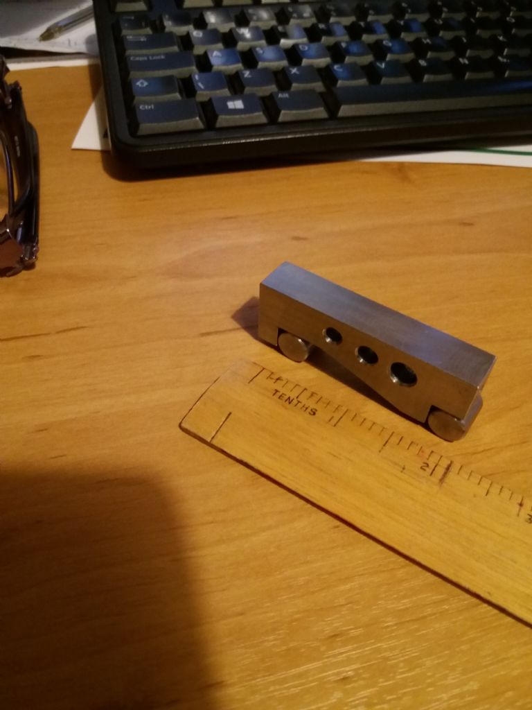

      Just made a replacement Sine Bar to replace the one that I used to have. The original was a 2 inch X 1/2 inch size but the new one is 45 mm as I had a piece of 50 mm x 12 mm ground flat stock and that is the biggest I could make it. The original was borrowed a few years ago but in a vice it is so useful.

          Looks good, I made a sine table to mount on the milling table.

            Looks very good, as you say very useful in a vice. I made a two and a half inch one some years ago. Also when I operated a wire eroder I made a three inch one from 8mm ground stock.

                I bought my first one (a 100mm one) only six months ago after seeing a piece on them (I forget where) and suddenly discovering how very useful they are for setting angles precisely. As result, I bought a set of slip gauges to go with mine at the recent Warwick show. Combined with a test bar, I can now set my topside for turning tapers practically spot on first go.

                  Tom Lipton has a good video on YouTube called What's My Sine? about making a quick and dirty sine bar that is probably accurate enough for most purposes made from a parallel and a couple of bearings.
                  He also shows an even simpler one made from a piece of wood and a couple of nails to prove a point about how accurate they can be even when made from such simple materials.

                    I was recently given a sine bar by my brother in law so I bought a set of slips off ebay. Easy to use on the surface plate or milling table but (directed at Chris) how does one go about using them to set the topslide – advice would be gratefully received.

                        Roderick,
                        Being a bit of a hammer and chisel worker, I would try the following.
                        (You may need more than both hands!)
                        In view of the length of four way tool posts (if using QCTP You should be able to clamp in a holder) clamp a parallel in the Toolpost. Against this you then hold (or clamp?) the Sine bar (assuming a 5 inch, rather than Ten) and the slips. (Teaching Grandma to suck eggs, Don't forget to include the protective slips at each end of the pack).
                        With the top slide unclamped, press this set up against a fairly substantial parallel round bar (Silver Steel?) held in the chuck. When the Topslide etc has moved into good contact with the bar, clamp it in position.
                        You should then be ready to put away the Sine Bar, Slips, and parallel bar, ready to start work on a test piece to confirm that all is well before starting work on the actual workpiece.
