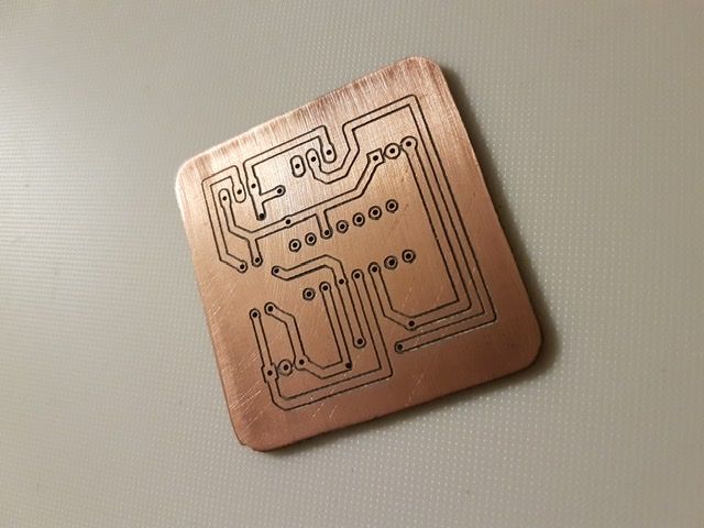

      I recently bought a cheap 3018 CNC router. After looking at various suggestions on this site and others I have used Eagle, Flatcam and Candle to make my first small pcb using this method. It took a bit of experimenting but came out ok. I used the Heightmap feature in Candle which seemed to work ok.

          That looks like a pretty good PCB.

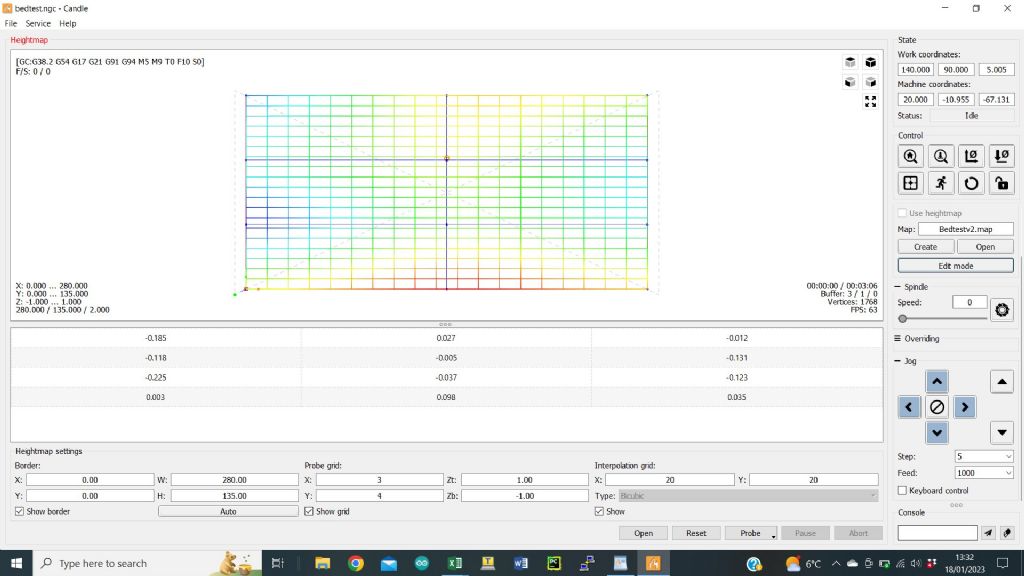

            Even when you have milled a flat plate the board may be bowed or non-uniform. You can correct this by probing the board when mounted using a simple conducting probe to measure the deviation and correct the g-code for depth. There's software around to do this.

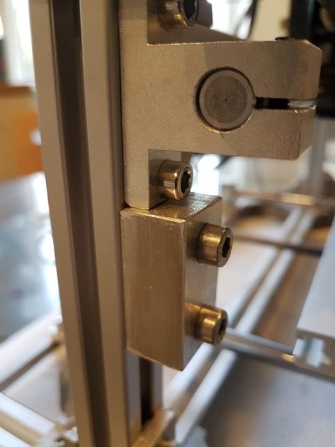

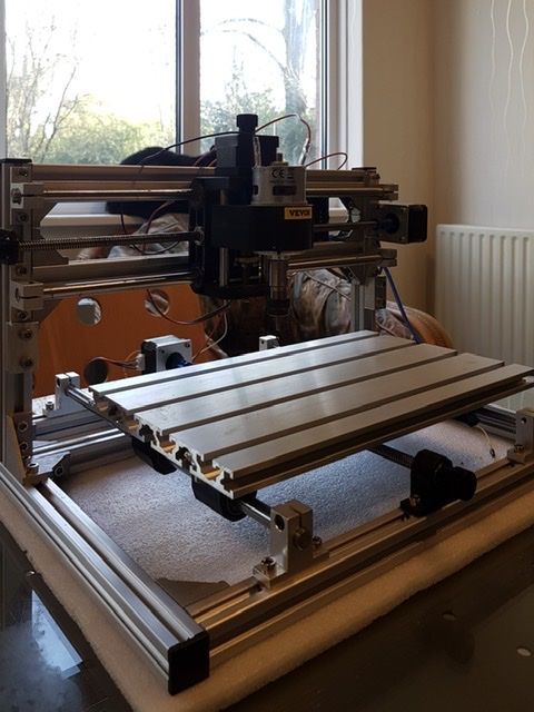

                Peter
                The router I bought is this one:
                With a bit of time, you can adjust it but it is still not that robust. I made a couple of aluminium blocks to hold the gantry in position, loosened the screws and used feelers to hold in position while I tightened everything up.
                I used the probe feature to test the spindle height above the table at various points. It is still not perfect, but using the Heightmap feature I managed to get it to mill the pcb ok using a v cutter.
                This is a screenshot of the Heightmap in the Candle software:
