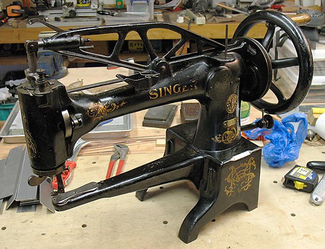

                    Here are some pictures to illustrate the repair in question:
                    This is the old Singer 29K-1 cobbler's sewing machine. Singer made thousands and thousands of these in various models. The same form of sewing machine is still produced by companies to this day.
                    That arm on top works in a see-sawing way, driven by a camway in the rear by the handwheel, driving the needle bar up and down at the nose end of the machine. None of your high speed stuff here.

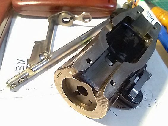

                    The cast head of the machine with the needle bar lying next to it.
                    The needle bar out in full view. It looks simple enough, but there is no way for me to replicate this part, most especially because there is an off-center hole in it, running end for end through which the thread passes.

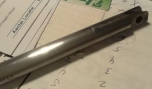

                    Here at the top end is the area of most wear. This is where the needle bar is pushed slightly away from the top arm during each cycle. The machine works, it does sew, but I'ld be happier filling in that bit of wear.

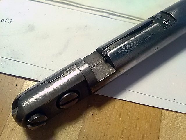

                    This is the bottom end of the needle bar. The lower screw secures the needle. You will notice a fine groove in the metal across that flat area. This has been worn into the steel by the passage of thread over time. At least here I feel comfortable putting in two or three tiny 'spots' of metal with the TIG welder to fill it in without causing undue harm. For an idea of actual size: those rather damaged screwheads on the top right in the picture are only 3mm in diameter. Micro surgery time.

                              The heaviest wear on the part measures a loss of 0.003" of metal. I'm assuming there must also be a slight loss of material from the cast iron bore as well, but I haven't measured that. In any case, haven't the machine tools available to do anything at all with that cast iron head
                              The wear on the needle bar does permit a bit more 'wiggle' than I'ld like, but considering that it is held under a bit of spring tension (in the direction of the wear) when connected to the top arm of the machine this may be of less concern than I'm fearing. The real test will be when the machine is reassembled and I start sewing with it again.

                                          Just a note to all. I finished the refurbishment of the old sewing machine. It is now back together and working like a champ.
                                          In the end, I elected not to try to resurface that needle bar with an application of silicon bronze. However, I did spot-fill that worn groove using my TIG torch after which I filed it down flat with some miniature die files. That spotting process with the TIG torch was so quick that the bar suffered no heat distortion whatsoever.
                                          It should be mentioned that I DID use the bronze surfacing technique on two other parts of the sewing machine. There, however, the parts do not move at the same speed. Also, they are more easily fixed and/or remachined if so required.

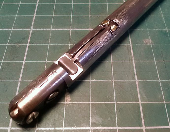

                                          Here you can see the needle bar with the replacement check spring in place..
                                          Thanks again to all for the suggestions and opinions. wink
