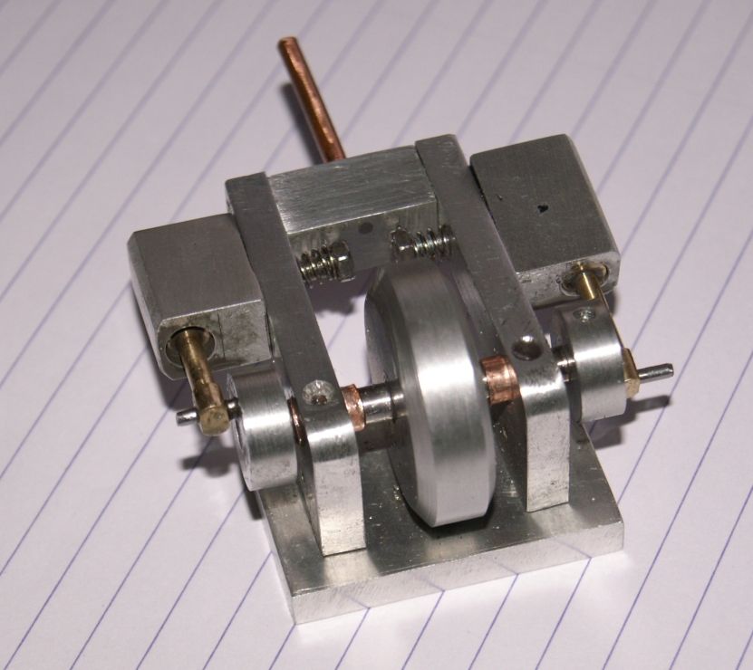

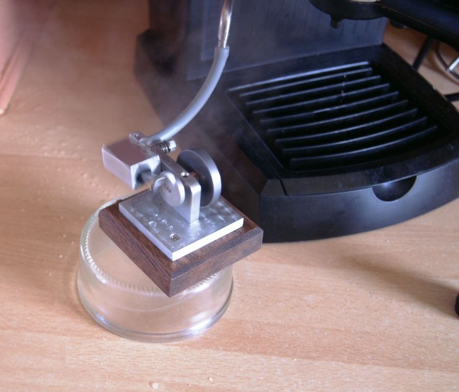

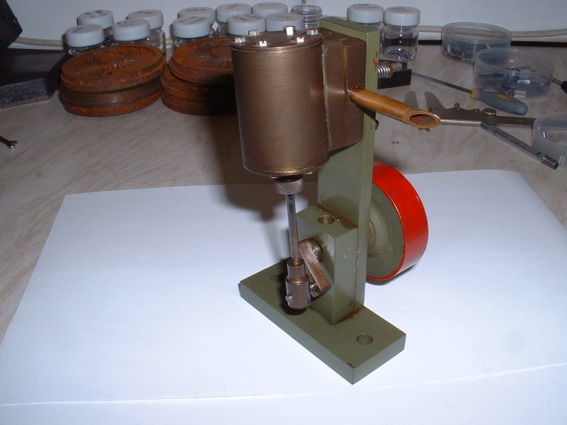

              twin wobbler h.jpgvert.jpgmy first attempts made from whatever was in the scrap bin last year.

                John, how well does that coffee machine work as a steam supply ? I'm needing something similar for my small efforts till I can get my head around making a simple boiler.

                    Great little engines John, nothing like seeing something you have made whiz round to get you hooked.
                    I started with a cappuccino machine as well, until the domestic authorities caught me in the act. I have the 'boiler' from one set aside waiting for me to figure out how to make a safe enclosure for it.

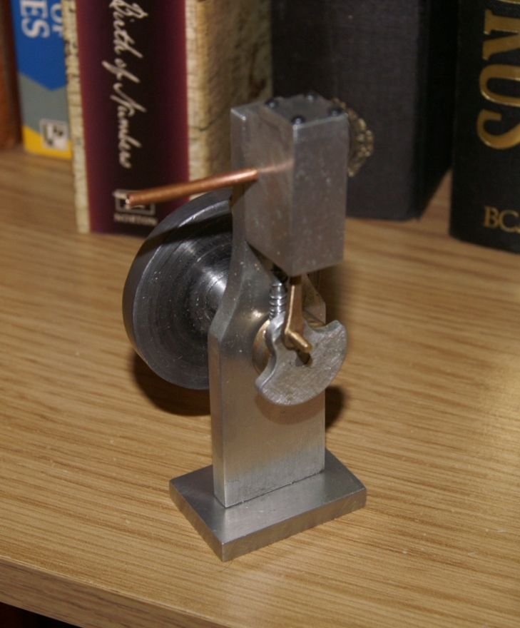

                          My first effort made at school when I was about 15. Double acting oscillator of about 3/4" bore I think. Never did make a boiler for it but it runs on a few psi of air.

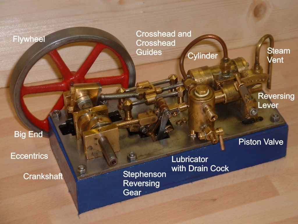

                            Number three was an experiment to help me figure out how Stephenson's valve gear works. I wasn't particularly worried about making it look like a real prototype… it has a smaller flywheel now (original donated to my 'Buxton' engine) but still runs frantically on air or steam:

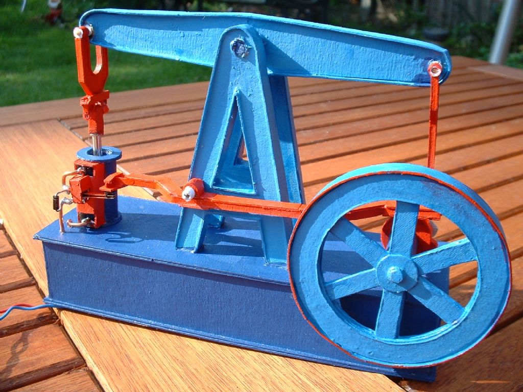

                            This one was a solenoid operated beam engine almost entirely from card, it used to work but the coil got very hot:

                                The coffee machine says the pressure vessel is rated to 15 bar Peter. I haven't put a gauge on it yet. It certainly does make them go for a short time laugh

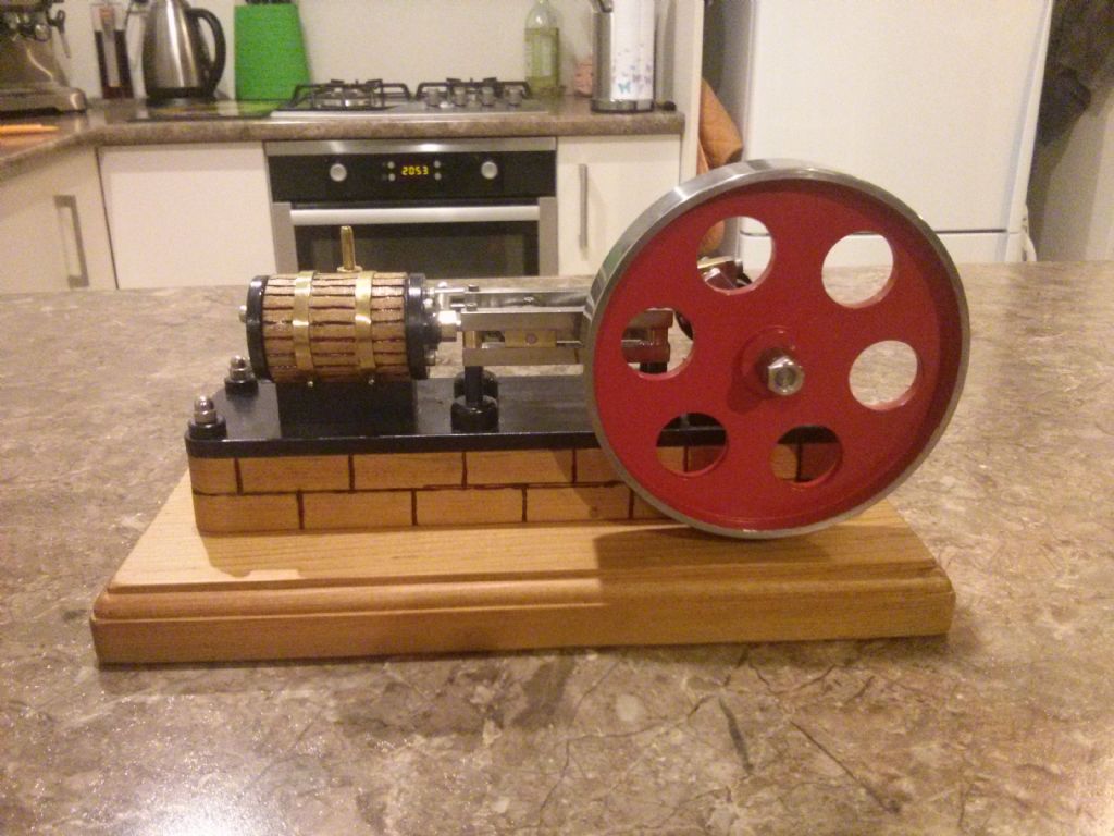

                                  tina.jpgmy first attempt at an engine , age 75 not exebition standard but runs well so I am quite satisfied. Working on a beam engine now

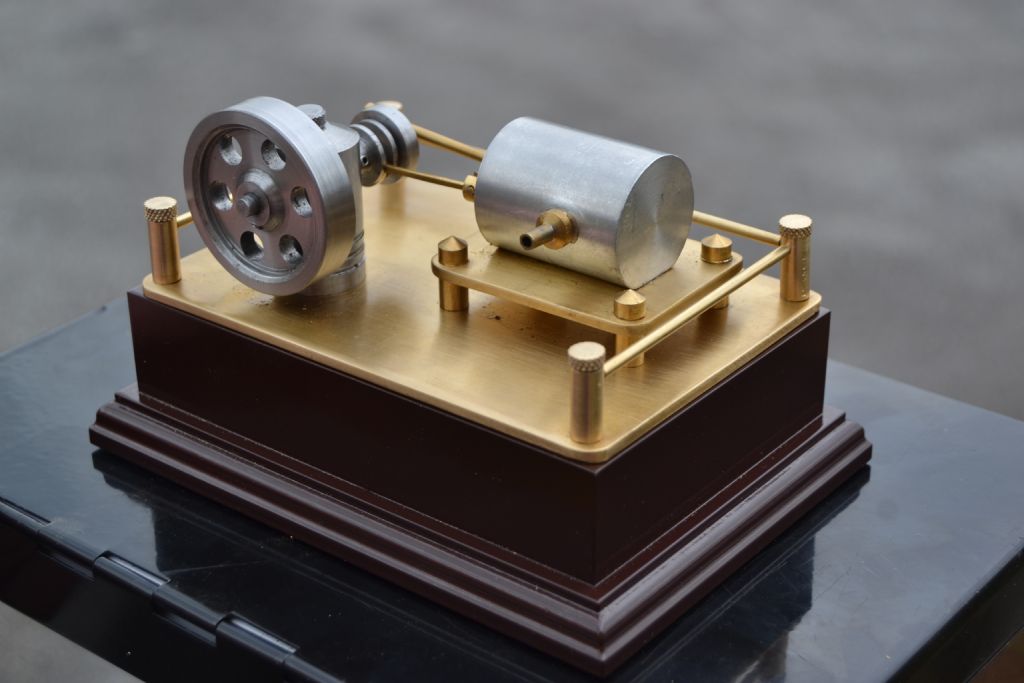

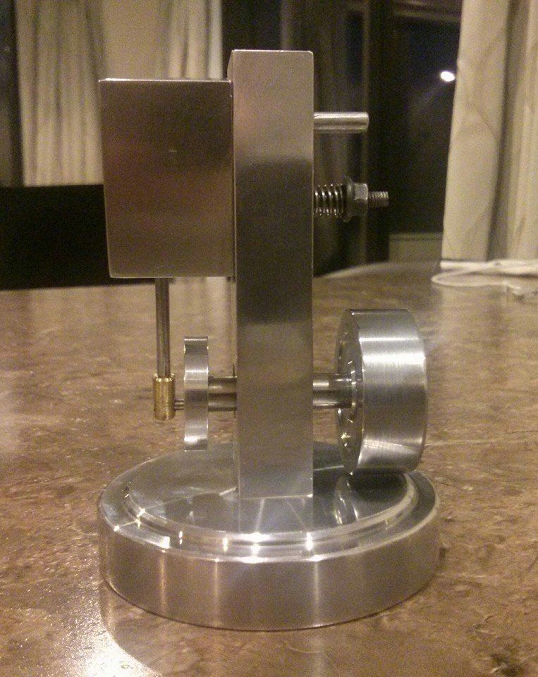

                                    My first attempt with a simple oscillator running on air back in 2014 …
                                    A video of it's first run…
                                    **LINK**
                                    [URL=http://i1136.photobucket.com/albums/n490/mechman48/Running2.mp4][IMG]http://i1136.photobucket.com/albums/n490/mechman48/th_Running2.mp4[/IMG][/URL]
                                    Can't seem to rotate video…?

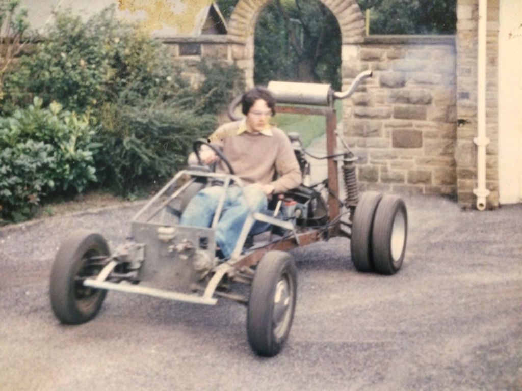

                                                These are the first two models I actually have photos of. Before that, my first vehicle was of wooden construction with a dynamo used as a motor (age 11). The second was a motorised bike using a small 2-stroke lawnmower engine. A policeman told me to stop riding it. I then made this thing with a friend using a Suffolk Punch engine and gears from a Honda C50 that we'd blown up by not rebuilding it correctly. The other vehicle at the bottom had a car engine and 45hp (my first Honda). When I hit 17 I fitted that engine into a car and used it to go to school.
                                                3hp
                                                45hp

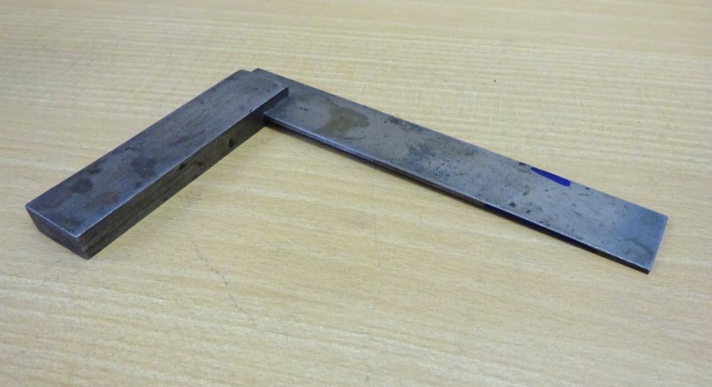

                                                      I do still have the square that I made, rivited together from layers of 1.5x20mm steel, still gets used for rough marking out of things like black bar

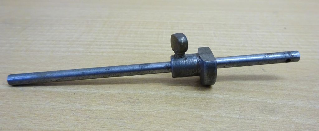

                                                      When I was about 15 Dad bought me a Unimat3 and I made several bits for that, the only one that I could find knocking about in the back of a draw was this marking gauge minus it's pianowire point.

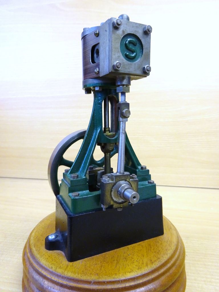

                                                      At about 16 or 17 I made a proper engine all on the Unimat 3 in the form of a Stuart 10V, its a bit rough when I look at it closly now but was the best I could manage at the time.
                                                      I dusted it off over the weekend and made a connector for the compressor, does not run as slowly as I would like due to quite a big airloss around the piston rod gland as that has to be left very loose if things are not to bind up. I suppose I should remachine the offending bits now but will probably leave as is.
