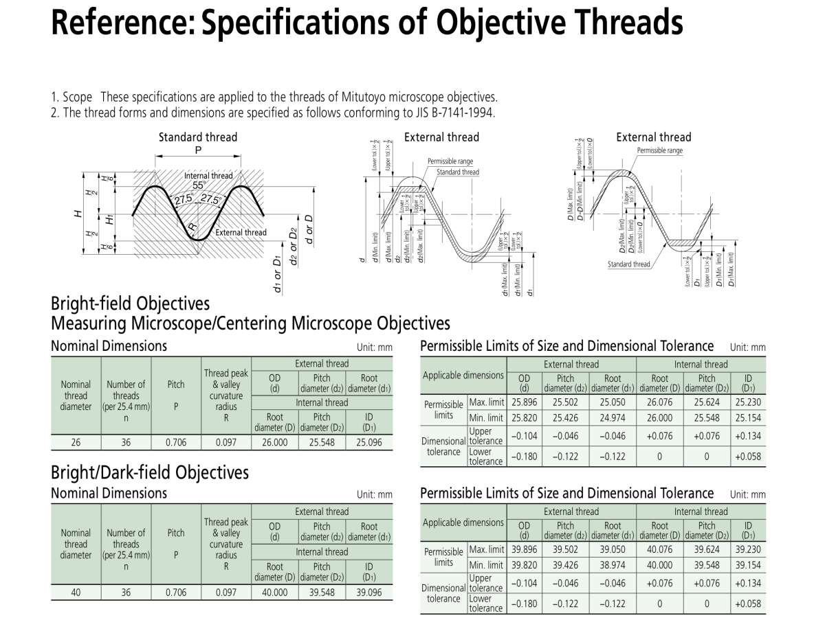

      I don’t want to intrude upon Bill Phinn’s cycle thread discussion … but I would like to share this with fellow microscopists and anyone else with a serious interest in thread-forms and/or  Imperial/Metric approximations.
      https://www.photomacrography.net/forum/viewtopic.php?t=12404
      It should be self-explanatory, so there may be no need for replies or discussion
      … that’s fine by me.
      Edit: __ incidentally, it’s interesting to note that Japanese standards are available at relatively modest prices.
      https://www.standardssupply.com/product/JIS-B-7141-2012/

            Interesting Michael and particularly that Mitutoyo use 55 deg thread form, i wonder what the others use ?
            I suppose on the Mitutoyo thread it is in TPI rather than a metric pitch even though the OD is metric.  The fact that its 55 Deg and maybe the others are 60 deg also adds to the compatibility issue — as for those quoted that do fit and maybe should not I guess the standards are “P” fit  !!
            #760436
              I’m not sure what this forum’s downsizing routine might do … but here [hopefully] is a better grab from the Mitutoyo brochure:
              IMG_0204
              #760456
              Vic
                @vic
                Interesting stuff Michael. It seems strange (to me) to mix metric and TPI on a thread. I also thought nearly all modern threads were 60°.

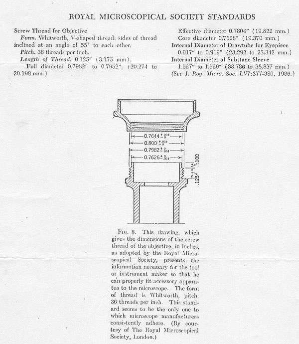

                  I am a little surprised, and rather pleased, that this topic has captured some interest.
                  It is probably therefore worth including this illustration of the ‘baseline’ from which all the more recent objective threads have evolved.
                  IMG_5941
                  [ the best scan of it that I have ever found ^^^ so if you have a better one, do please share it ]
                  As is so often the case, we owe it all to Joseph Whitworth !
                  I have seen an example of the gauges which the Whitworth company made, and the Royal Microscopical Society distributed to the major microscope makers … They are exquisite: and thereby standardisation was immediately triggered.
                  #760475
                  duncan webster 1
                    @duncanwebster1
                    IMG_5941
                    Makes good sense to me to dimension in metric, don’t change the thread so as to ensure backwards compatibility, but dimension in metric so it’s understandable by more than old men in UK and Americans.

                        Just to clarify what prompted me to start this topic
                        Both of the objective threads mentioned are 26mm diameter [which is bigger than the RMS standard]
                        The Mitutoyo is stated to be 0.706mm pitch [nominally 36tpi]
                        the example measured appears to be so, and also of Whitworth form.
                        The Nikons are “commonly believed” to be interchangeable with the Mitutoyo objectives, but the measured example is convincingly shown to be 0.75mm pitch, and appears [to my eye] to have a 60° trapezoidal thread.
                        Such discrepancies would be of no consequence to Messers Harley and Davidson, but they have been known to cause difficulty on microscopes.
                        Clearly it must be possible to manufacture something with a class of fit that ‘accepts’ either … but specifying that could in itself be quite a challenge !

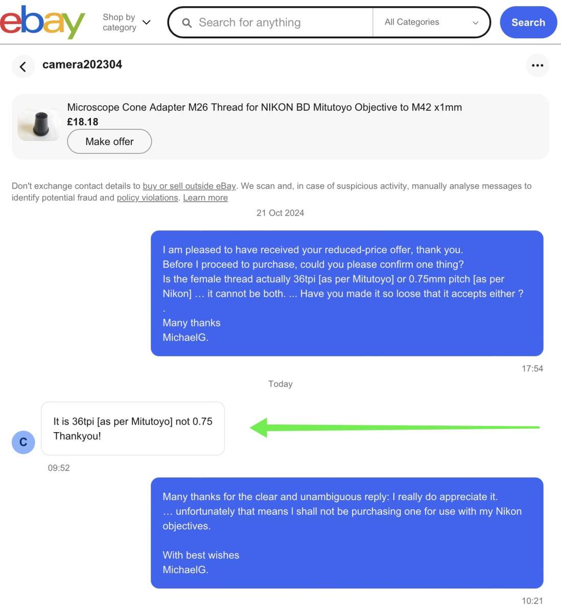

                        Here’s the ebay listing that started me off on this :
                        https://www.ebay.co.uk/itm/394653241414

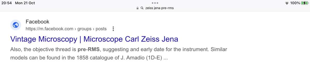

                                    I have just fallen foul of a non standard thread on a Carl Zeiss Jena marking objective, mentioned in the adjacent thread. After getting it working fully, I tried to attach it to the turret of my Olympus BH (standard RMS) and it prooved to be smaller. I cannot judge the thread pitch, but the thread measures 18.97mm, 0.747″. Googling this type of thread, I have been unable to identify it. I will make a short adaptor out of a scrap objective body.
                                    #760531
                                      I don’t do FaceBook … but it appears that my Google Fu is strong tonight
                                      This might get you to the information you need:
                                      IMG_0206
                                      Ref. __
                                      https://www.quekett.org/wp-content/uploads/2018/05/amadio-catalogue-1858.pdf

                                        [ update on the ebay cone ]
                                        Mixed emotions, but ultimately I am delighted to have received a straight answer from the Seller.
                                        IMG_0207

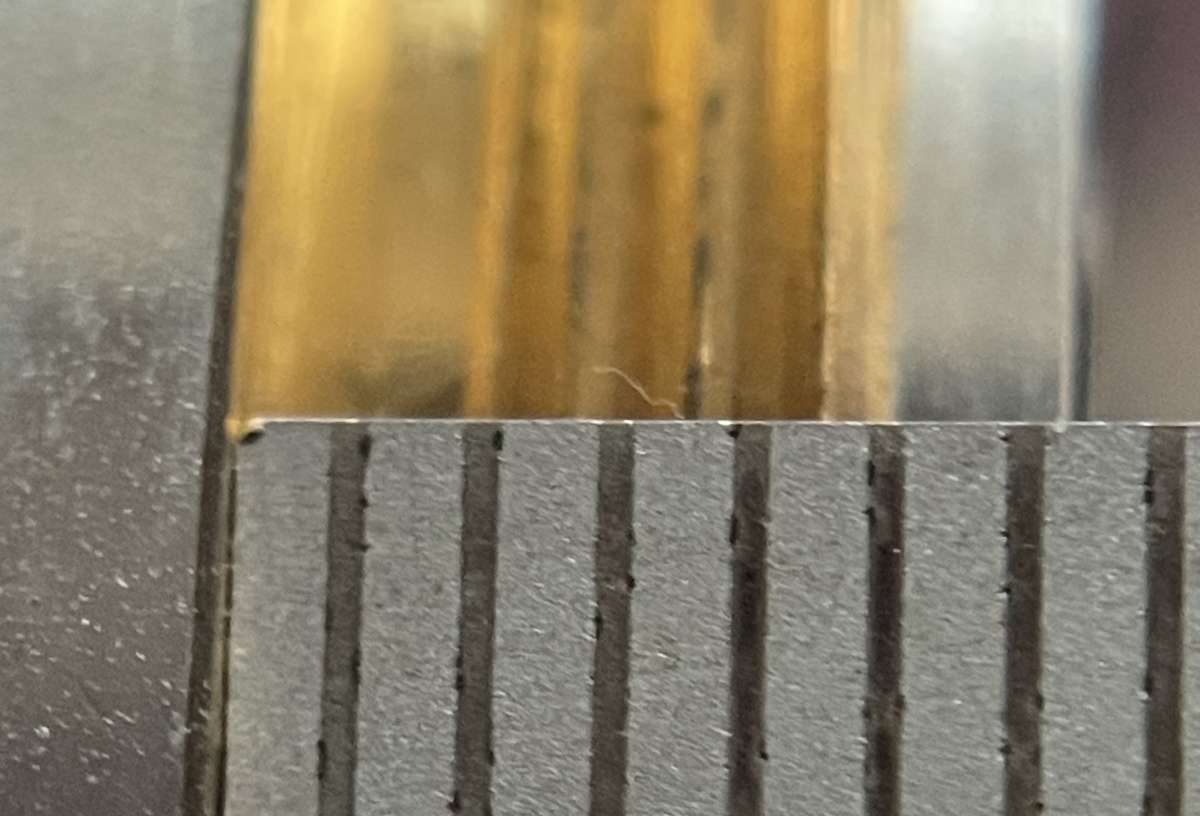

                                        #761102
                                          My Nikon BD Plan objectives having safely arrived from Israel, I can confirm to my own satisfaction that they are NOT threaded 32tpi
                                          IMG_0205
                                          Scale Divisions courtesy of Rabone Chesterman No. 28R
