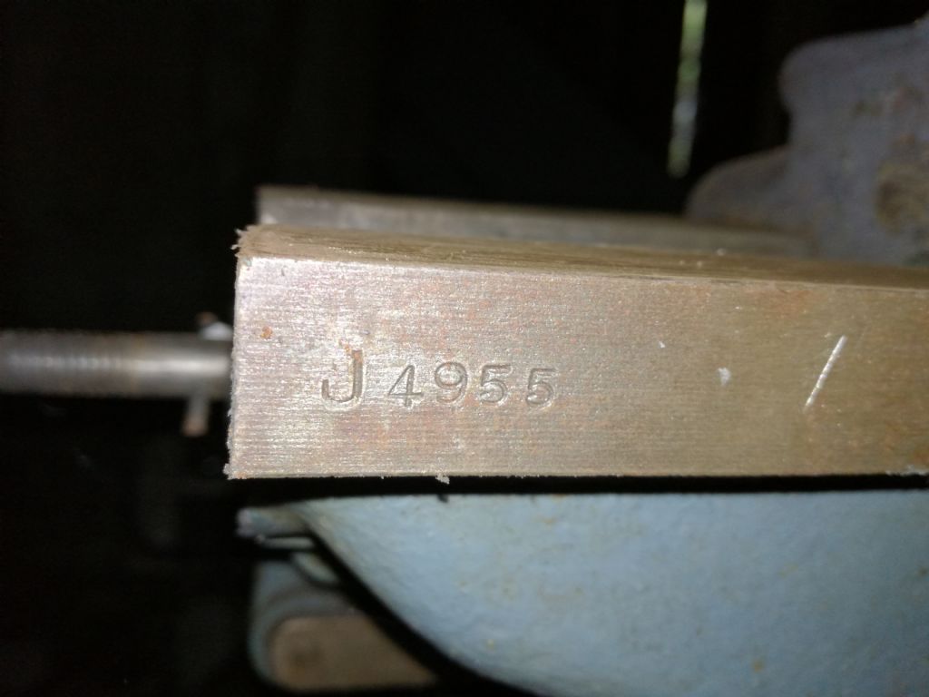

      I am currently refurbishing a M type 3 1/2" long bed lathe, I'm unsure which it is either drummond or myford as the gear guard has a cast myford on it but doesnt have the typical myford on the base. The gear plate is on the guard not the base. If any one can clear up what it actually is brilliant, oh and its stamped at the end of the bed (J3567).

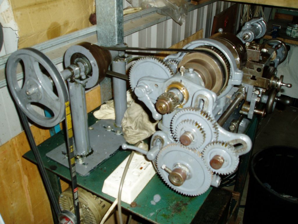

            If space is a consideration ,putting motor on top is working quite well.
            Boxford VFD
            RockFord
            Edited By Niels Abildgaard on 22/04/2019 21:17:11

              Niels picture reminds me that I did a very simple semi overhead set up to put my Pools `Special lathe on that same 18" wide bench. I welded up a very simple rectangular angle iron frame arranged to pivot off the bench immediately behind the foot and central relative to the headstock pulleys. (This was the first application for my stiff, "car heater hose in a tube", vibration reducing pivots which worked very well proving the idea worth making note of.)
              The countershaft ran in simple ball bearing plummer blocks as close tot eh top of the fame as could be managed whilst still providing pulley and belt clearance. The motor hung off the frame on simple pivoted, sheet brackets (more heater hose in tubes) on the bottom side of middle. Position chosen so the weight of the motor helped tension the primary drive belt and pulley that I happened to have about the place. The frame was leant back as far as possible given the need for clearance between belt and backgear. With a simple final drive belt guard fabricated from hardboard the whole thing had a vaguely Myford 7 ish air.
              Clive

                  Here's a pic of how I fitted the motor underslung below the bench on my M-type. I did it to get the motor right away from the swarf zone as it is the type that air is blown right into the windings and armature of the motor and hand become packed solid with swarf over the years.
                  It's easy enough to do, I just hung a flat plate on the undeside side of the bench and bolted the motor to the plate. Plate was pivoted at the front edge on a couple of angle-iron brackets to a pair of angle iron brackets bolted to the lathe bench. A length of threaded rod was attached to the rear of the plate and comes up through a hole drilled in the bench and tension is adjusted with nut, lock nut and flat washer. Motor weight holds the tension on the belt, as far as the nut lets the plate move.
                  The serial number you quote does not sound like M-type with the letter J in it. Not sure there. Lathes.co.uk has full listing of M-type numbers by year in the Drummond section, so you could check that and check their Myford section to see if it matches ML1-4 etc. And post some pics of your lathe here and someone can  probably tell you what you have.
                  Some giveaways of a later Drummond M-type would be the use of V belts on the countershaft and headstock pulleys and the use of steel handles on the carriage traverse and leadscrew handwheels instead of the earlier black animal horn. I don't know that the M-type ever had Myford cast into the bed?
                  Edited By Hopper on 23/04/2019 05:48:15
                  #406122
                  Nicholas Farr
                    @nicholasfarr14254
                    Hi, the letter J is mentioned for the Myford/Drummond M type in this **LINK**.
                    Just had a look at mine and it has a J prefix, but it looks like it may have been added later, maybe this is one of those that were handed over to Myford from Drummond's.
